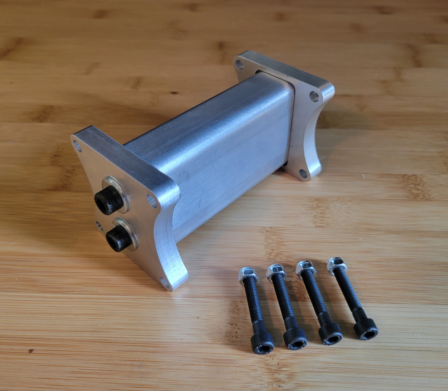

I routinely cut aluminum with my Elite Foreman w/ stiffy bar and get great results. The videos with the flex would lead you to believe it wouldn’t be possible, but I think they are a bit misleading.
I’m sure the accuracy and material removal rates isn’t as high as purpose built industrial machines, but the accuracy and finish of the parts I create are still excellent.
I use high quality cutters up to 0.25”. Adding a mist coolant greatly helps surface finish and cut quality.

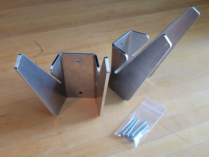

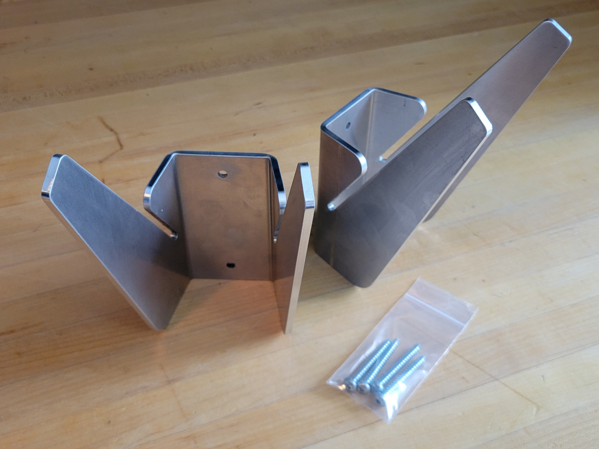

Do you do your own post machining press brake work or send it out to be done?
Bending is done in-house.
I recently moved the press from the garage to the basement, where I can bend parts as they come off the machine.

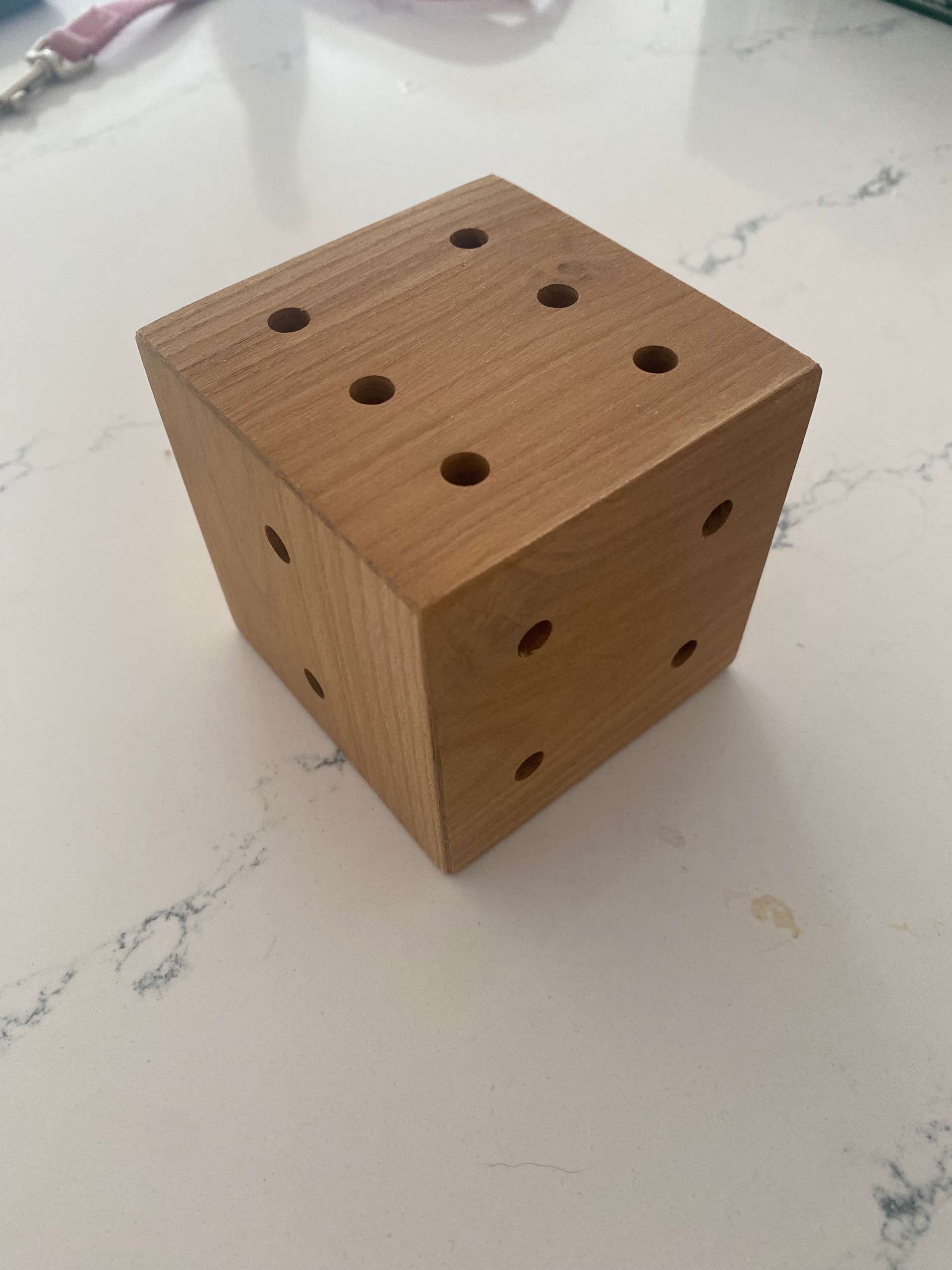

One of my first projects to check for accuracy was this cube. I think it’s pretty accurate
