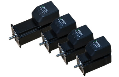

  • Powerful 2 Nm “anti-skip,” closed loop stepper motors

The Gen-2 comes standard with a 600 watt power supply and 2 Nm closed loop stepper motors giving you more available torque and allowing you to rip through carves at faster speeds.

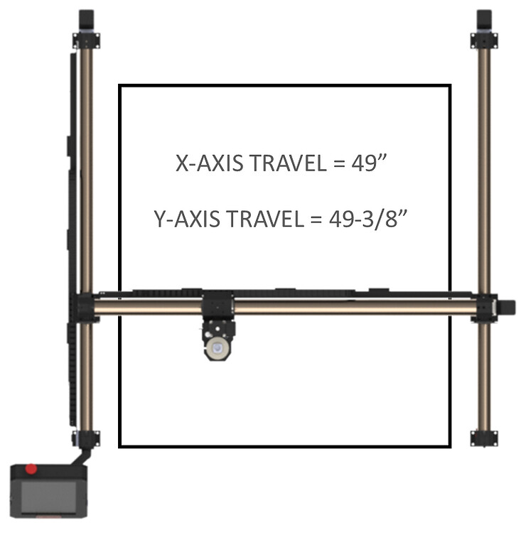

LARGER CUTTING AREA, LARGE GANTRY CLEARANCE
The Onefinity Elite Gen-2 series features a cutting area of 49” along the X-Axis and 49-3/8” along the Y-Axis.

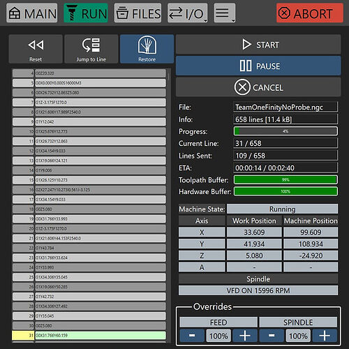

The Onefinity REDLINE controller with a massive 15” LED HMI (human machine interface) touch screen, is a powerful stand-alone CNC controller with fully integrated hardware and software. With the REDLINE controller you can enjoy all the features and perks of a powerful PC-less controller at the touch of your fingertips.
With ports to easily connect an EASY ATC, Tool Setter, XYZ Probe, laser, 4th axis and full support for the REDLINE spindle, all with direct on screen controls making the REDLINE Controller the most advanced CNC controller we’ve ever tested and it’s available for an incredible, unmatched price.
The Onefinity REDLINE controller also supports standard joypads and a rotary attachment!
ADVANCED REDLINE CONTROLLER Features:
  • Great wire management—Only 2 cables running to touch screen
  • Fully 3D (no wire frame) tool path display so you can see your carve in real time
  • No USB disconnects. Files download to the controller ensure a smooth, successful carve
  • Automatic G-Code scan. Determine issues prior to run (e.g. limit extents/invalid commands)
  • Preloaded bit diameters to save time while probing. No typing necessary.
  • Plug and play joypad for quick and easy jogging
  • Increase or decrease spindle speed while running
  • Ability to save coordinates
  • Simple, easy-to-use screen layout
  • Expandible Wi-Fi
  • Jog while paused
  • Power loss recovery and jump to line
  • Continuous and incremental jogging via touch screen
  • Feed rate override - Adjust feed rate during a carve
  • Multiple work offsets (G54-G59)
  • And much more…
Power Loss Recovery. Jump To Line.
Dramatically reduce the chance of a lost or damaged carve. The Onefinity REDLINE controller has built in power loss recovery. If you lose power during a carve, the controller will give you the option to resume the carve upon power recovery at the very spot it last carved. This can save you hours of time and hundreds of dollars worth of materials.
The jump to line feature allows you to skip to any point in a carve at any time. If you are running a long carve and need to step out of the shop, you can stop the carve, turn off the machine, and start it the next day from where you left off.
