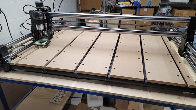

I did go ahead and rotate the table as I discussed above. So now I can feed a full or half sheet of plywood through if I needed to. I doubt it would happen often (if ever), but I am setup for it now.
I got the MDF for my QCW waste board cut and installed yesterday. I made the counterbores .625" (5/8") which is more than large enough for the washers shipped with the QCW frame.

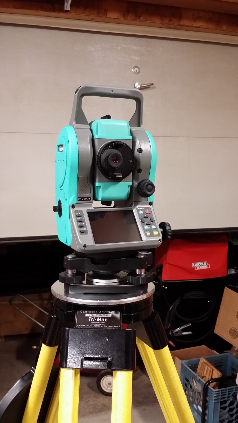

You may have your QCW frame and leveling feet by now, but for others I will say get the leveling feet so you can level the frame precisely.
I leveled my Kreg table to within 1/32" (.031"). Then assembled the QCW frame on top of that and used my Nikon Total Station to adjust the leveling feet and bring all four corners within 0.010". From there leveling the wasteboard surface should be easy.
I wish the leveling feet had half-height lock nuts or there was a grub screw you could tighten to lock the foot adjustment in once you have it dialed in. If you slide the whole machine around on your table top you could inadvertently rotate one or more feet and given the coarse thread (I’m guessing the screws are 1/2"-13 thread) on the leveling feet a quarter turn is probably ~0.15".

I’ve had my machine setup for a couple days now. Made a few test cuts and now it’s time to flatten the spoilboard and get the whole machine dialed in as best I can.
I wanted to have an idea where I was starting at so I stuck a digital indicator in the collet and zeroed it out at 0,0 then zeroed Z with the indicator in the middle of its travel. The indicator is direct reading to 0.01mm
I took 9 readings spaced around the board. I know given the board is 48 x 32 inches there are big gaps between those 9 readings, I just wanted to get an idea of how bad it is to start. The greatest difference of 0.22mm (0.0086") seems pretty good to me. I am thinking that once I verify the spindle is perpendicular to the table I can surface the spoilboard. Or do I need to surface it first. Seems like a chicken/egg situation to me.
Can’t make the surface flat with a spindle out of plumb and can’t get the spoilboard truly flat with a spindle that is not cutting flat. I have a 1.5 inch spoilboard bit.
Which should be done first and does it need to be repeated after the second step.
Or should I not even mess with the MDF in the QCW and lay another slab of MDF on top and flatten that.
