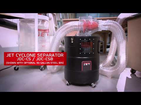

For dust collection I’m looking at using the HF 1HP 650CFM dust
collector with a Jet cyclonic separator on a 30 gallon barrel up front
to catch the big stuff.
Anyone use one of these type separators and if so what do you think of it?
https://www.jettools.com/us/en/p/jet-cyclone-separator/717600

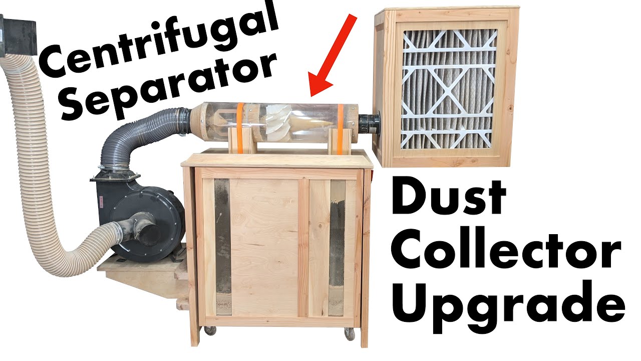

I thought the Jet version was better than rolling my own as Under Dunn tried. ![]()
WOW! It is a clear variation on the venerable Dust Deputy XL. One upside is that you can pull up a chair and watch the dust go by while you pretend to not hear the increasingly annoyed/urgent calls to dinner. The downside is that you’ll go broke buying flowers to go with your apologies for not hearing the call to dinner.
I bit the bullet and bought a whole shop unit from Harvey tools. The Gyro Aire 700. It is similar to the Binford 5000 dust management system - just not blue. It is “only” a 2hp unit, but it handles the chores in an entirely different manner than a standard dust collector. Those two horses will suck your eyeballs out of your head if you get a single hose too close to your face while the unit is running. When you get to four gates open it calms down enough to vacuum the leftovers out of your beard and leave it nicely fluffed so you can go on being the chick magnet you were born to be. It also prints its own “Wanted” posters for dust particles. In color! It does its work quietly. It cost something more up front, by my days of second-guessing and trying and failing with modest solutions that actually add up to $$$ when all the experimentation is done, are over. When introduced, it went for $4000. Since Harvey bought out the inventor and manufacturing has shifted to China, it goes for $2100-$2200 depending on the special being run. 220 volts and 400+ pounds. You’ve been warned.
Say - Under Dunn’s project appears to be a homemade version of the Gyro Aire 700.
Bottom line (literally) is that Dust Deputies work well when used with a reasonably powered shop vac and even better when paired with a “real” dust collector.

Yes, Under Dunn’s project was a copy of the Harvey Gyro Air 700, he said as much so no surprise there. He even recommended that you NOT try building one because it was a PITA and took too much time and was not as good as the Harvey.

I don’t think the Jet cyclonic separator is a variation of the Dust Deputy XL. I am not aware of any DD that has an internal configuration like the Jet or the Harvey. But I have not peeked inside a DD XL so I can’t say for sure. Apparently you can so you’re saying the DD XL looks like the Jet inside that opaque exterior?
Bottom line for me is for this application I want something that is quiet, not a screaming banshee that is a wet/dry vac. I want something that has higher volume (CFM not static pressure) than a wet/dry vac can create. And I want something with connections for larger hose than a wet/dry vac. And last but not least I want something with better filtration that can be had with a wet/dry vac. I know about Festool HEPA dust extractors and the like. I’ve had a Festool CT-36 and a CT-SYS for years. I know what they are capable of and I could use them but they are dedicated to other tools in different locations.
And with the Harvey no longer made in the USA it has reduced attraction to me.
Well, yes and no. No x-ray vision here but I have seen a cutaway of the Oneida system. The similarity between the Oneida and Jet products is in concept - not design. They each separate the course from the fine through cyclonic action. The way each accomplishes its task is different from the other.
I see the Dust Deputy as tried and true. The XL, with 4" ports and an included barrel is pretty much the same cost as the Jet separator without the barrel. For me, the Oneida removes things from the realm of the experimental to “job done.” And Oneida is USA based. No doubt the Jet will work just fine, just as most of their tools do. If you do go with the Jet, I hope you’ll let us know how it goes - and maybe post a video to YouTube so we can see it in action.

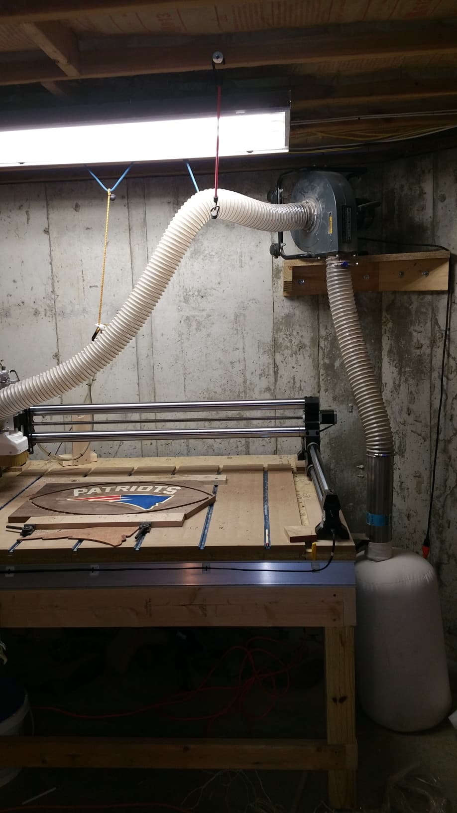

With my setup I can’t run a dust deputy but haven’t found it’s needed. At least for what I do. Using an app for my phone I measured the DB level from about 3 feet away, 72 db, for the HF 1hp dust collector in my set up. Just for reference I measured my Rigid shop vac (the largest size they sell) at the same distance and the app said 87 db. I’ve really been dragging my feet but the bag for the DC is going to be replaced with a pleated filter that has a plastic bag for the chips and dust.
I’ve saw some pretty negative reviews about the Jet when I was trying to decide which separator to buy. Enough so that it steered me away from the Jet and towards the Dust Deputy products. No first hand experience but I’d definitely do some research before you decide on the Jet.
