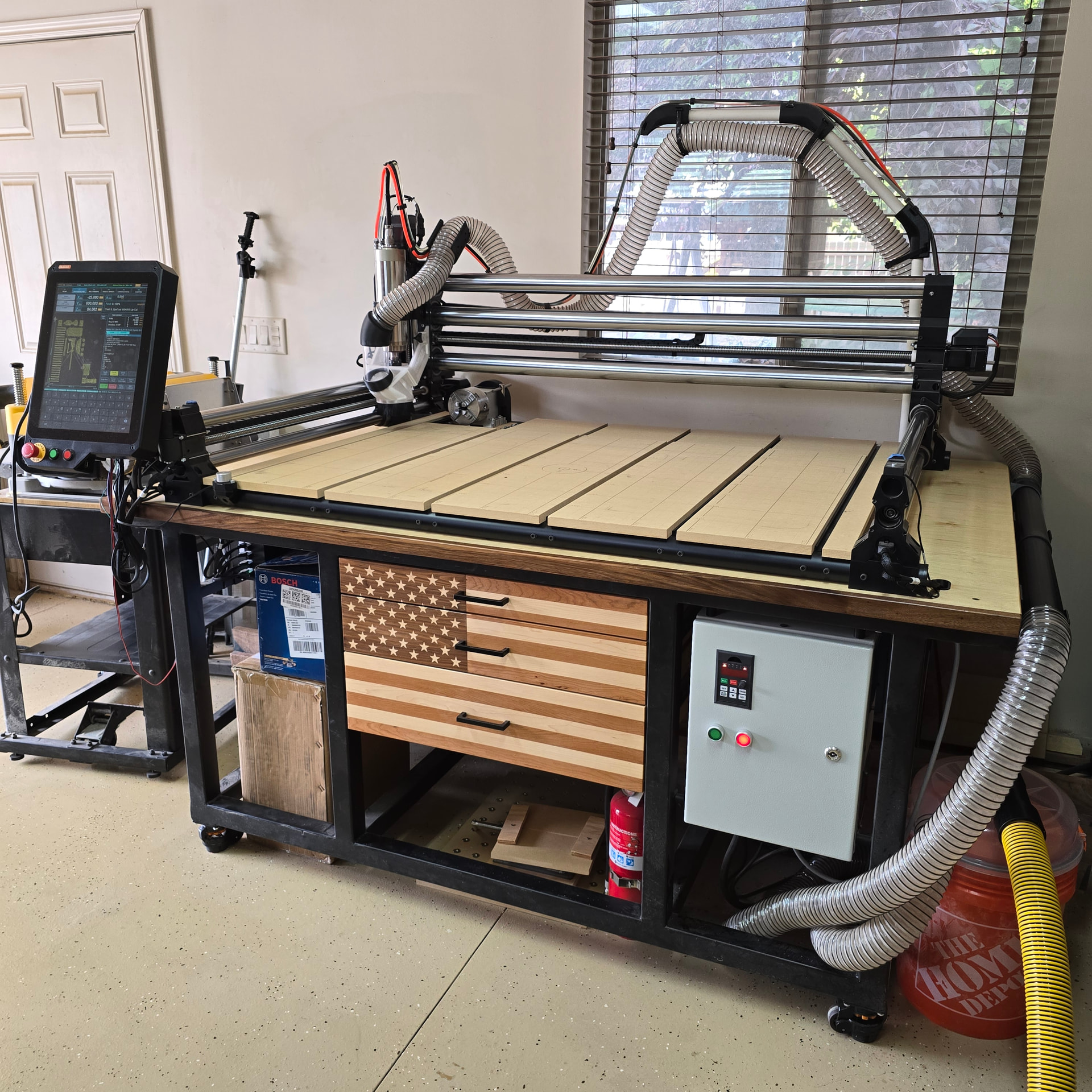

4th Axis
Just an Amazon special CNCTOPBAOS, hooked up with the old spare Masso Z motor that got replaced by the braking Z stepper. It was a quick conversion. Custom 3D printed belt cover to keep dust out.
Not totally sold on the placement in the back left corner. It doesn’t collide with the X-carriage, but it can collide with the spindle and dust boot. It also doesn’t give me a huge diameter to work with, even if I remove the left spoilboard slat. Luckily chess pieces are small, and that’s kinda all I wanna do.
First test on the 4th axis (using Autodesk Fusion 3+1 milling, 4th axis configured as my G59 offset):
Spoilboard
Spoilboard grid isn’t a new addition, but I don’t think I’ve shown it off before. Major gridlines every 100mm, minor every 25. V-groove numbers on the major. CNC center marked at (610, 408):
What do you all recommend for hold downs and datums? I’m thinking of adding dog holes, but that’s a major commitment and I just don’t think I’m emotionally ready.
Dust Collection
For dust collection, I’m still rocking the Hermes dust boot (shameless self-promotion), but I’ve upgraded my vacuum from a Ridgid banshee to the Dewalt Stealthsonic. Got it for $75 on a Costco special. It is remarkably quiet, but it also gets remarkably hot on long carves, so we’ll see how long she holds up.
The Stealthsonic came with two extension wands, which let me create my favorite addition to the setup, a removable inline, long-reach cleanup wand. While the CNC is running and the wand is stored, there’s suction at the boot. When it stops I can just remove the wand and clean up the table. It is ecstasy.

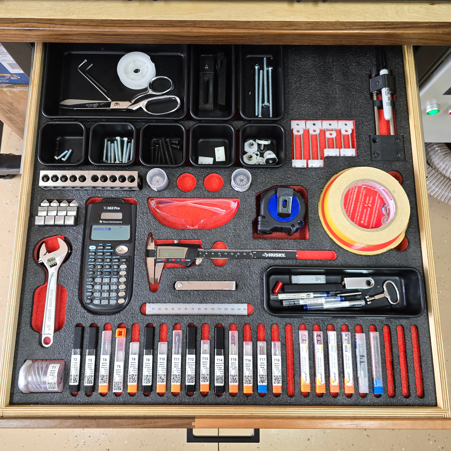

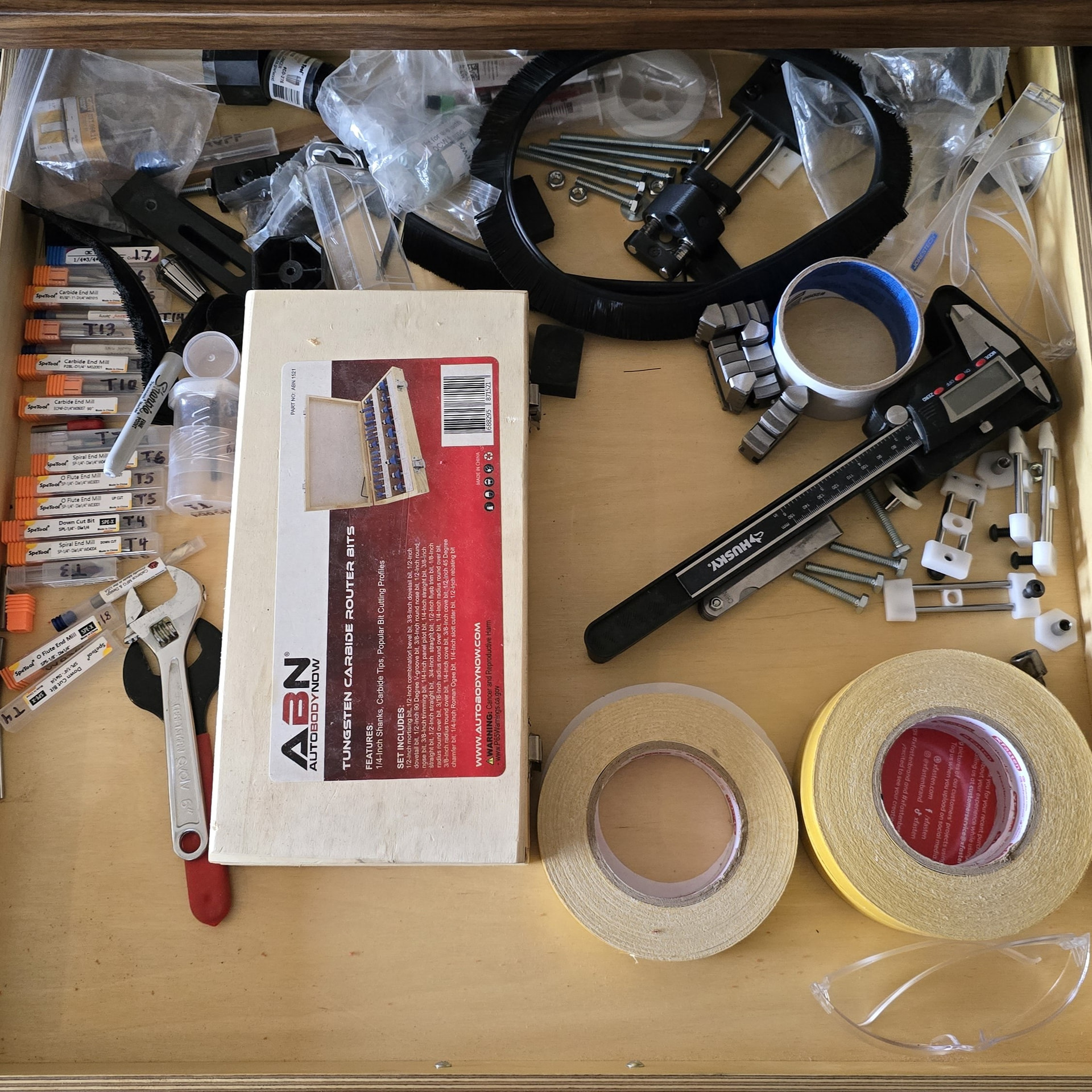

Organization
Finally organized my top drawer with some Kaizen foam. It was about dang time.
Put some QR codes on my endmills for easy reordering. But now I want to create a full Manufacturing Execution System.

Updated my CAD model with the changes. Also updated my post processor as well to work with the 4th axis. This way I can simulate CAM toolpaths with the machine model and be confident that it won’t crash.

Would you be willing to share that file for the belt cover on the rotary? I have that exact model but mine is mounted in the front right corner so some protection would be nice.
File attached! It’s got storage for your chuck key. I will admit, printability ain’t great. It requires supports. Make sure you’ve got it mirrored the right way, I flipped the motor mount plate on mine.
And just double check before printing, this is the 4th axis I have: CNCTOPBAOS K12-100mm CNC Router Milling Machine Rotational Axis A 4th Axis Rotary Table 100mm 4 Jaw Chuck Dividing Head,MT2 65mm Tailstock Reducing Ratio 6:1 for CNC Engraving Machine - Amazon.com
4th Axis Cover.stl (237.7 KB)
Thank you! Printing now, will see how it goes.

Looks like your belt is slightly shorter so my motor is mounted just far enough away it rubs :frowning:
