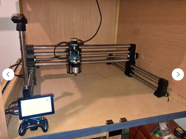

So happy to have finally pulled the trigger on this one! I’ve been watching CNC videos for years now, and it feels like I’ve been waiting forever for the right deal to show up. This one was originally purchased back at the beginning of Covid, and from the seller’s description, hasn’t been run much at all. As I plan to build its permanent position in the shop, I’m wondering what aftermarket upgrades are recommended. I’m aware of the 4" vac hose upgrade at pwncnc, but that’s about it.

Your table looks very nice. Make sure you can get to all the bits and pieces for cleaning. Other than that, have fun. You’l figure out and learn as you go what actually works in practice vs what you learn on line and from others. No two setup and needs are the same. If it was easy everyone would do it, right?

This is the same machine I started with and purchased it used. You will want a spindle some day in the future but maybe wait until router wears out. I went with the Redline spindle sold by Onefinity so they would support it but either works great. I don’t see a spoil board in picture. You should search Youtube for the GOAT spoil board system and make as your first step. It has all the different methods of hold down built into it. Allot of processes are used so good learning project as well. Only other thing I can think of is replacing that small screen with something bigger. Many including me has had trouble with the screen and had to replace it. So might as well go with something bigger.

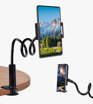

I didn’t like the little magnetic holder for the monitor, so I got a flexible table/monitor stand. Do NOT get one of the goose-neck types.
I did and it bounced around a lot and eventually snapped of the base.

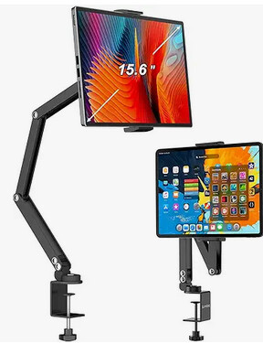

I’d suggest something like this:

ssamborn…the touch probe was the only thing I didn’t get in the picture. It came with a nice XYZ probe so that hundred bucks stays in my pocket!
