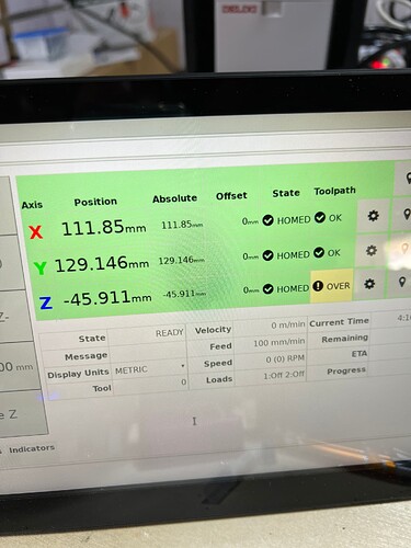

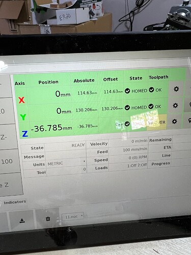

So I was experimenting again tonight. I’m not sure why but the machine was switching from metric to imperial during the carve. I did find that if it had switched to imperial without me noticing I couldn’t use the g0 code to move to my zero point. If I rehomed, it re-set to metric then I was able to make it move.

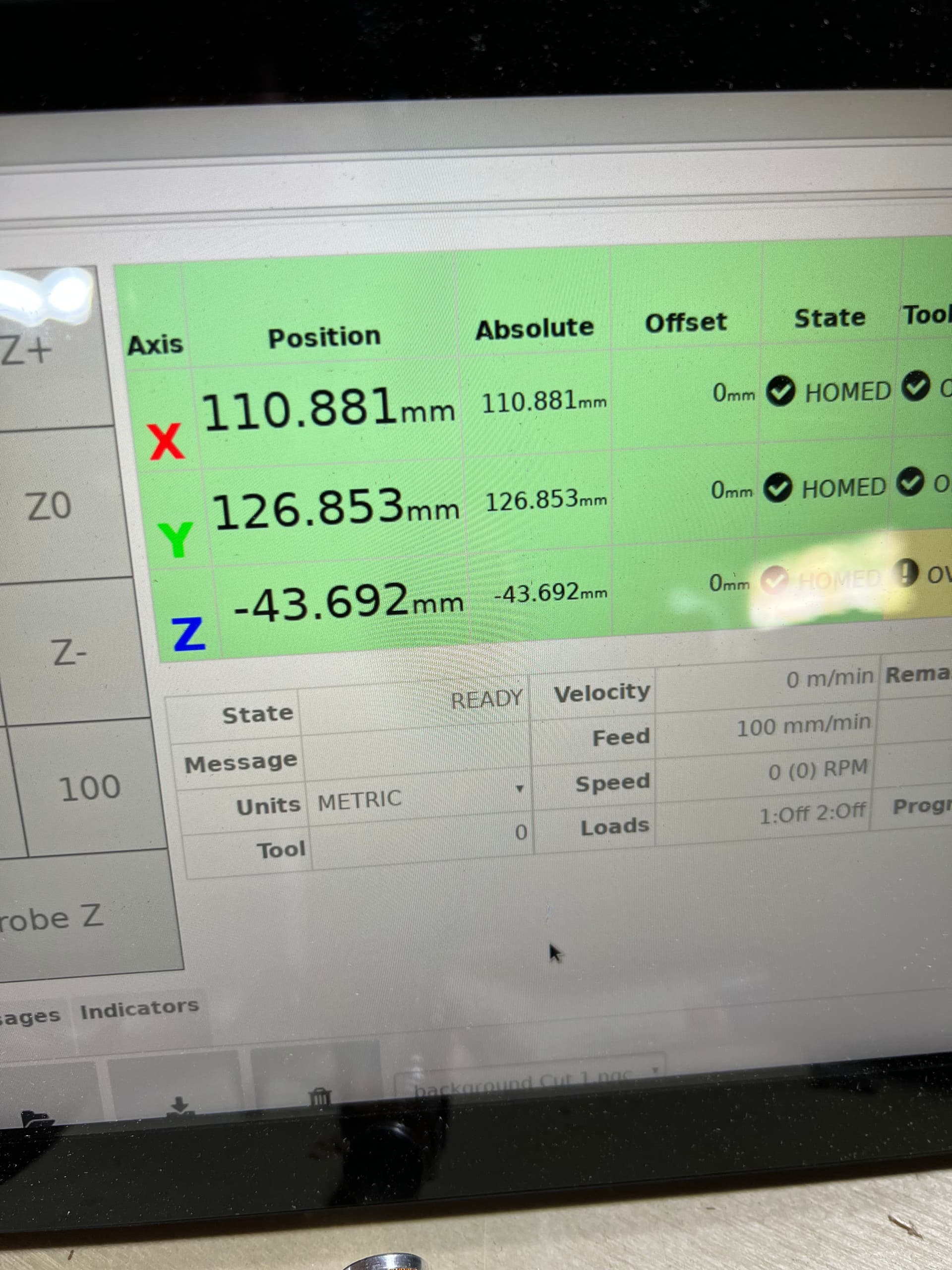

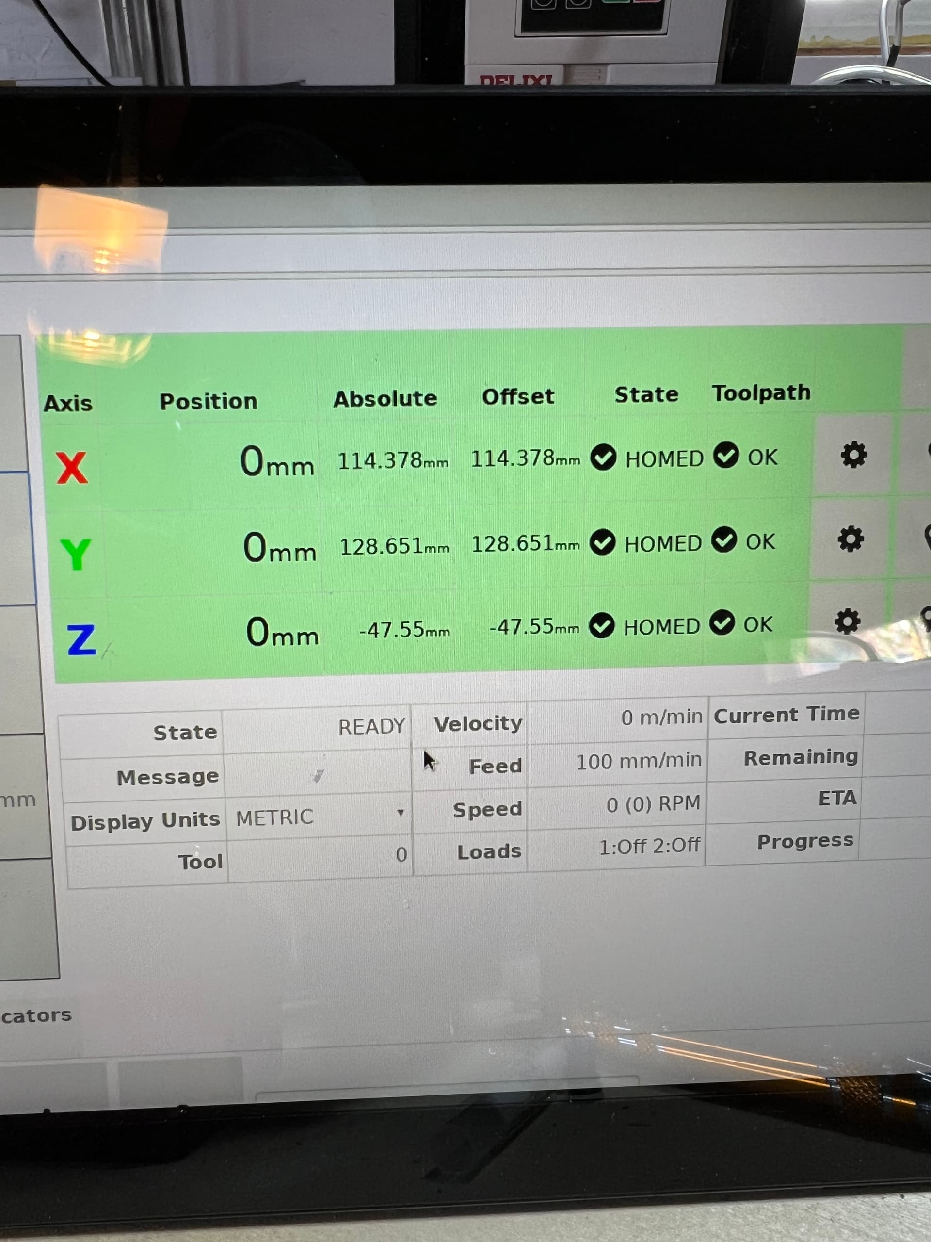

Unfortunately, another issue cropped up. I was finally able to get the machine to move with the g0 code but it wouldn’t go back to my 0,0 point. Below are pics of the x0,y0 that I set, then rehomed, the used MDI to go to the x,y that I had from the start. The problem is that it wouldn’t go to the correct home. The coordinates were correct on the screen but the true home (as in the home on my work piece) was 4mm away in both directions. I thought it might be a fluke so I tried again and same result.[

just by the photos, I can not follow what you did and therefore can not tell what the problem or the solution is. Also your description is not easily understandable. Could you please provide a step-by-step description of what you did (with numbers and actions you did) and what happened as a result, step by step. I need to be able to reproduce it here.
Can you also first say what the exact intention is of what you wanted to achieve.

After turning on the machine and homing it, I find x0,y0 on my work piece(bottom left corner). I save those coordinates and rehome it(as if there was a power outage and I had to restart the machine). I enter the coordinates I saved in the midi tab using the g0 command. Assuming it didn’t switch over to imperial without me noticing, the machine will move the bit to the coordinates I just put in but they are not at the corner of my workpiece where I set them. I then move the bit back to the actual x0,yo (the corner of the workpiece in this case) and find that the machine made an error of 3-4mm. In other words, after all that it puts the bit in a spot that is 3-4mm off from the actual xo,yo that I set in the beginning.
Does that make more sense?

It appears you are homing and then using the MDI to type in the offsets you took a picture of when you first setup your work. ( Correct me if that is not what you are doing )
Homing the machine does not put it back to the same exact place all the time. 3-4mm seems more than i would have expected - i have seen 1-2mm on my machine. In other words every time I home it could be 1-2mm off of where it was when i homed when I setup my work. For you it may be 3-4mm it depends on several factors on your machine. That is why I use a secondary block to reference my work to - not home - as I described several posts above.

Dave, That is the limitations of stall homing. I am sure you have seen that when the axis hit the stops when homing they jump back after they hit. The home is set to 0 after that jump back occurs. That jump back is one thing that is not consistent. Another thing is junk buildup between the axis blocks and the stop blocks. This is what I have observed, I am sure other will clarify if I am wrong on some points.

what @ChrisM suggested above, is to clamp a block somewhere on your workarea, that can be left permanently there, away from your work, and to use the touch probe on this block in order to substitute homing with a more reliable method. Unlike when using stall homing, this block never moves and repeatability should be excellent.
Regarding problems when using the touch probe, you should be able to eliminate them by taking care to clean the bit and the inside of the collet before probing so the electrical connection is of good quality, or if errors come from the flutes, even better use the shank of a bit that you inserted the other way around into the collet as the probe to probe X and Y (and use the real bit only to probe Z).
If you had such problems there could also have been a problem with the probe wire. I would not give up that fast, since when everything is in order, the Touch probe brings excellent results.
