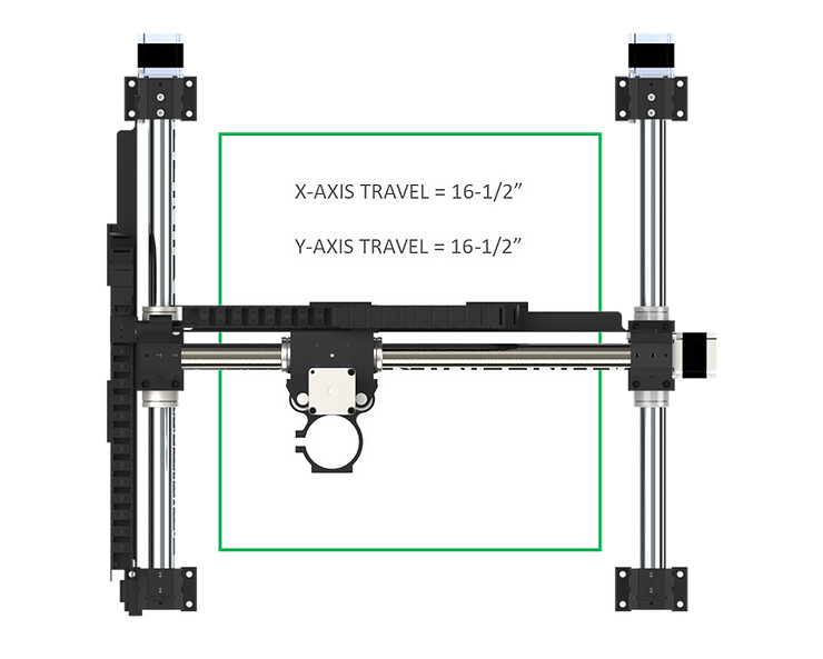

CUTTING AREA.
The Apprentice features a cutting area of 16-1/2”” along the X-Axis and 16-1/2” along the Y-Axis.

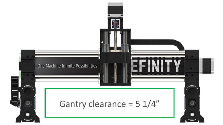

LARGE GANTRY CLEARANCE.
With 5-1/4” of gantry clearance, The Apprentice has the highest gantry clearance in its class. Having more gantry clearance is useful when you need to use fixtures or jigs to hold your parts or when you want to use thicker material.

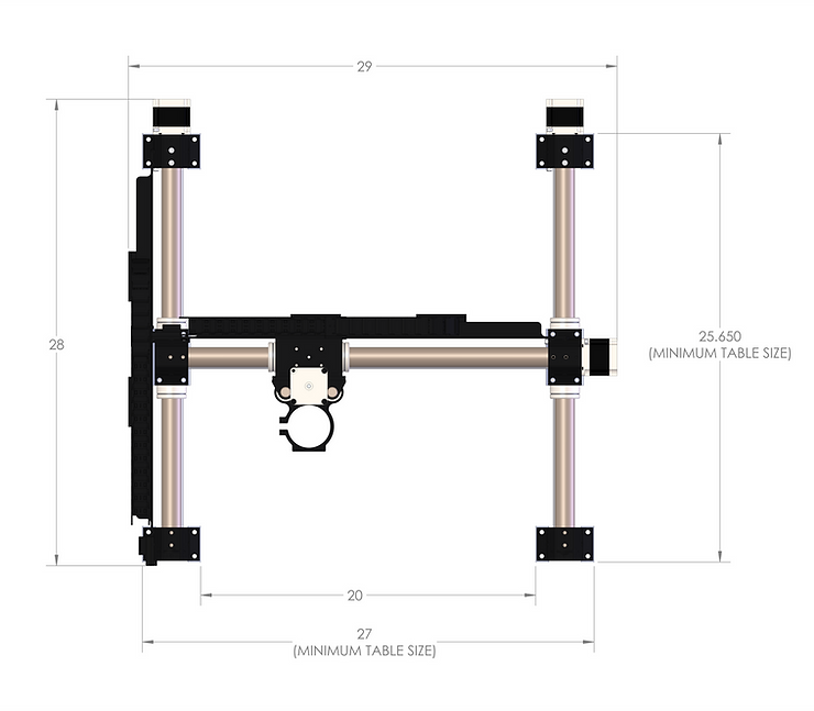

DIMENSIONS.
Below are the external dimensions of the Apprentice. These dimensions will help you build a base and/or select an appropriate table. You can also use the shown dimensions to create a waste board.
