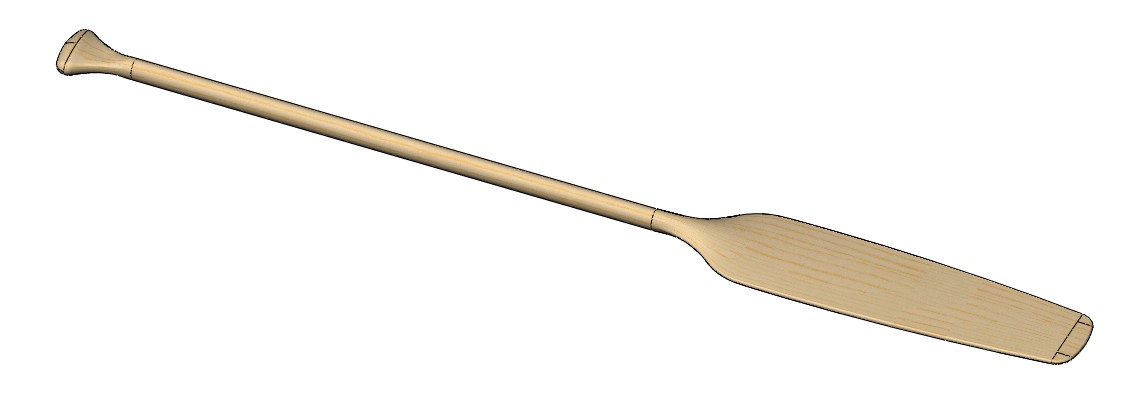

I’ve always wanted to make a paddle. I figured it would be a great tiling exercise, but when I realized that it would fit diagonally on a 4’ x 4’ bed, I couldn’t help but give this project a go immediately.
I designed the paddle based on the shape of one I already had and loved, but added some slight changes I always wished this paddle had.
I have some, but not much experience doing full 3D surfacing on a large part like this. As with most things, once I got through it I sat back and said “well… that’s wasn’t really that hard.”
Went to my local wood dealer and bought a board of Cherry for the project. I considered laminated several woods to make those fancy multi-material paddles, but thought I better keep it simple for this first one. Also, I thought it would be even more painful if I messed it up and lost all that work laminating the pieces together.
I’ve been programming and CNC machining my whole adult life, and this was enormously satisfying to see the paddle take shape. Especially when the ball nose cut the complex surfaces. Total runtime was about 2 hours. I was pretty conservative with my feeds and speeds.
