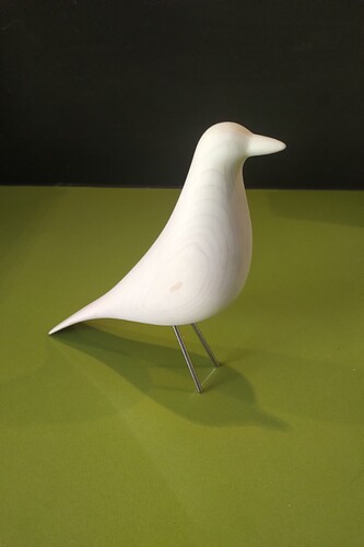

There are many files on the Internet inspired by the Eames House Bird, but for me the challenge was to find a mesh model that had the highest poly count that did not crash F360 or overwork my mobile workstation. After that it was a matter of making a few changes until I had a model body I was happy with. I am limited to some degree in the tooling I can use with my ISO20 ER16 and ER20 holders and collets, so I scaled the model down to a size that allowed me to use regular length tooling with conservative stick out. The approximate stock size ended up being 200mmx100mmx50mm.
Here is a photo of the model with tabs I added to secure it during machining:

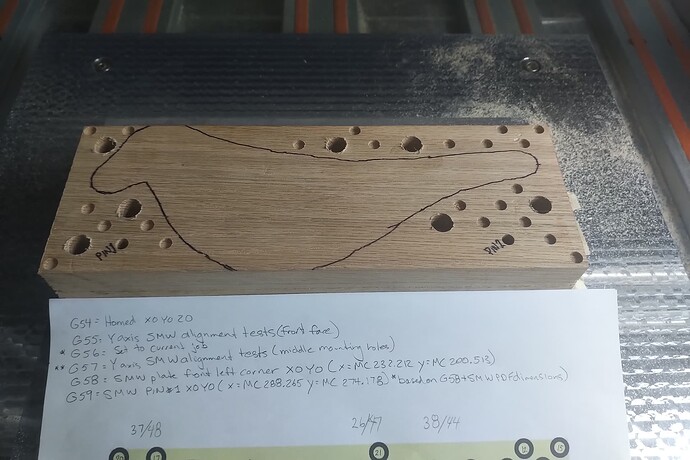

In order to accomplish the two sided machining, I used a locating pin method. I took advantage my M6 threaded fixture plate and the M6 locating pins I had purchased for it. I modeled the locations for the 2 pins and added them to my design. For machining the second side, the stock would be flipped over 180 degrees along the X axis, nd held in position using the pins - this resulted in a very accurate and repeatable locating method. NOTE: the origin for the top machining setup is the top bottom left of the stock, and changes to the centre of the left hand locating pin for the bottom machining setup.
Here are some photos showing the locating of the stock:
Workholding
My work holding strategy underwent changes from early testing to the final method I decided on. To test the work holding strength and repeatability, I initially used a tape method to hold the stock to a MDF board with holes drilled for the 2 locating pins. As mentioned earlier, I later switched to using 2 M6 locating pins on my aluminum fixture plate. Although the tape worked, I wanted an even more secure method - that also used less tape :grinning: . After a lot of work, I ended up with a method whereby I drilled holes in the corners of the stock for 60mm M6 SHCSs, and these were screwed into the threaded holes in the fixture plate. To accomplish this I learned how to add the hole locations from my fixture plate CAD file to my bird file, and after a lot of trial and error determined the best locations for the 4 screws so they held the stock well during all machining steps but also did not collide with the end mill. It added time and effort but the result was what I wanted.
Here are photos of some of the earlier setups:

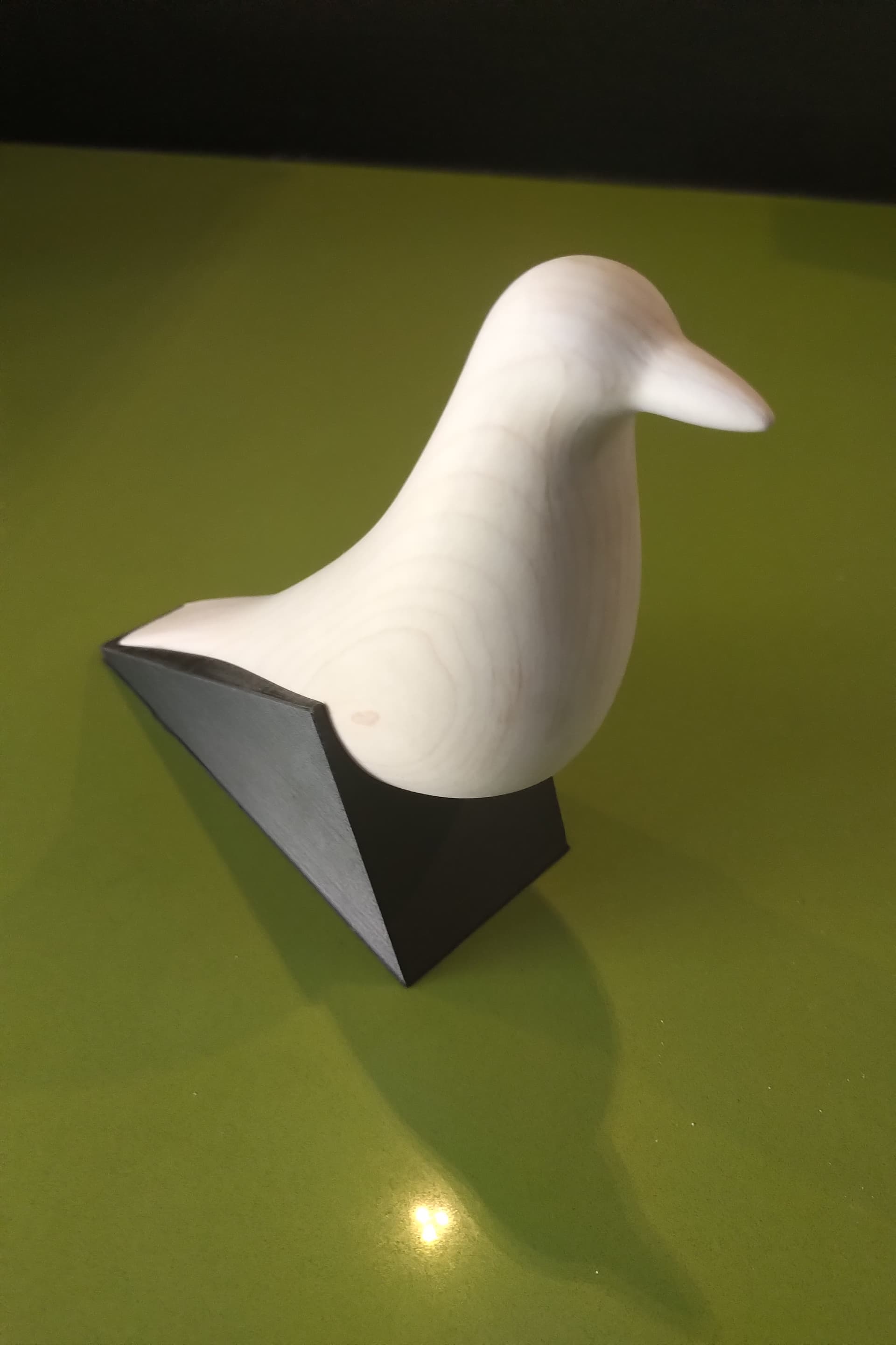

Placing the legs and eyes correctly was a big challenge and required me to further develop my F360 CAD skills. It took some creative problem solving but I was able to model the accurate locations for the legs and eyes, both were a challenge as they were at different angles on a model that was a completely organic shape. My original plan was to model and print a 3D jig that would allow me to drill holes for the eyes and legs. This worked perfectly for the legs - which I make from 1/8" stainless steel stock - but I did not like the way the eye holes turned out. To solve this I went back to CAD and modelled the eye sockets. It was a challenge but in the end worked out for the best as I can now easily modify the size of the socket depending on the eyes I buy and the size of bird I make. The eyes I prefer have the metal wire attached. I use a small drill to make a hole for the wire at the bottom of the eye socket, and after trimming the wire to length, insert it and glue it in place with CA glue.
Here are some photos of the leg drilling template and a few finished birds:

Very Nice. I did made them before out of resin, but they look amazing out of wood.
I like the wood, but the black looks good as well. What scale are those? The original EHB are quite large.
18.5 cm tall.
Yeah ! Some of the real EHM could be quite large
