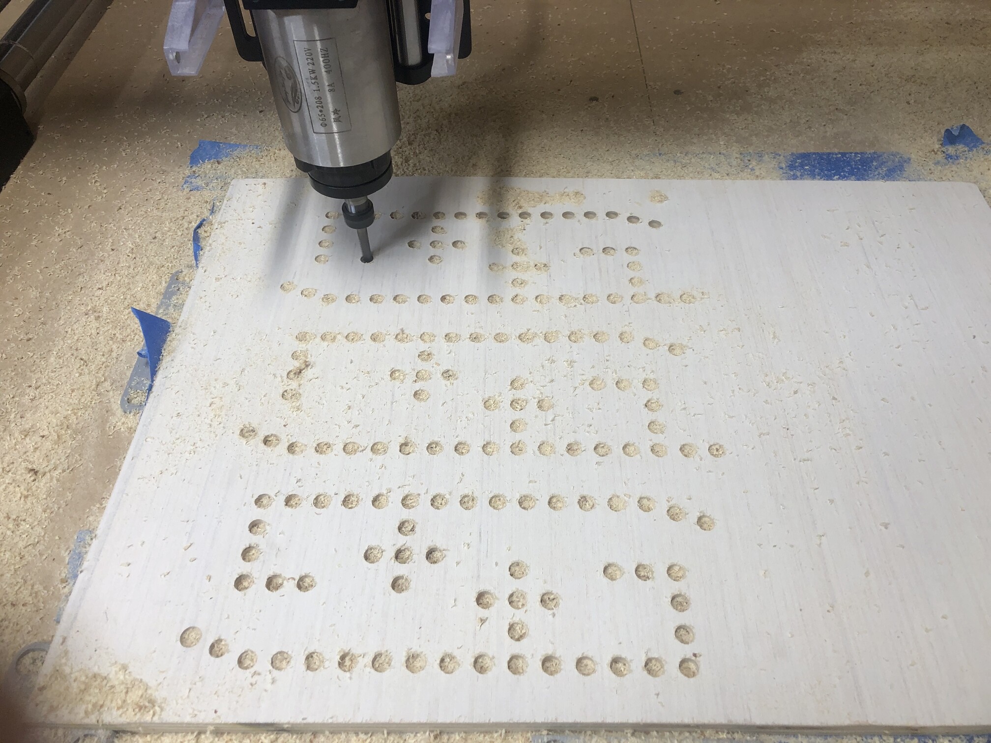

I am new to CNC and have a few questions.
  1. Should I do it? (It looks confusing, but I really want to learn)
  2. What is the most user friendly design software for beginners (that will work with the Onefinity unit)? I currently make round cribbage boards, and drilling 120+ holes by hand is more than boring and tiresome. A few people have said I should get a CNC and let it do the work.
  3. Are there any on line courses/classes a person can take?
thanks in advance
Hello @Jgolden4455 - welcome to the forums.
1 - that’s really a question only you can answer. If you want to automate your process, have the capital to do so (=$$), and time to spend to learn, seems like a good investment to me. The machine can batch out boards for you while you do something more productive.
2 - I’d say this is a matter of preference. For total ease of use, Easel or Carbide Create will get you going with little fuss. You will, however, outgrow their abilities over time. But you don’t need to understand climb vs conventional milling, step over, and a host of other technical things to get started. The default settings will work for just about any hobbyist-grade machine.

If you really mean the last then yes you should.
The learning curve is a hard bump at the front leveling off to a comfortable incline.
Opinions will always vary but for that use case I say Vcarve all the way.
YouTube has more than you can digest.
Here is a video cutting holes in plywood with .25 inch end mill at 150 ipm, 75 ipm plunge.
VIDEO-cutting holes in ply .375 dia with .25 inch end mill at 75 ipm plunge rate

Can you use a drill bit to drill the holes? Or does it NEED to be an endmill?
My understanding is drill bits don’t have the precision for run out not are they built for router speeds
Concur with BJ - regular drill bits are made for 2-7K RPM, not 10-24K. You can use a regular flat end mill, or drill bits made for CNCs. Precise Bits have a lot to chose from.
