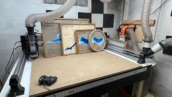

No dust boot pro… the one that comes with the machine works just fine. And they give you 2 options, one for the front and one that goes threw to the rear of the z axis…
Bits…i purchased all my bits from IDC WORKSHOP. GARRETT has everything you need plus video to follow…
Extension… your going to want to decided if your going to run a drag chain or not…
The drag chain keeps wire management clean. Modification is going to be needed, but well worth it.
Touch screen, yes!
Joystick, yes!
Z probe, yes!
And you got the forms with navigation and help when needed…
Good point about the lighting…
I purchase a white halo 12 volt and stuck it to the bottom side of the clear shield and ran the wires to a very small 12 volt battery turn on and off switch and zip tied it to the base of the dust boot. It works great and i can see perfect even in the dark…

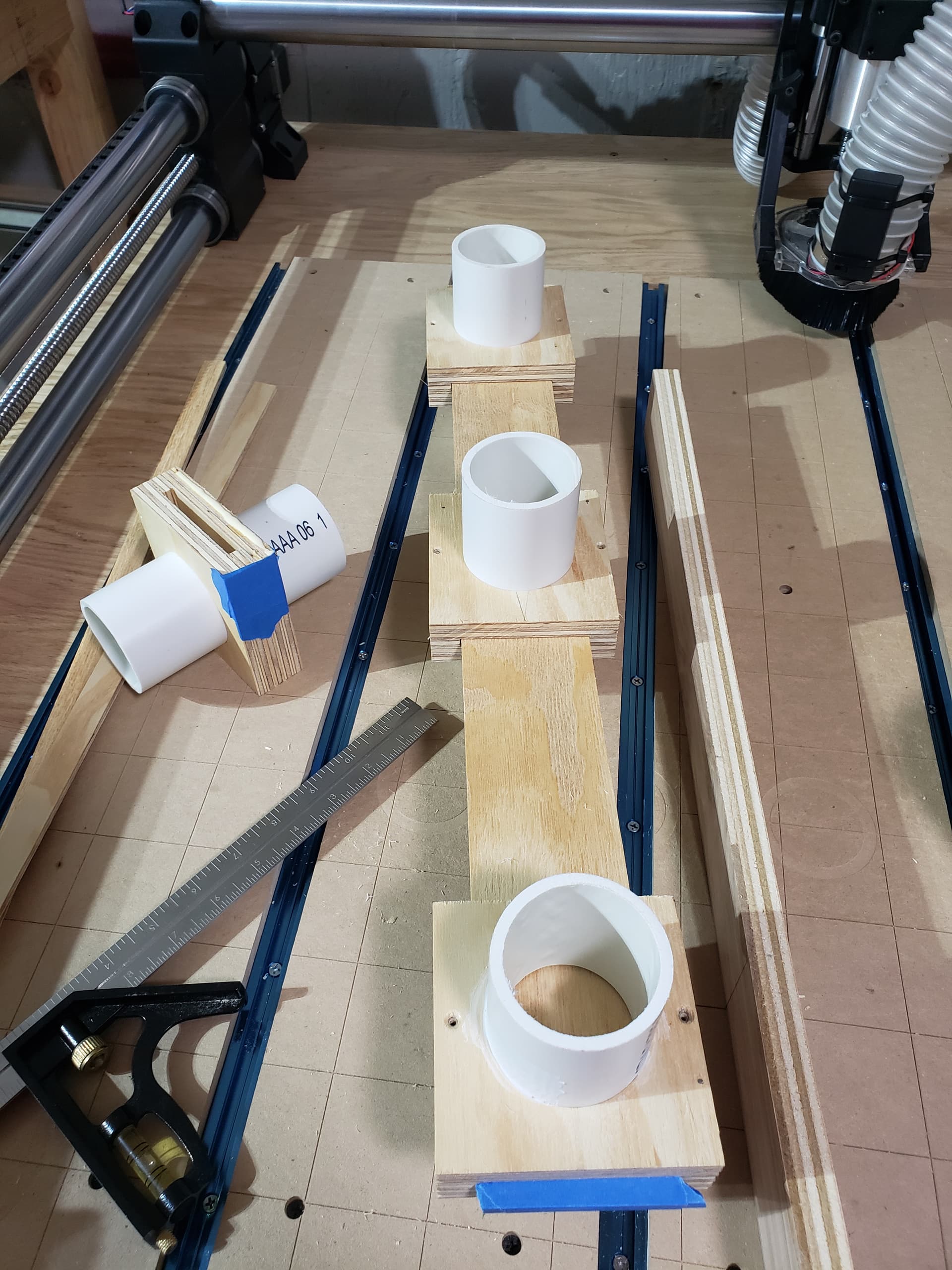

Depending on your layout of your shop a wet vac from home depot and a cyclone and dust filter for the wet vac can go along way. My shop size is 12’x24’ very small! Im using 2" pvc pipe as a manifold with 45’s ran along the floor to each station with wooden blast gates i made controlling what station gets suction…

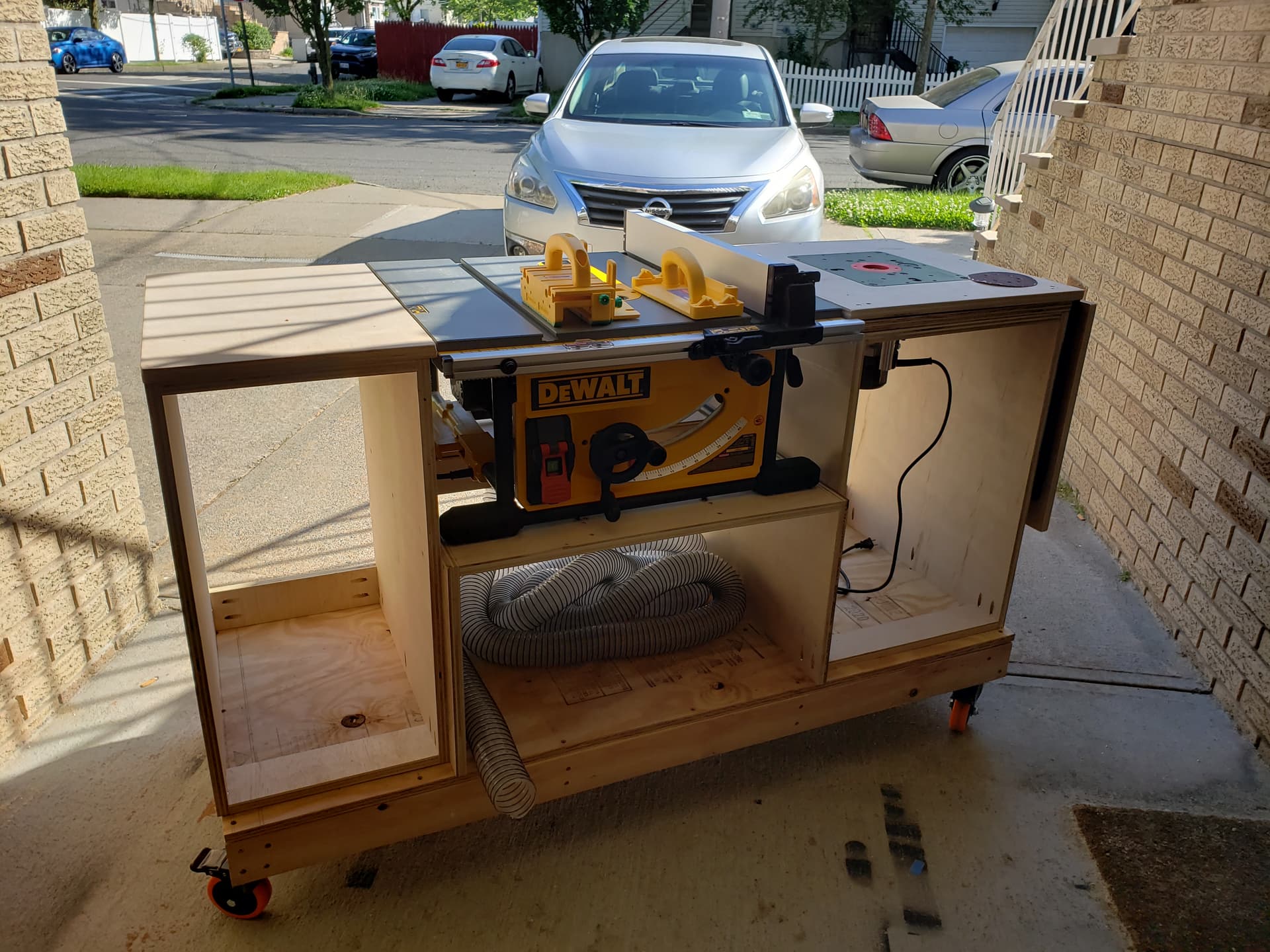

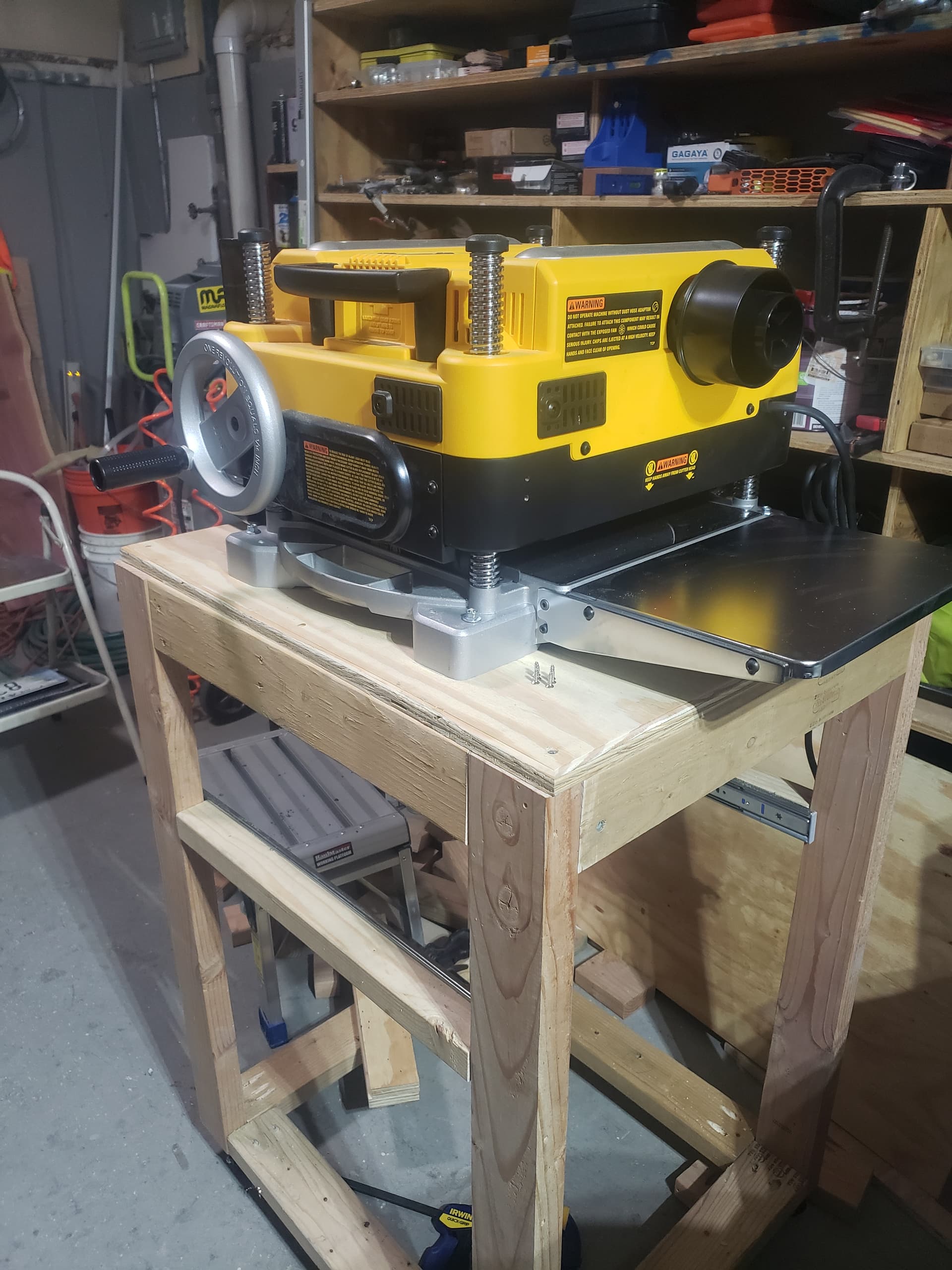

Try to have a plan for where things are going to stay put and what can move around. My x50 is stationary and my saw, planner, band saw are on wheel with lock’s…
But this is what works for me.
Thank you for your post, I have roughly the same space as you. Also, by the looks of it, I have the same equipment as you I was looking at upgrading to the jobsite tablesaw but I kind of like your little cart idea. I was considering making a cross cut sled, for it. I went with the smaller dust collection I heard the shop vac may have too much suction so I went with the 660 wen. I’m gonna check out the bit website as I bought the two moose design bits off the website but would like to get some extra bits that the set didn’t have. Thanks for the pictures I’m going to steal the carts! I also bought my first set of 36” parallel clamps, some of the spring hand clamps. I don’t know what other clamps I need. And I’m considering getting a 10 or 12 inch bandsaw. I’m not sure yet. I don’t think I need a drill press as of yet. Although it would’ve made it easier for my laser footholes but I just did that by hand with a spade bit and it came out fine. Any other tools that you might recommend that are useful?
