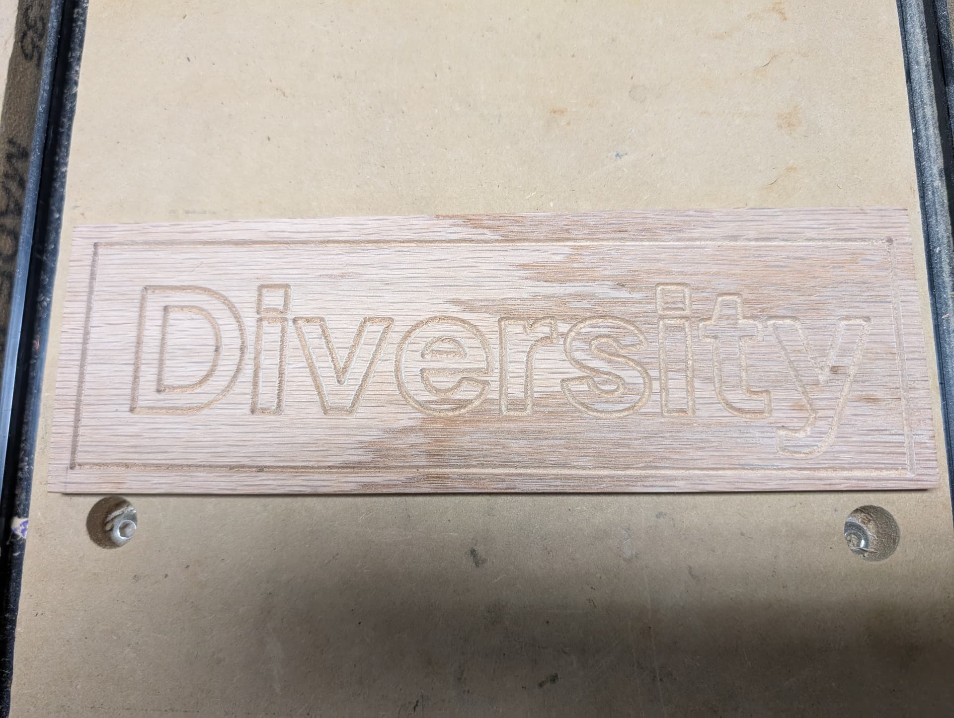

Ok, I have read this thread several times and I cannot figure out why my cuts are out of square after trying most of these methods. I would really appreciate some help.
I posted photos below so folks can visualize what I am describing. I have an Elite Journeyman and have been using it for going on two years. I do not know when the machine got out of square, but it is possible that it has always been that way because I cut out mostly small parts that are not square.

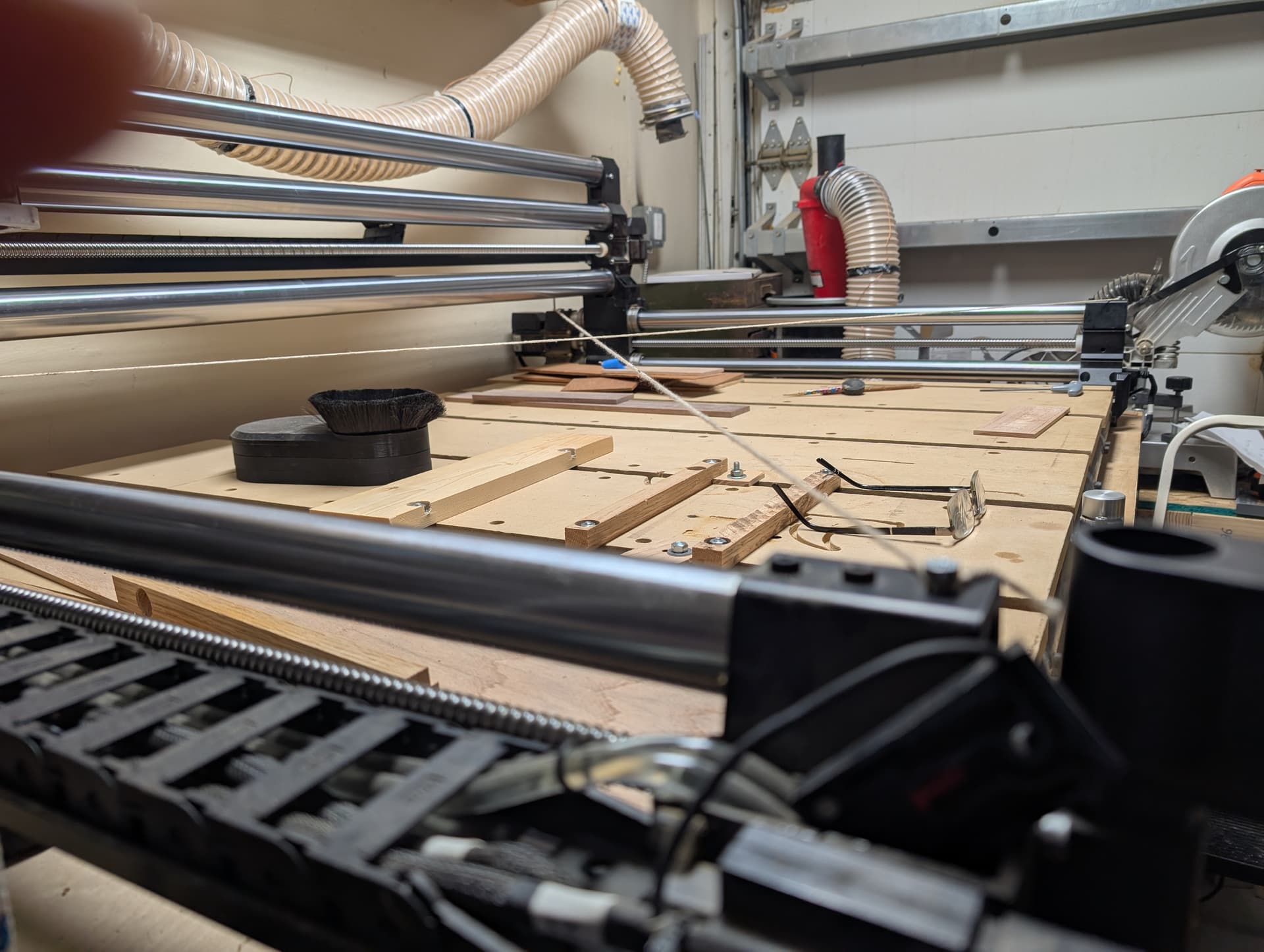

I found recently when I was cutting squares and engraving some rectangles that there was a problem. If you look at the last image below, you can see that the border engrave is off (see bottom right of the image below). Note: There is another photo below showing the stock in a metal square to demonstrate that the stock was perfectly square. Since my machine is on a QCW frame, I don’t believe the feet can be out of square. So I tried the string across the center trick to check to see if the frame was torqued. I removed the limit switches and put screws in each corner of the top rail. All were in the same place and tied tightly. The taunt strings touch perfectly where they cross no matter which one is on top (see first image below).
I also disconnected my stepper motors and loosened the four screws holding each mount for the Y axis where it connects to the X axis. I moved the rails all the way forward and retightened the bolts and connected the stepper motors again.

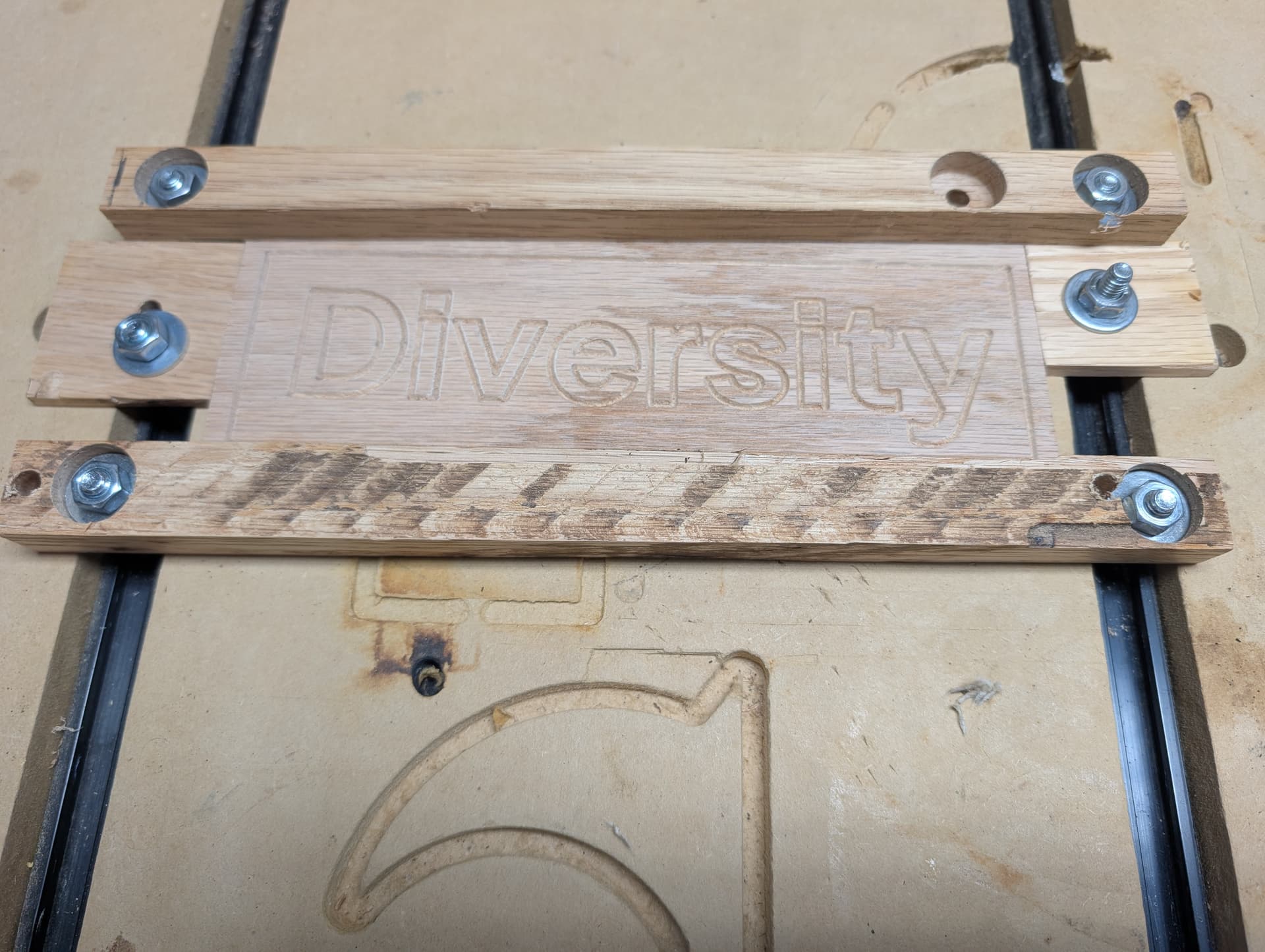

I posted a third image that shows how I have anchored my stock. The two long bars have overhanging lips. So the stock cannot move when it is being cut.
Neither of these fixes worked. I am baffled. I would appreciate your help getting this solved.

This might be a stretch, but did you check to see if the file is square to the x and y axis?
In Vcarve its possible to inadvertently rotate the vectors.
To check, mirror the vectors, if they are out of square, they will magnify the error.
Good thought, but yes, I checked. It is square to the x axis. I always snap to the axes when I create boxes or squares. It cuts perfectly in the CAM simulator, so I know it has to do with my physical machine somehow.
cheers,
jrg
Did you check out this post
Ken,
I had not seen this one. I will read through the full thread and see if I can figure out possible changes that will help my issue. Thanks for bringing it to my attention. I’ll post a follow-up either way.
cheers,
jrg
Problem Solved! So I made two changes. I loosened all of the bolts holding down the rails to the QCW frame, used a clamp to insure that the rails at the front were perfectly flush with the QCW and then retightened. I also reset my hold-down system, which was not square to the waste board. I figured that the touch probe would account for any degrees off in clamping, but perhaps I was wrong about that. Between the two things, I got the problem solved. And I learned a good bit more about squaring the machine to the waste board. All good. Thanks all for your help.
