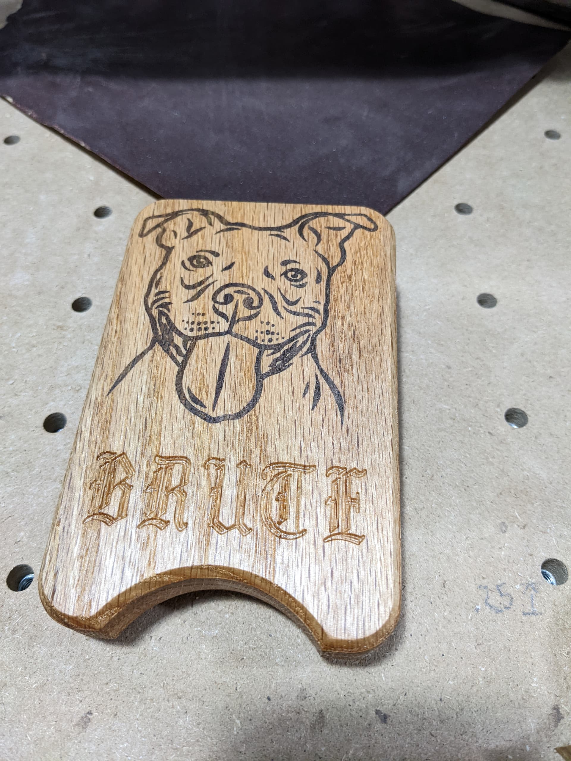

The base is 2 layers of mdf that the top layer is cut by the CNC so that the Information could be used in fusion360 as a fixture. It holds each of the squares with the blue tape and superglue trick. I was going to use it for multiple projects so I figured this was the most effective way. It will bang out 28 items. And the engraving under allows me to align it for the laser runs after. It worked better than I had hoped.

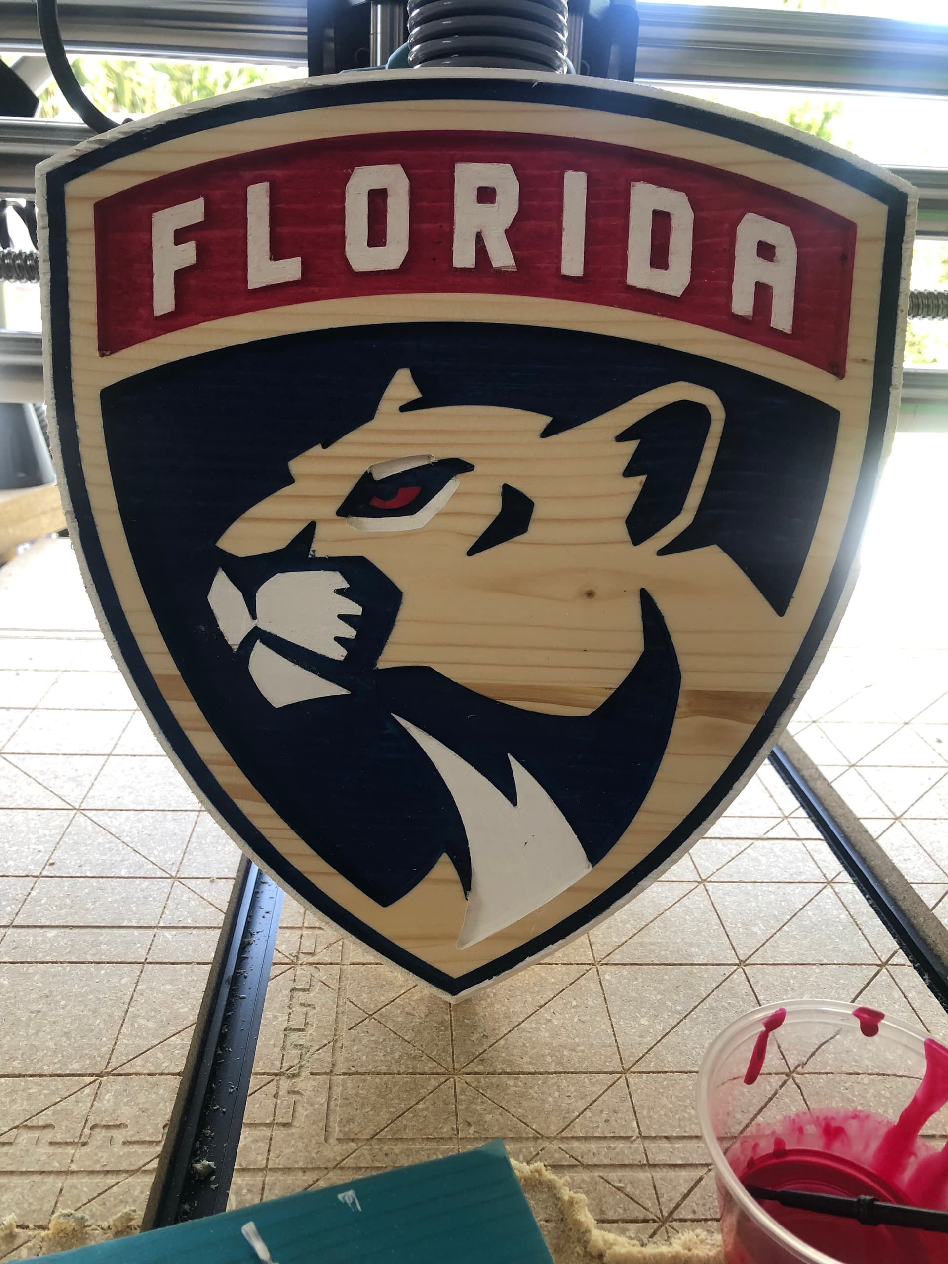

This weekend I wanted to toy around with oramask and sign making. Since the Florida Panthers NHL team is on a hot streak, I thought I would give that a shot. It is not perfect, but after I showed this to a few people I ended up getting requests for 10 of these! Not sure how that happened, but I accepted the challenge as a way to figure out how to make them faster, better, and cheaper. I will follow this up with my progress as I learn from my mistakes. Better get busy before they get eliminated in the first round!
Do you have any tips on how to make these? How did you mount the wood, carve each site then the top and bottom?

A lot of the challenge is making sure the dimensions line up. Meaning the height, length and width of the images are proportionate and that they are entered exactly to match in the setup of each side. then make sure the block dimensions match exactly. Then I double sided tape it to the table with blocks on each side, it will move otherwise. I carve the top first, then sides, then front and back. I leave the bottom block and left block in place and leave X,Y zeros alone. Re-zero Z. To carve the front and back I cut a hole in my table top to mount it vertically.

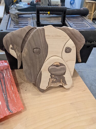

That is very creative. So the pieces are loose, and it could be used like a puzzle? Besides being a great work of art that could be mounted as is.
Yeah it could be a puzzle but the pieces are glued together in this case. Process is called intarsia.
