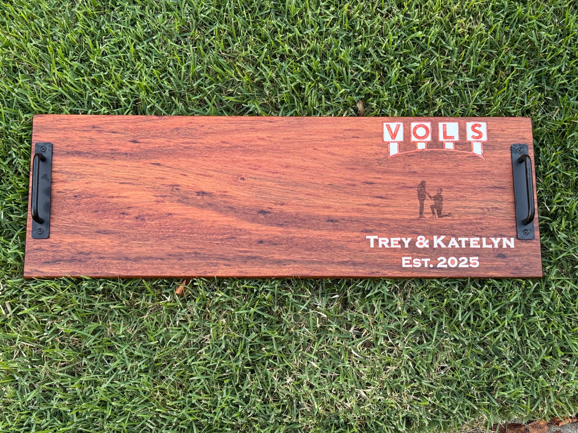

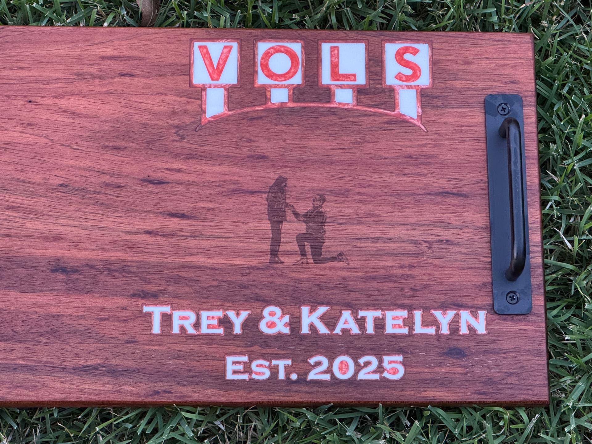

The grain in the charcuterie board looks like waves at the beach. Really nice piece of wood.
Thank you. It is the first piece of Birds Eye mahogany I have ever seen. I found it in a pile of walnut shorts at my local lumber yard.

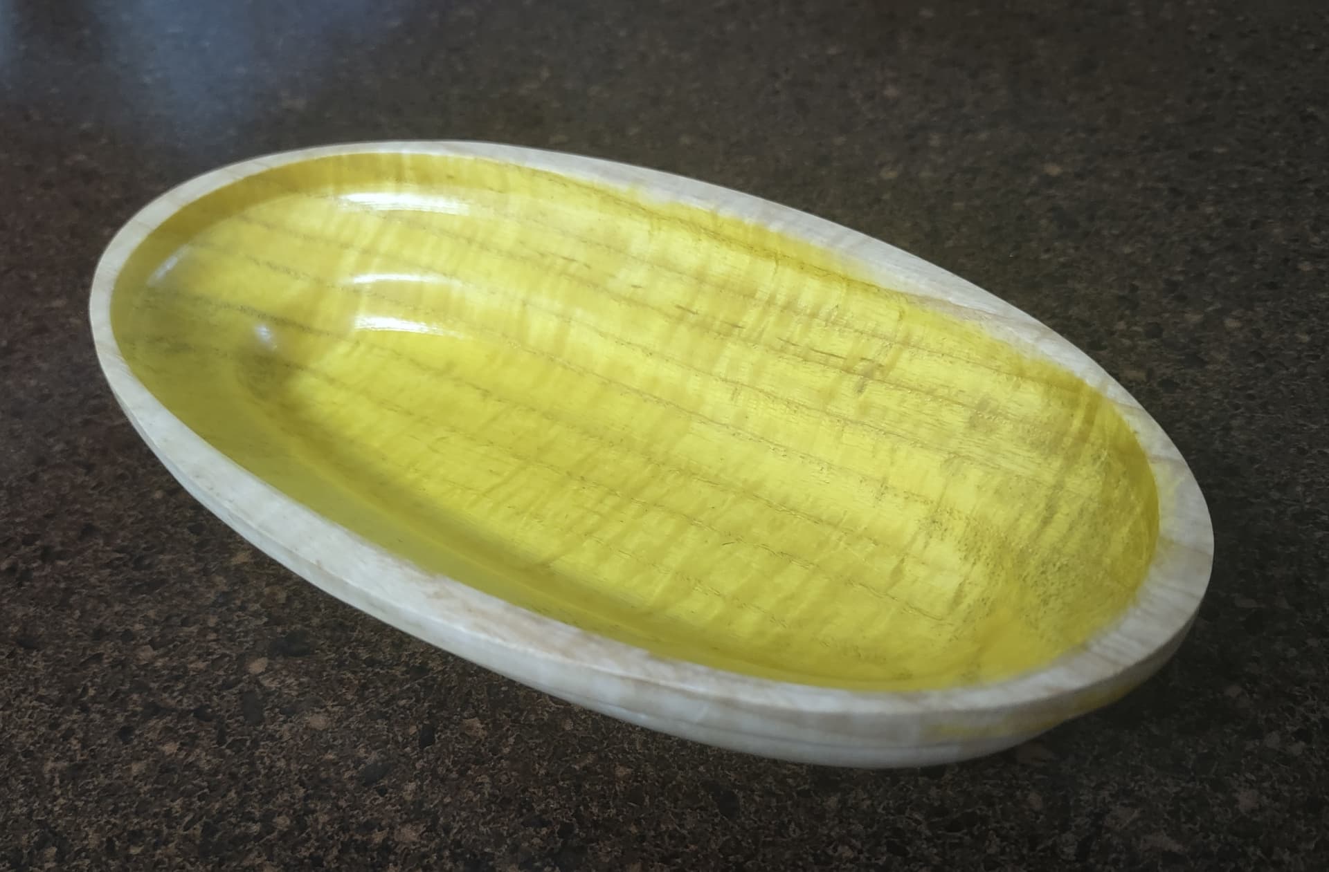

After watching an excellent video 2 weeks ago about making a pumpkin pie dish from “Vectric In the Labs” using the moulding tool path, I was off and running trying things with the tool.
After a little trouble and some guidance from Vectric support (EXCELLENT CUSTOMER SUPPORT!), here’s my latest, cut & finished today.

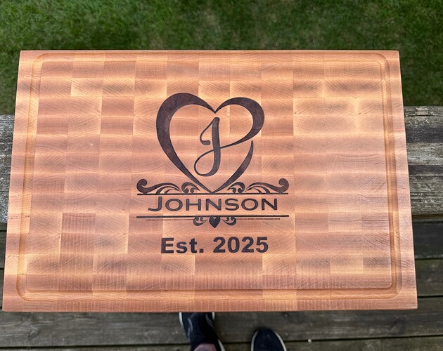

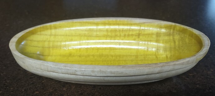

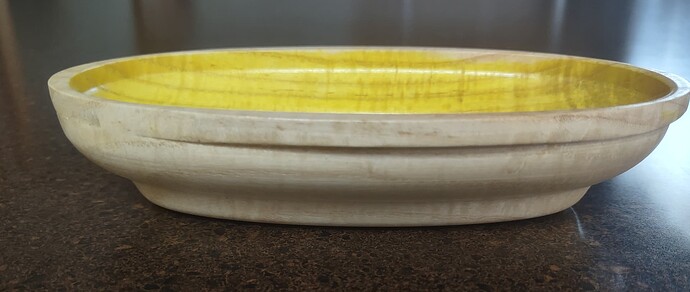

This is from an old piece of maple I’ve had laying around forever. After I cut it, I discovered the beautiful rays that were inside it. Wish I had more of it!
9" long, 1 1/2" tall, yellow dye inside, gloss cat lacquer finish.
For you newbies out there, practice, practice, practice, that’s how you learn…

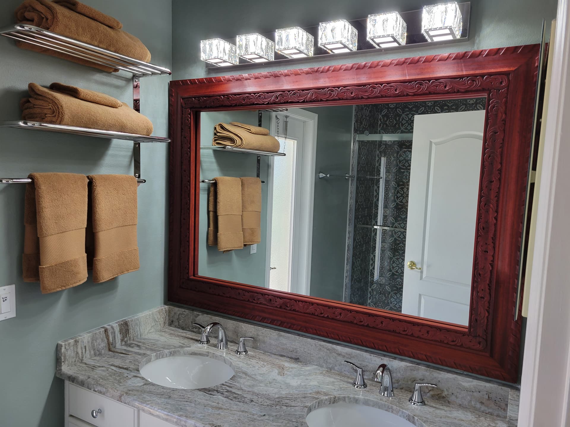

I recently had my guest bathroom redone and decided to make a frame (really an overlay) for the existing frameless mirror. The full size of the frame is 59.5" x 41.75", which means I could only fit half on the Journeyman at a time. This, of course, came with a number of set-up challenges, but I think it turned out quite well. The wood is padauk, finished with Natura Onecoat clear. The 3D model came from Etsy (resized). I also hammered a texture into the recessed areas by hand, as I was not happy with the finish in some places and sanding was not really an option.

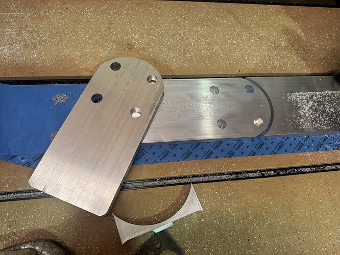

Wow that’s a lot of aluminum milling. Just curious what size of onefinity you have and how long it took. Was it a 1/4” endmill? Do you plan to polish it?
I never realized how much the red bull ring looks like a cartoon version of a whale.
@ChrisM
It does look a lot like a whale.
I have the pro woodworker. The ring started as a 1x2x4” block of 6061-T6. There was a roughing operation with a 1/4in o-flute and a parallel finishing operation with a 1/4in 2-flute ball endmill. It probably took about 40min total. It was supposed to be a test, so I didn’t have any real plans for finishing it.
