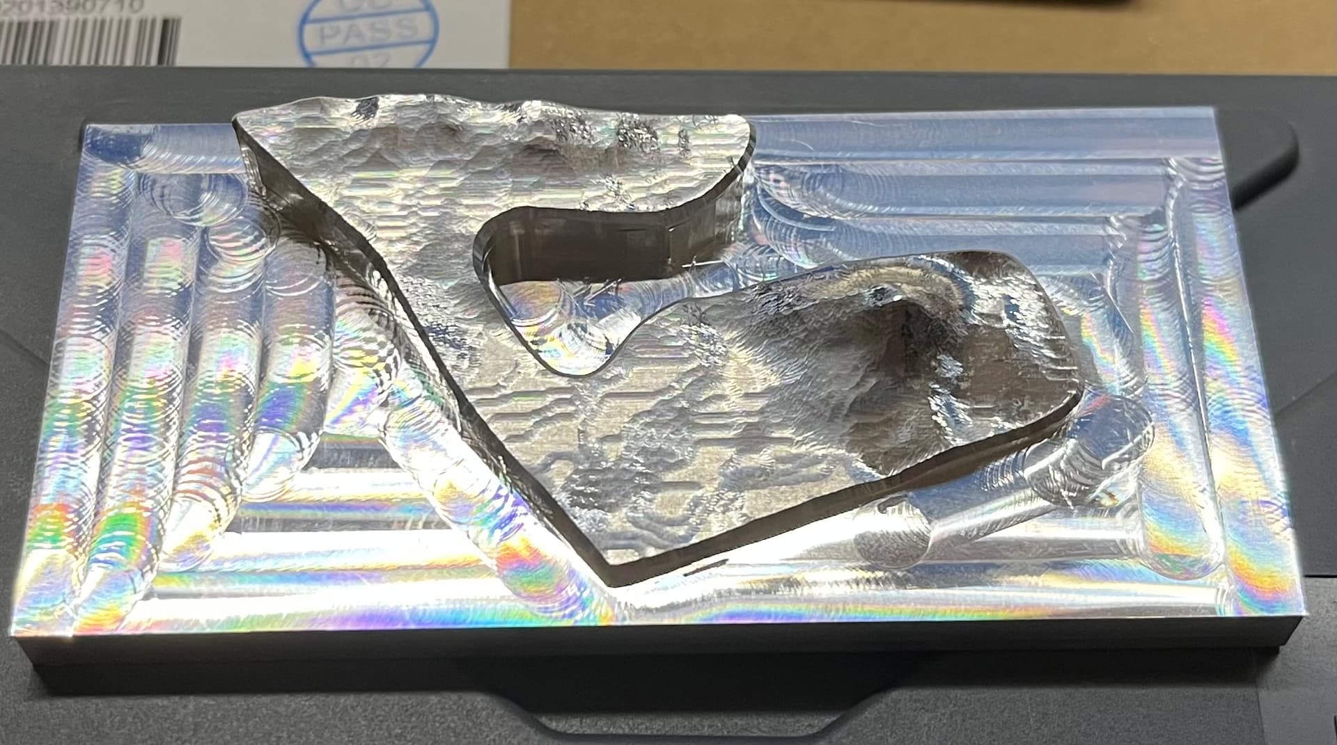

3D topographic Red-Bull Ring in aluminum.
I am normally not into production job, but had an order in for CPO Pride Day. Router, revolution and 1F JM knocked it out of the park.
Hey xenith
Wow that’s a lot of aluminum milling. Just curious what size of onefinity you have and how long it took. Was it a 1/4” endmill? Do you plan to polish it?
I never realized how much the red bull ring looks like a cartoon version of a whale.
@ChrisM
It does look a lot like a whale.
I have the pro woodworker. The ring started as a 1x2x4” block of 6061-T6. There was a roughing operation with a 1/4in o-flute and a parallel finishing operation with a 1/4in 2-flute ball endmill. It probably took about 40min total. It was supposed to be a test, so I didn’t have any real plans for finishing it.
