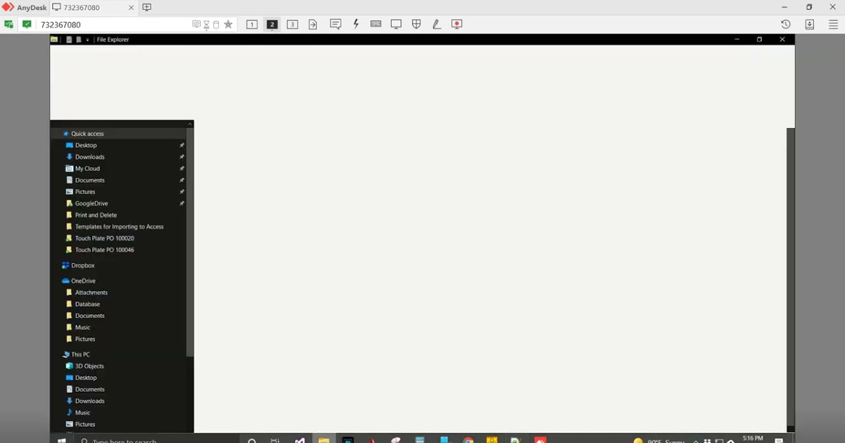

Thank you so much, you’ve saved my bacon… again! I’ve uploaded the mod g-code provided by techrise and it dropped me at 8:55 minutes, so it will be sucking up roughly 6.5 minutes of “air cutting time”
Thank all of you contributors, @Techrise, @ben, @charleyntexas, @GregoryG
I believe it’s time for me to put my spare UPS that’s been collecting dust for a while to good use. I have an APC UPS 2200VA that I am going to dedicate to my exclusive use on OneFinity. I’ll connect the OneFinity, and the router to it, and that should afford me a good 45 minutes of running time, - enough time to at least pause it, in the event of a sudden power interrupt.
I will get some buds to listen to Charlie’s video and learn this indispensable g-code editing technique.
My Teak project has about 55 minutes of roughing’ to go.
