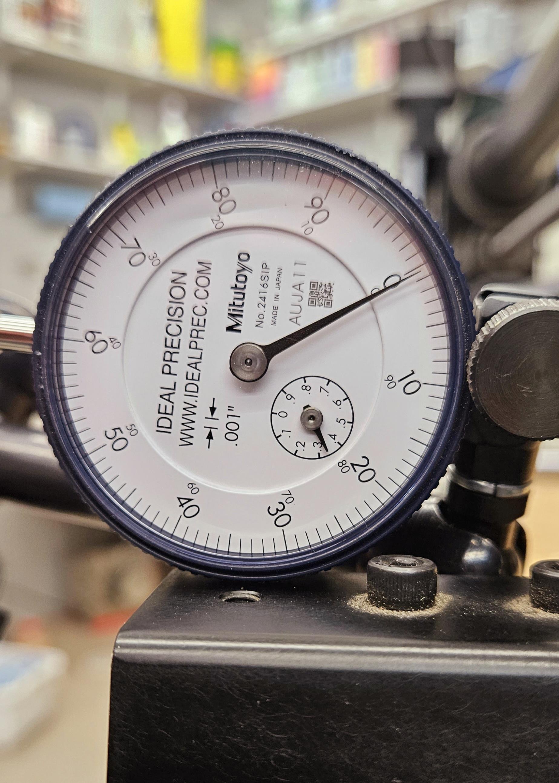

Regarding the accuracy you mentioned using the proximity sensors, I set up a dial indicator to monitor the home position of the Y1 gantry. After the initial homing, I zeroed the indicator. I moved the Y-axis to different positions, starting a few inches away from home to the max Y-position, each time homing the Y-axis. In a dozen homing cycles from all different starting positions, the gantry returned to zero with no more than 0.0005" of deviation (pic is of greatest deviation I saw). I’ll admit that I never tested the accuracy of stall homing this way, but I can’t imagine it could produce results any better than this. Very pleased with how they perform, even if I can’t use the Y2 sensor!
