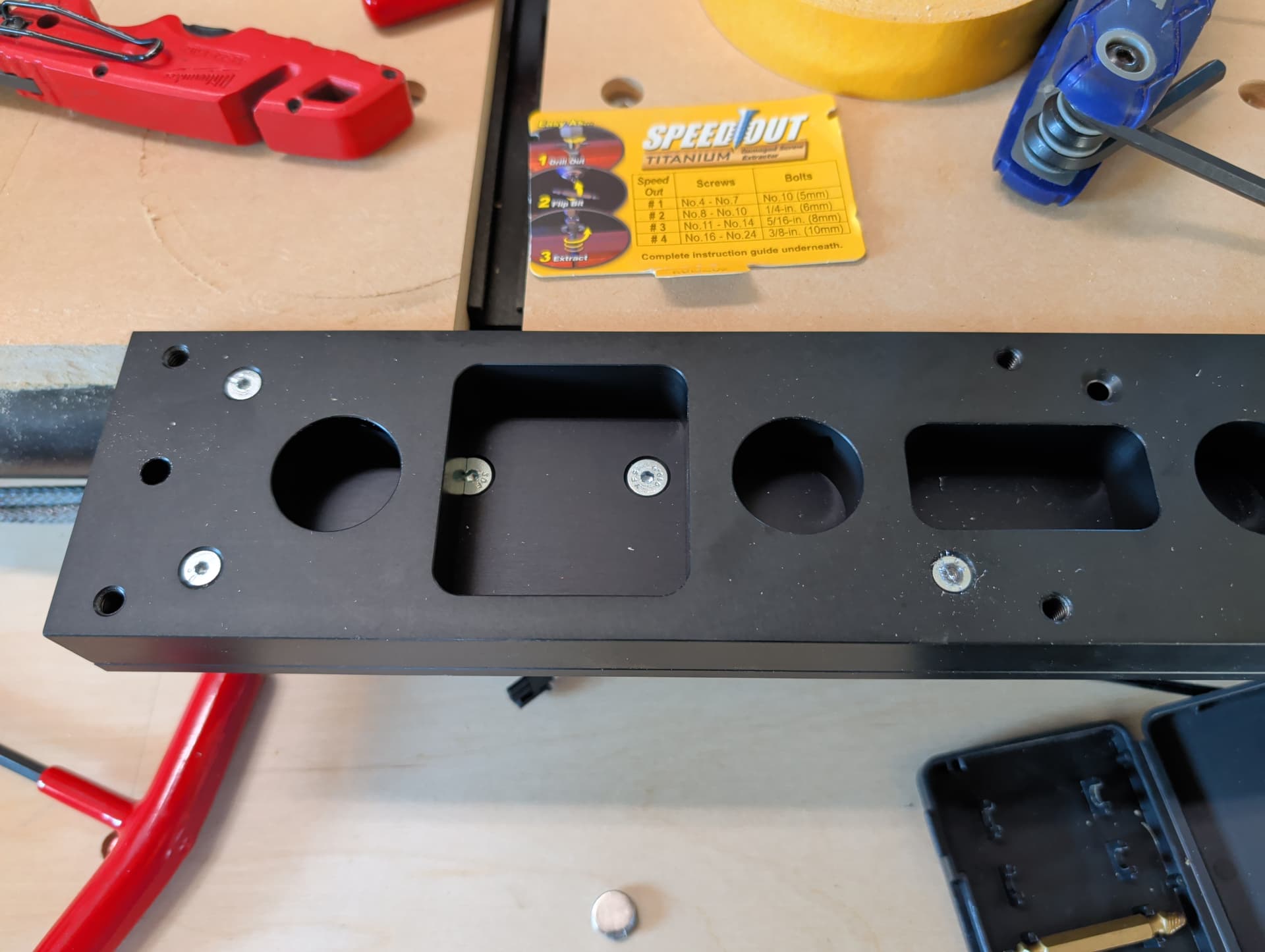

Didn’t even torque these down tight. The material they’re made out of seems to be very soft. Can’t back them out and now I’m sitting here trying to use a speed out bit. Very soft metal screw. Need to get these out and find replacements
Good PSA letting people know to take care when installing these.

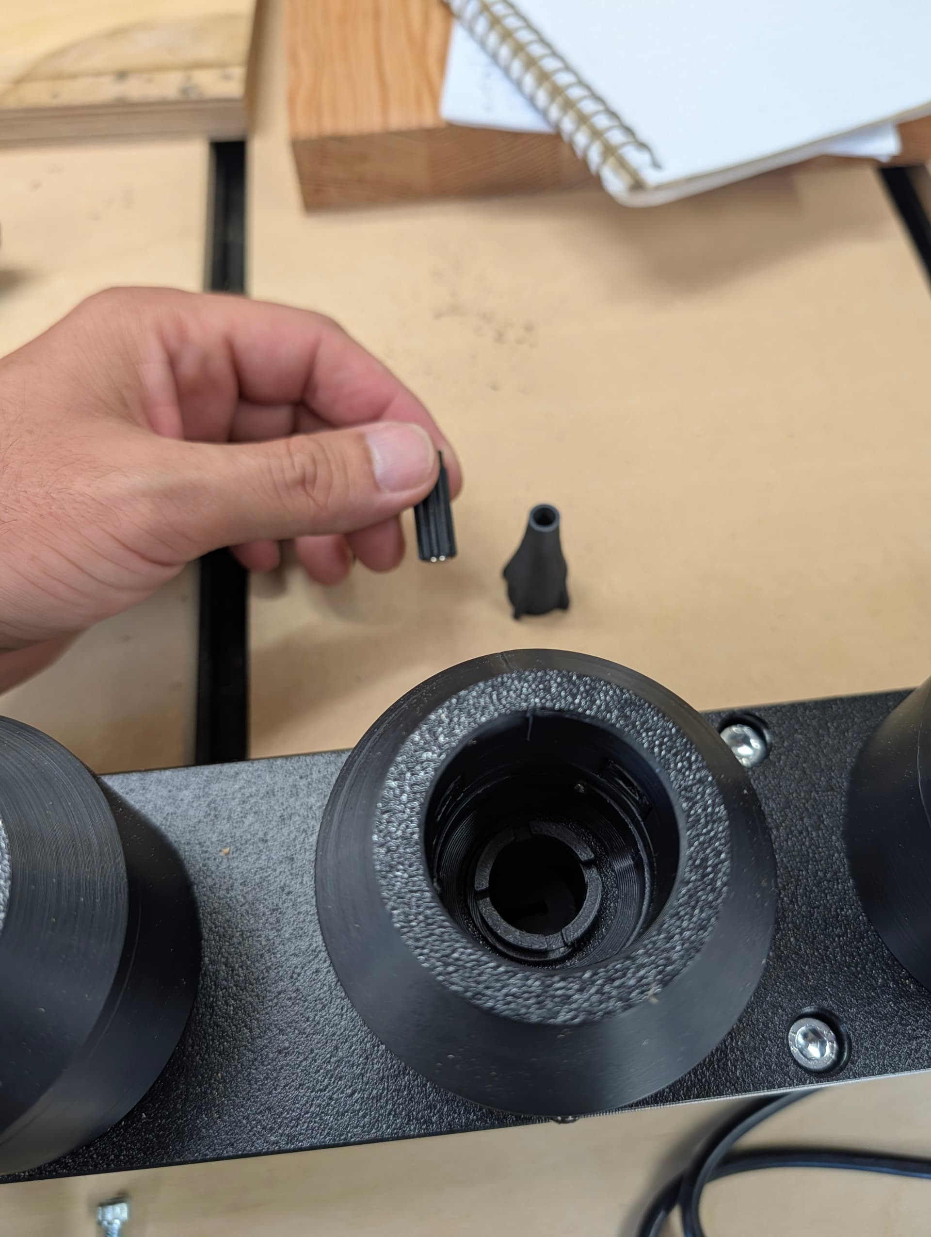

But wait there more…. Depth setter snapped unscrewing the inside (function of how this was 3d printed) with a weak joint.
This feels like a hobby product I made myself not something I paid for. … Are there files to print another? I happen to have a 3d printer
Hey @mkyb14 ,
Send an email to @RapidChangeDon at support@rapidchangeatc.com and they’ll get you fixed up with the depth setter!

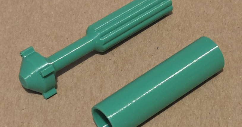

I had some issues with my tool so I re-designed it. You can 3d print it solid. I just posted it today on printables.
