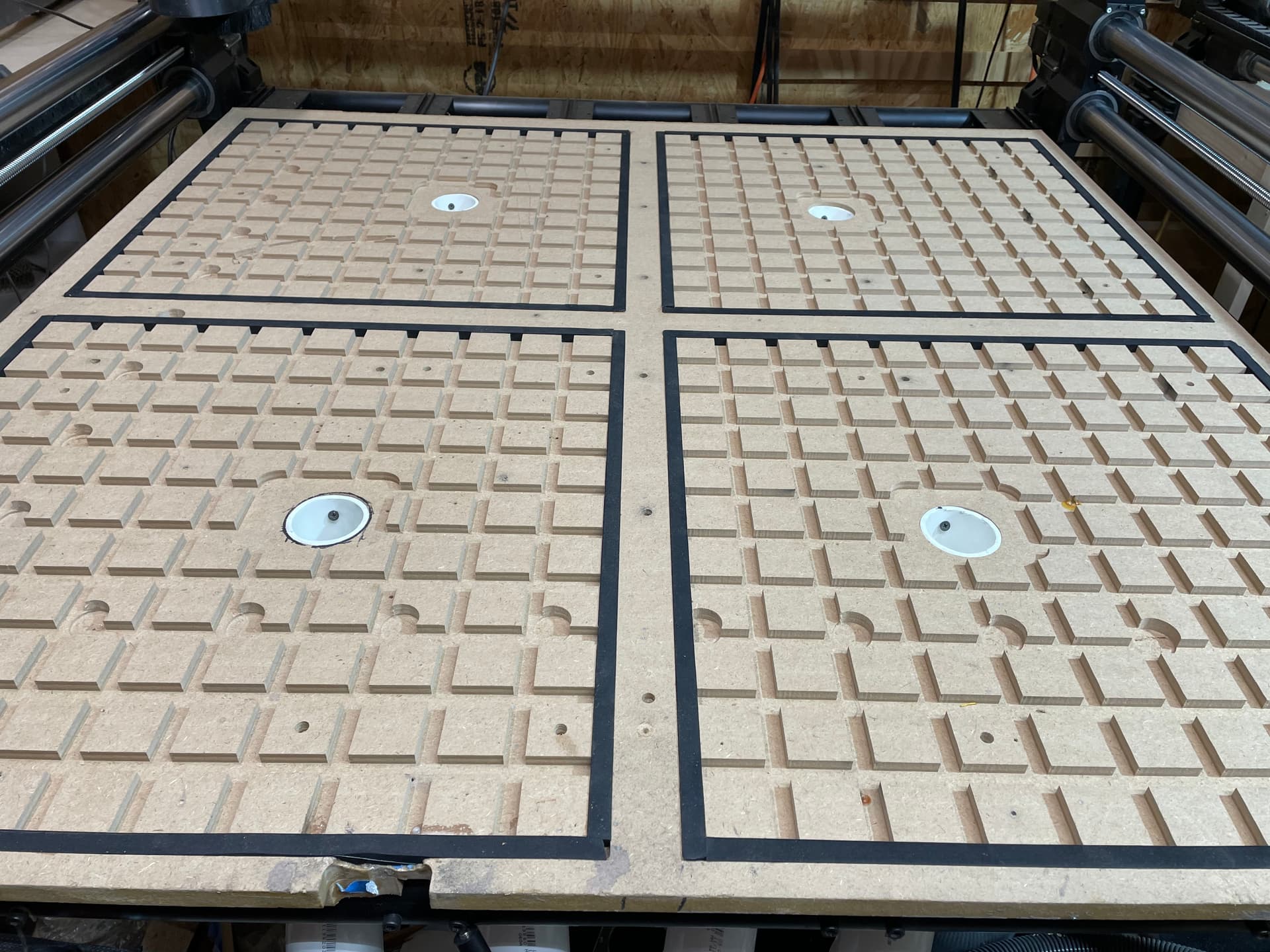

here is qcw vacuum table, i did real quick
2" pvc. installed slats, took measurements of locations, for holes and slats, put 4x4 piece on it and started cutting. cut holes in middle of slats. put 4 ball valves in(from lowes) and grabbed 6.5 hp hart brand shop vac from walmart(69 bucks).
made grid 3/8 x 3/8. found the vacuum grid foam on ebay for about 35 or 40 bucks. came with enough to maybe do 2 sets fo boards. can prob reuse this a couple of times. keeps air from sucking around edges which really affects performance. that said, i put gorilla tape around the edges to cut the 1st 400 sheets of ply. i cut a lot of cabinets and cut 1/4, 1/2, 5/8 and 3/4 hardwood plys, some boxstore cheap plys for my shop, and melamine in 3/4. cuts like gravy. i use 1/4 jenny bit and cut full depth on all the cuts. i also use nic frost cnc bits on his 1/4 mortising bit. works great. on melamine, it is so sharp it will cut your fingers just picking it up. no chips. fyi, i have to dump my jet 2hp dust collector (35 gal) 2 times a week right now.
