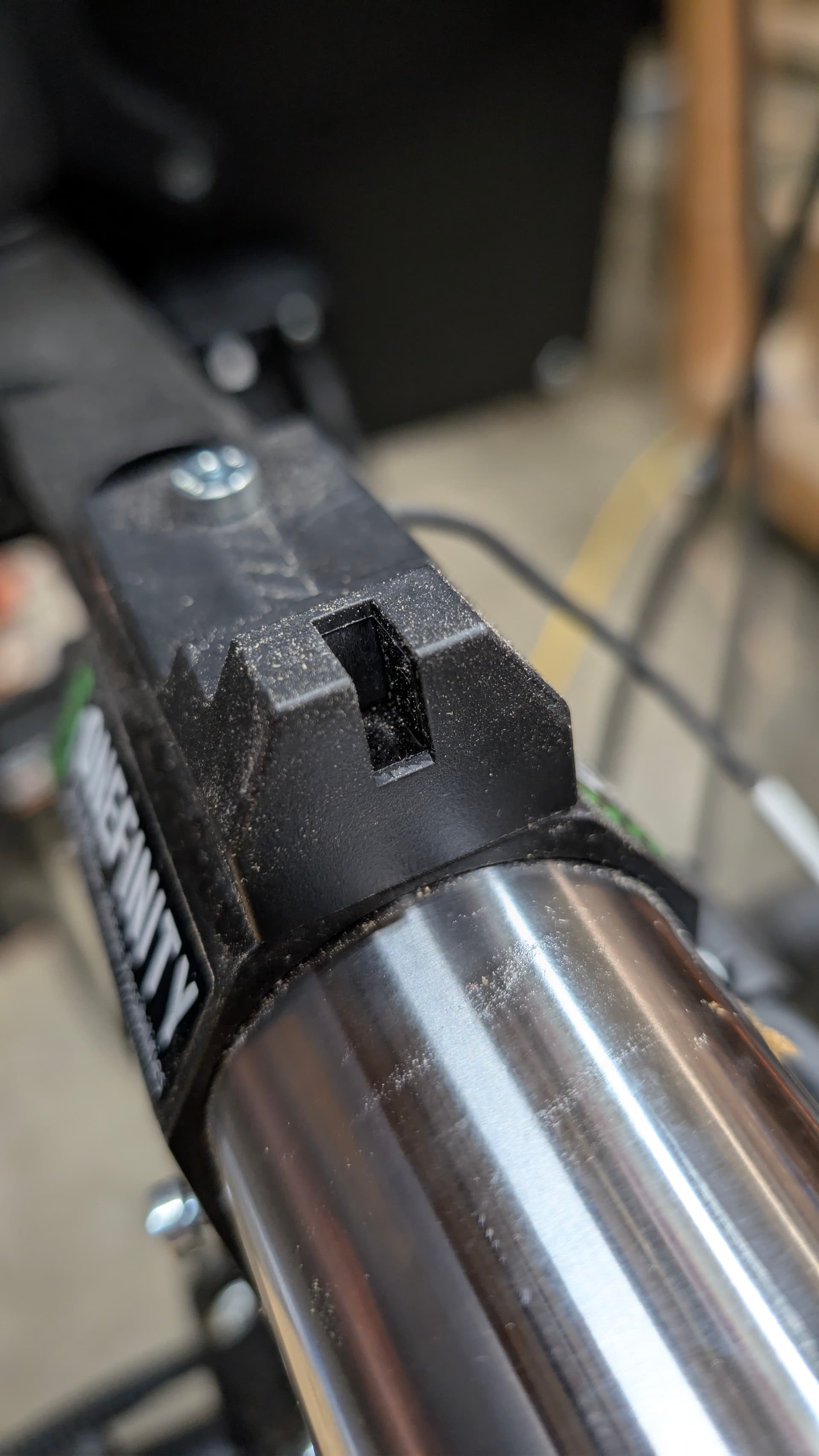

I was under the impression that the new Redline variant would have the infrared sensors, not the induction sensors. Did I mis-read something in regards to what sensors are included with the Elite Foreman, Redline?
They have infrared sensors.

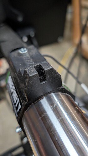

Is this infrared? There is a little “finger” that slots into each of these at the 0 position. Seems induction to me.
I see a little LED on the top, I passed a small plastic peice through the slot and it actuates the sensor. I recall seeing a video that said to be careful not to block the sensor to the rail, so I assumed something different. So it seems it’s infrared, and the finger blocks the infrared to actuate. Thanks.
