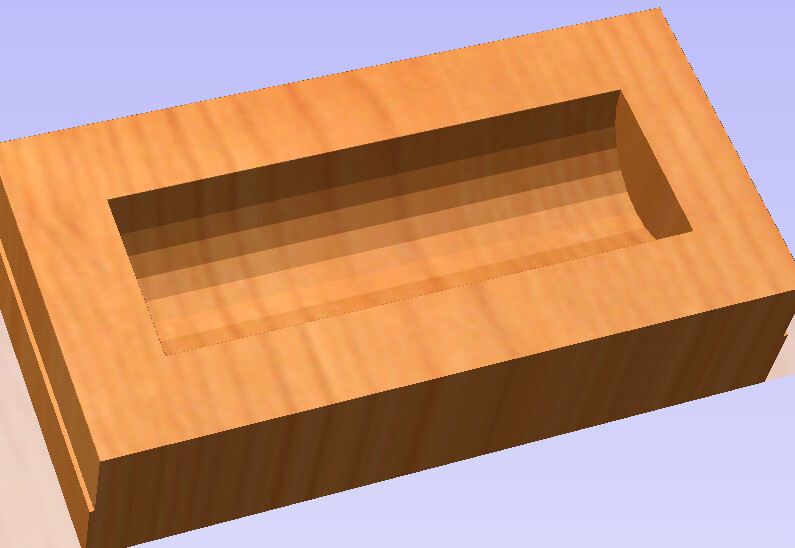

Are you looking to do something like this which was first created in SketchUp and saved as a .SKP file. This example is just a simple pocket with a rounded bottom but it could have been stepped to different depths and diameters or tapered along it’s length. But since I have no idea what this tool looks like let’s start with this.
Then imported into V-Carve Pro
[ File -->> Import -->> Import Component/3D Model ]
Don’t ask me how to create the toolpath. I’m too green at V-Carve to figure that out but I am sure someone here can.
