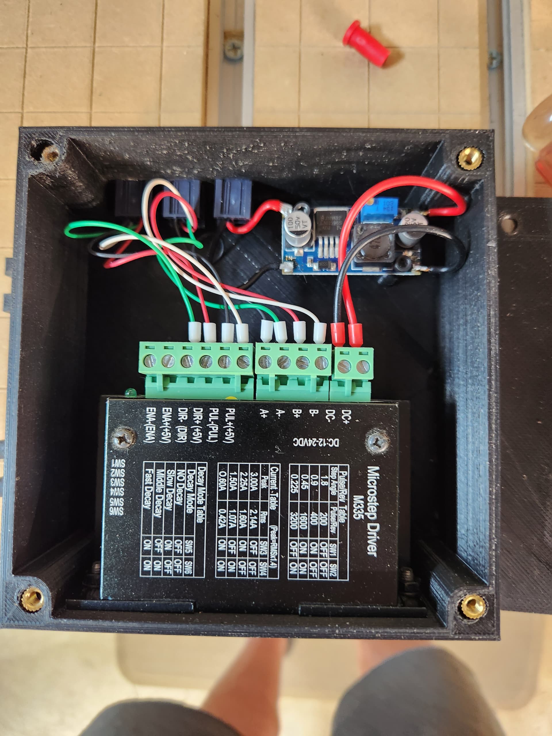

So I measured the voltage from onefinity’s power connections and sure enough it was 36 volts dc…so im not as old as i thought i was
This is the box I printed, and the buck to drop the voltage for the 4th axis driver, it was 36v in dropped to 24v through the buck to get the rotary happily turning. As stated I intend to change out rotary with a new unit and swap in a masso motor with driver built in. Should clean things up .
