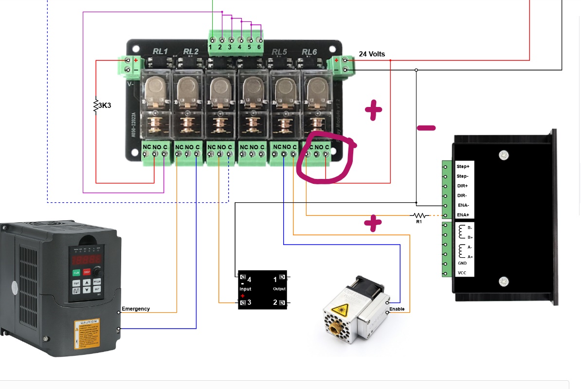

Thank you for sharing your success, as well as the wiring diagram.
Just so I understand, the ES output from Masso was not outputting enough voltage to trigger the Masso relay input?
In your diagram, it looks like it is split, and one leg goes to the Onefinity box. Masso says you can connect up to 2 relay inputs to the ES output, but maybe what it connects to inside the Onefinity box causes the voltage to drop even more?
How did you add power to the Masso controller output port - I do not see that on your diagram?

The output from the relay to the brake wasn’t putting out any significant power to speak of.
Like i said i was able to manually rotate the brake when it was plugged into the relay with a screw driver, but it was fairly difficult, likely causing motor alarms when trying to move. I wasn’t able to rotate it when it wasn’t plugged in. I was thinking there was some setting somewhere then i called my buddy and that’s when i hooked the multimeter up and came to the realization that the relay wasn’t outputting the power needed to fully disengage the brake. Now when i hit the estop i can hear it snap closed, and unlock i can hear it snap open.
The es output port just activates the normally open/ normally close part of the relay. The way i added more power was the lower part at the relay where i added a jumper wire from the power input and plugged it into the common at the relay output, then the negative of the brake to the power input negative terminal. Maybe the 3a fuse was too restricting, i think i read the relay can utilize 5a. The relay signal comes in from the single terminal at the top, and triggers the relay to open or close which sends the power to the device

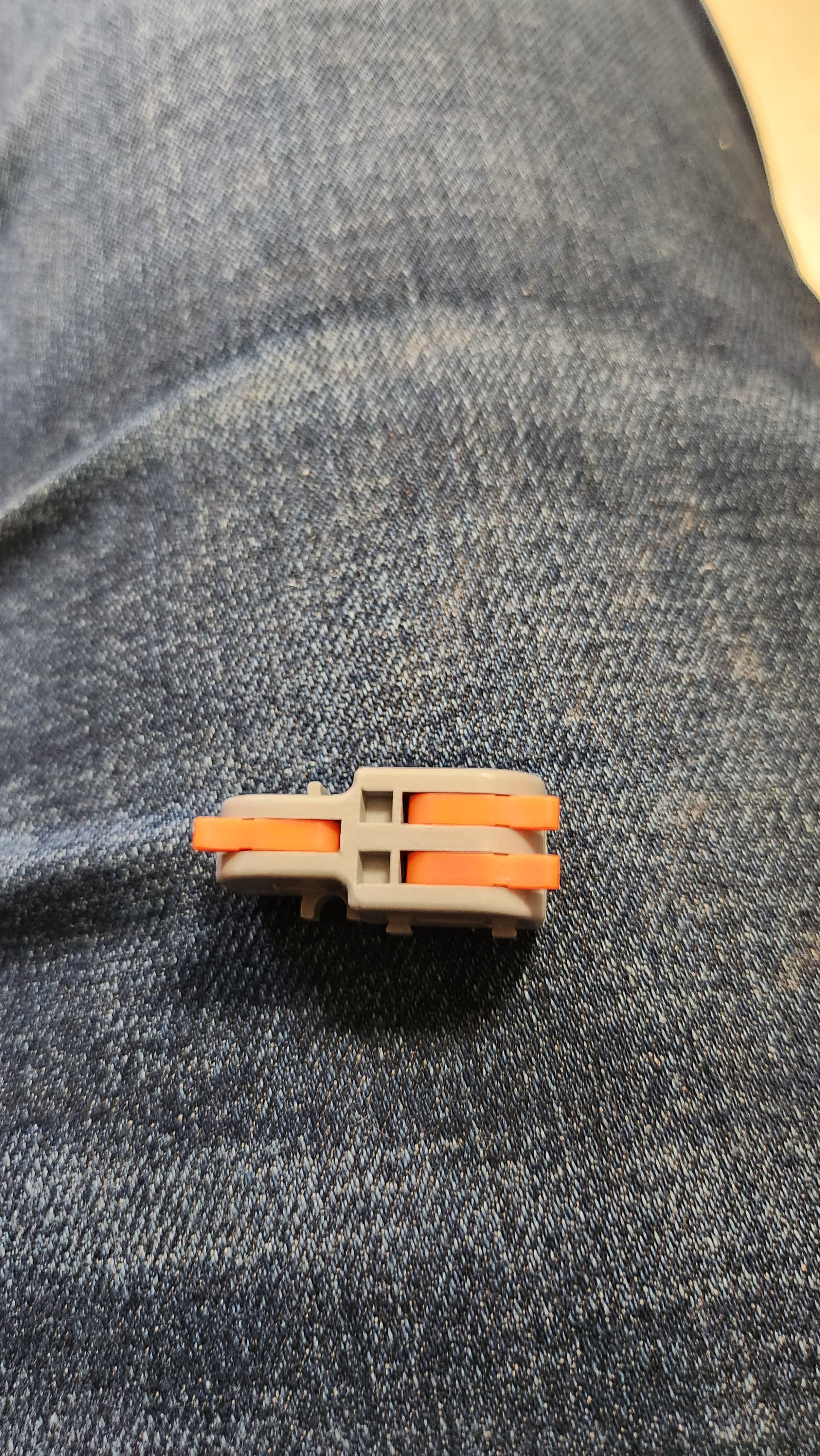

I found these and thought they were the coolest (and can be utilized in my shop build as well), so this is what i plugged the router and shopvac es output as it goes to the black box, the other one into the relay, and the single side going to masso… intent being i don’t want to lose functionality, even though it’s a function i don’t use. Not split but merge.

I highlighted the example that ‘most closely’ matches your solution in Masso’s Estop wiring diagram - but it is for a driver enable circuit.

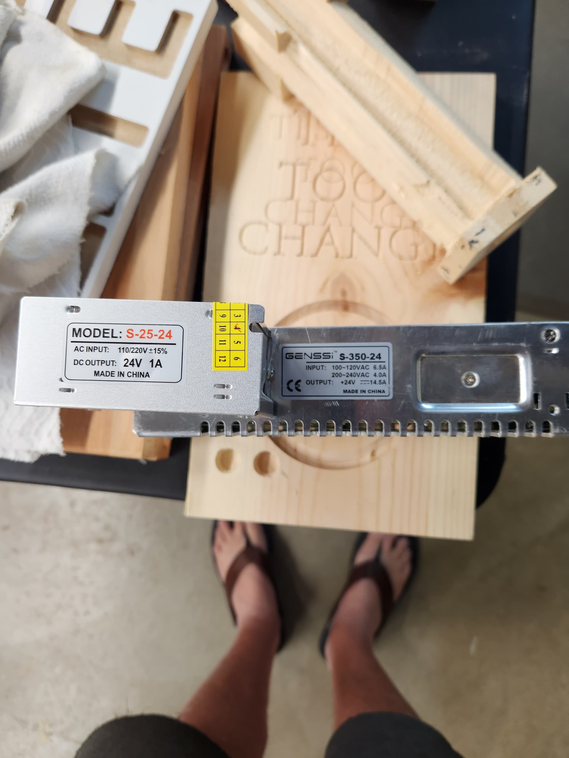

I have 2 - 24volt DC power supplies one is 1 amp, the other one is 14.5 amp.
You think i can get away using the one amp
On the ac side mine is fused to 1a, dc 3a so it depends which one. Mine puts out 75w
Heres a shot of the labels
The big one is 144watts so i guess that works
