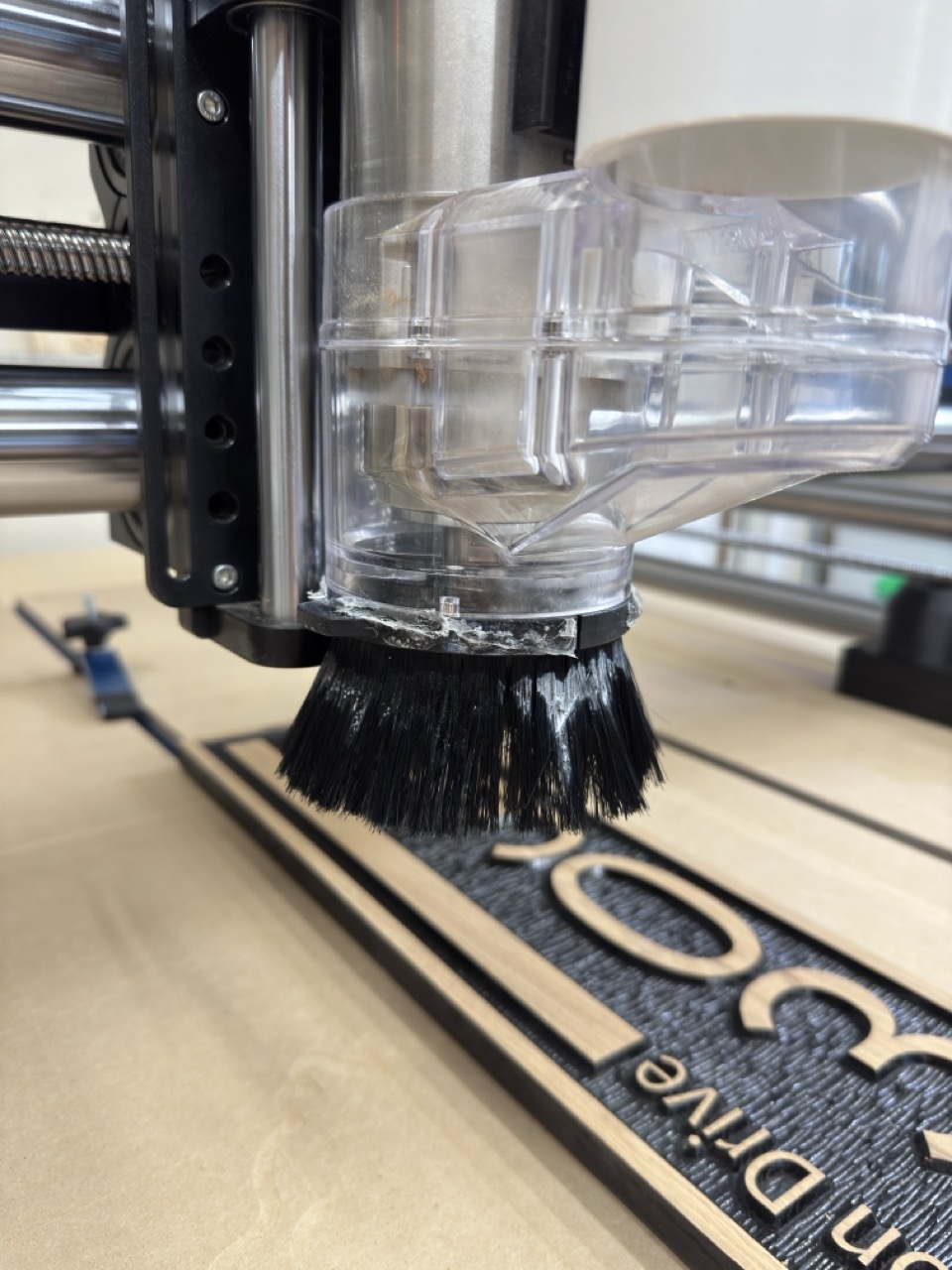

Suckit SM Dust Bristles are too soft, alternate bristle options?
I’m Running a 2hp dust collector system (harbor freight w/ cyclone), 4in hose to the Suckit SM w/ 4in adapter. The bristles are sucking right up into the dust boot, and I get a small % of the dust/chips flying all over.
Wondering if anyone has had luck replacing the bristles with something stiffer?

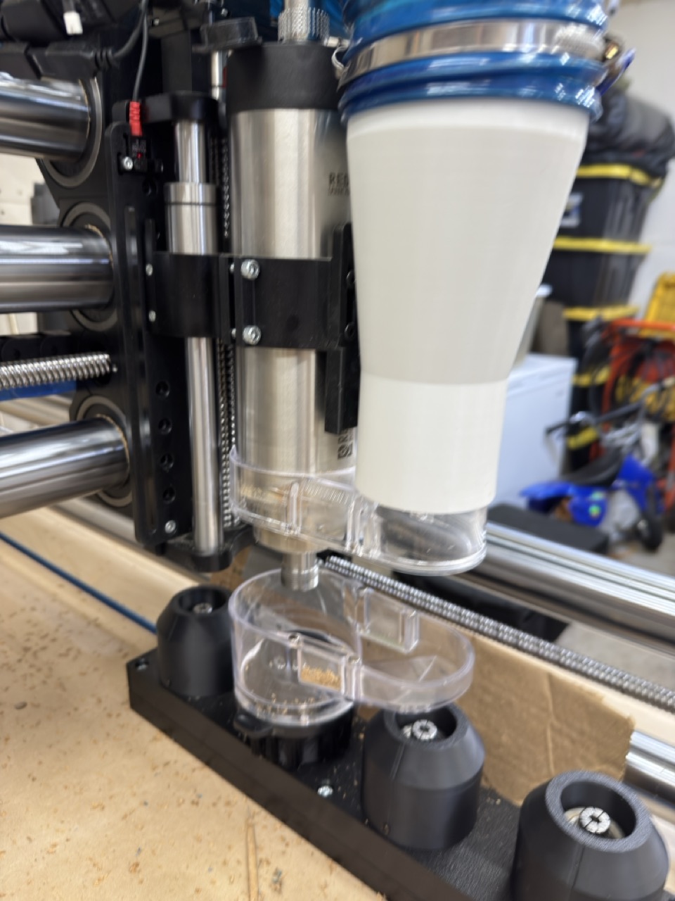

I recall hearing the softer bristles were helpful during tool changes, as the amount of compression needed with long endmills created too much force and occasionally the ring would dislodge. I can imagine the power of your vacuum may require a stiffer bristle.
I have sourced brushes such as this on Mcmaster Carr - just make sure to match the dimensions of the brush band. From the pictures it looks to be ~ 4-5 mm x 4-5 mm.
I just finished automating my vac so it shuts off before a tool change and I still had the dust boot get stuck and almost snapped a bit.
The bristles are too fine and stay bent back into the boot just enough that they fold up into itself during a tool change, and then the boot gets stuck.

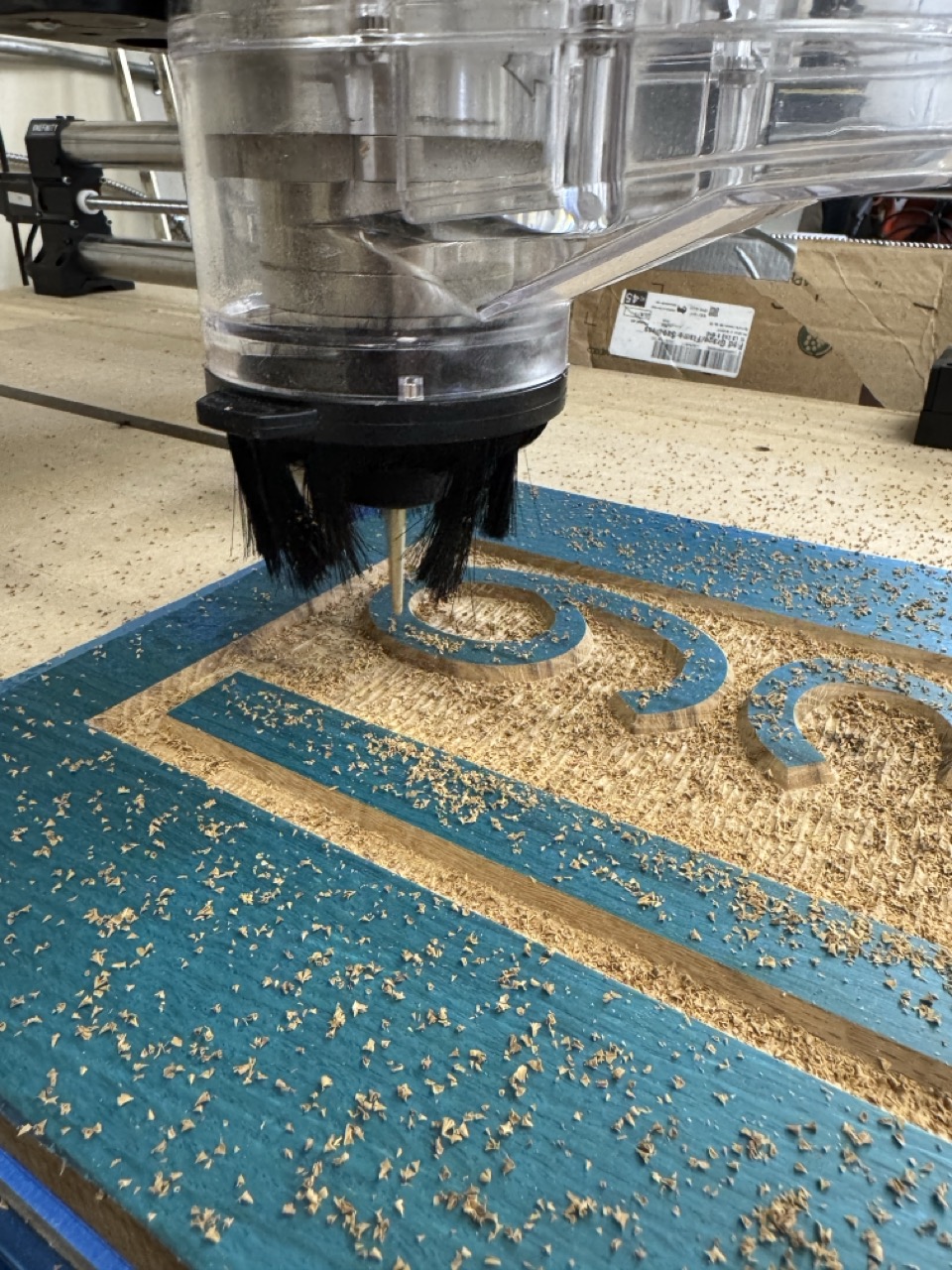

I’ve raised the boot up on the spindle, but even with the long bristles on, it’s not as low as my bit, a standard tbn 1/16.
Long bristles are just blocking the dust boot and dust is going everywhere. :man_shrugging:

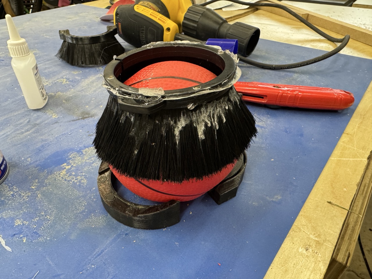

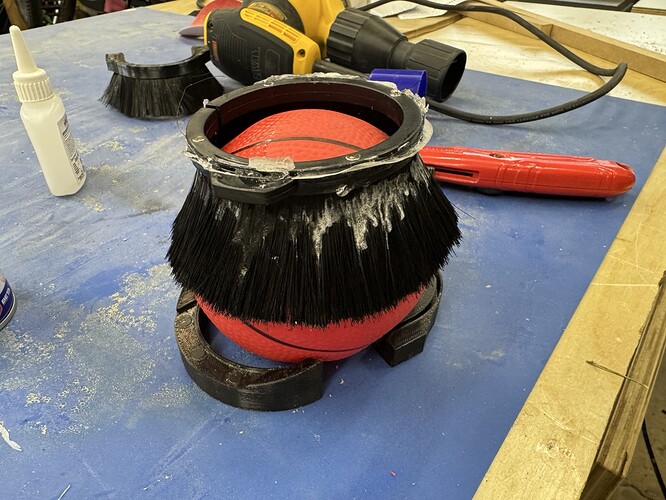

Ok possible solution, placed the bristles and ring on a ball to splay them outward, then superglued around the top. Seems to work so far, tool changed without issue.
OMG thanks! I’m going to give that a try.
I went back and added CA glue to the inside around the top of the bristles. Running a job now with 4 tool changes and no issues so far and dust collection is the best it’s ever been. Splayed out bristles is the way to go!
