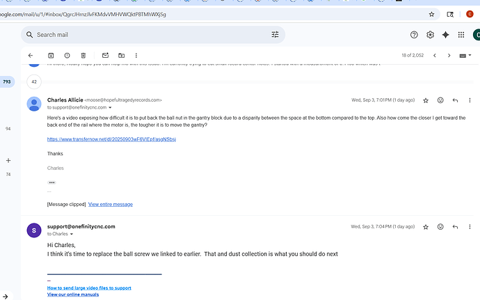

I honestly didn’t want to buy parts and still not solve the whole issue. I ordered 2 ball nuts after being told that it was the problem. My stepper motor, the ball screw that bent… everything took a beating because of that defect rail. If it can help you, my machine is a 2021 3rd quarter X-50 Journeyman.
Here’s attached the last exchange I’ve had with Support@onefinitycnc.com concerning that issue. I don’t want to blame anybody, I just want to get this fixed and get back to work. Can you please put a word for me in this situation? I will write back to Support@onefinitycnc.com.
