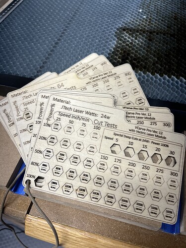

For years I have wanted a laser option for my OF Woodworker. So I went bigger than needed with the three-in-one 24-44-64 watt Jtech laser. It’s a lifetime purchase, only when factoring in my age! No regrets, the challenge of being creative in the CNC /woodworking world keeps you young.
It’s a bit of a challenge to multitask a new gadget, air, origin point, exhaust, and darn, which power level was that on? But, you will catch on.
Creating a set of “Material Cards” helps to develop feel for your laser especially if it’s a new toy for you. Attached is a set of material cards that has taken hours to make. It’s basically a remake from what others have done, only triple. Power levels and speeds are best estimates. Improvements are encouraged.
Will I make cards for every material? Probably not. But, as I move on to new materials, I’ll be at a good starting point for a simple test and a few notes.

Opps forgot the material attachment. I told you I was old!
24-44-64 Cut & Hatch Cards.crv (29.3 MB)
Very nice material test card design! I agree, learning new skills is a great way to stay young and keep your brain firing with project ideas!
Since upgrading to a 60W laser i’ve been exploring chaning my thinking from adjusting the feed rate to adjusting the power rate. For engraving i stick with 10,000mm/s ( about 400 inch/min ) and try to just vary the laser power level. 30% power works pretty well for me as a starting point. To try to compensate for the S-curve acceleration on the BuildBotics controller, i’ve found I get the most consistent results engraving using “image” modes in lightburn with 3-5% overscan. That helps prevent the corners or ends of lines from burning darker than the middles where the machine has accelerated up to speed.
