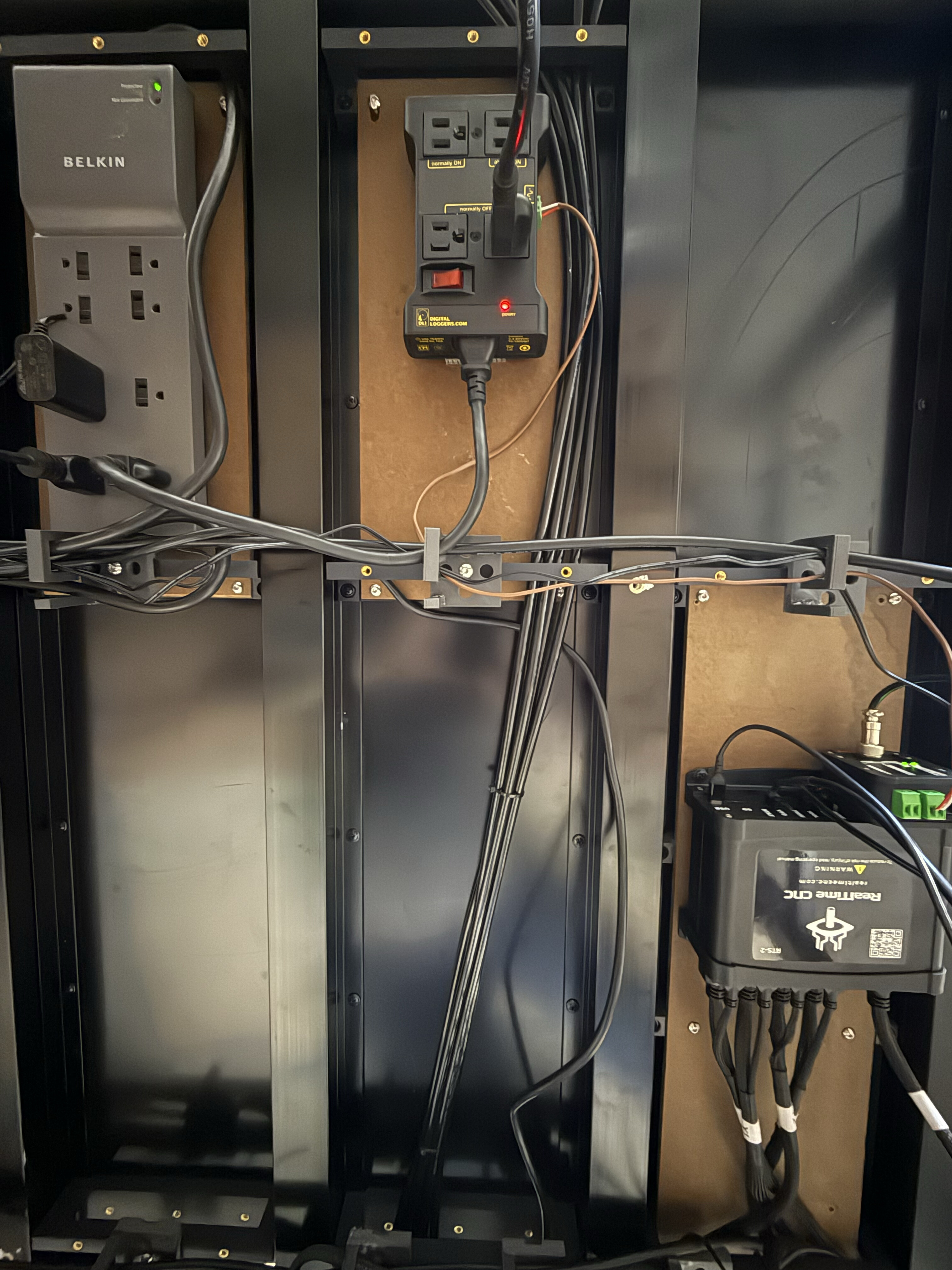

For what it’s worth I just used some solid core 2-conductor bell wire (basically the stuff you use to hookup a thermostat or (not so oddly) a door-bell.
I’m using it to turn the vacuum table on and off from the touchscreen.
Works well enough, I’d prefer a solution that gave me all four outputs like @tjp52’s project, though I’ll probably have to take the mini apart and reverse engineer it so I still have the connections for automatic tool changer.

That’s ok. It will give me something to research. In this case, the unit provides the current and the relay. Any switch that completes the circuit between the two poles turns on the power. A different approach than your relay. I’m guessing I’m looking for something more like this: Amazon.com: Lowell Manufacturing RPC-20-SCD 20A Low Voltage Remote Power Control with Surge Protection, 6' Cord, 1 Duplex Outlet : Electronics
Thanks again for the valuable information you provided.
Roger
Yes, and it’s been working great for a long time. There is a simple switch on each blast gate - when you open the gate it turns the switch on, close the gate and it turns off. It turns out the io port on the Redline motion controller duplicates a simple switch on/off when you issue the M8/M9 commands.
The only problem is the supplier, Penn State Industries, stopped making the wired version so I can’t get the 220v version. They only have the wireless version now.
I started with that plan. Unfortunately, it’s only rated for 10 amps. It won’t work with my 15 amp dust collector, and there’s no 220v option. Thanks.

this is my version of this project i just use
one of the,relays

Hello have everything connected like in the picture. I’m able to control my vacuum with the o/1 switch on my redline controller. How do I get it to turn on and off automatically?
The way I do it is in the post processor which can be edited with a simple text editor. There you would just enter the appropriate ‘M’ commands to turn on/off your devices. If your using Redline CNC controller with the HMI, there’s also a convenient way to manually control your devices. I’d send you a copy but I’m currently out of town for all of October.
