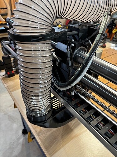

I like that idea. It’d also be cool to watch the chips fly up! I may incorporate that if I can’t find something else. Just have to figure out a convenient way to attach the nighthawk boot fittings to the clear PVC. I will routinely disconnect the hose to clean up bits here and there when the machine isn’t operating; it’s one of the things I like about the nighthawk boot.

I use the dust boot with a 4" hose and there is no problem. It is great with the saw dust. I have been using it for almost 2 years.
See following pictures it is great.
I using a bungee cord from the ceiling with an eye hook. When I turn on my dust collector it takes the slack out of the hose. I am using a 4” with a 3hp dust collector for my shop.
I’ve posted a couple different designs. One for the Makita router and then one for a spindle. Not sure how to locate them on the forum off the top of my head. Mine are 3D printed. Let me know if you are interested and I will see if I can find the link.
I went with a rear mount. I bought the files from uglydog and printed them on my Bambu. I added a few support details of my own design and suspended the hose from above. Here are a few photos. Hope this helps.
Jim
I appreciate the offer, Rex! But I was actually able to find the thread you posted. I took a look and that helped guide me.
I ended up swapping out my dust collection hose based on your recommendation. What I had been using was a bit more stiff and wouldn’t take up the slack when the DC was pulling. Good call!
I designed and printed a little mount that holds the hose directly in front of the spindle but still allows it to be removed to manually suck up anything thrown out from the boot. I used the bungee suggestion from @egantner2 but then also tied that to a small gantry made from some scrap unistrut and a dolly bearing I had laying around. Works a treat.
I appreciate everyone’s input. It helped guide me to where I needed to be. Thanks!

That’s the nighthawk dust boot. I’ve never had an issue with it and the performance has been great. It can be somewhat of a pain to change bits as it’s fixed to the spindle itself. That requires that it be loosened, raised, then the bit can be removed before lowering it into the right position again. But it’s a minor thing. First and only dust boot I’ve owned, so I don’t have a lot of insight beyond just that one.
The new Nighthawk is different the bottom is held on with magnets and just pops off for tool change.

I did and I like it a lot but there’s one issue for some but not me at this point, it bolts to the Z slider in one position, I need the brushes to be within 1/4" of the spoil board at the lowest and clear the ATC at the highest position. This results in a loss of max material height under the Z slider as the Boot bracket extends below the bottom of the Z slider, offhand I can’t remember how much but can measure if interested. I would still but it again knowing these things as it works very well and very easy to set up.
