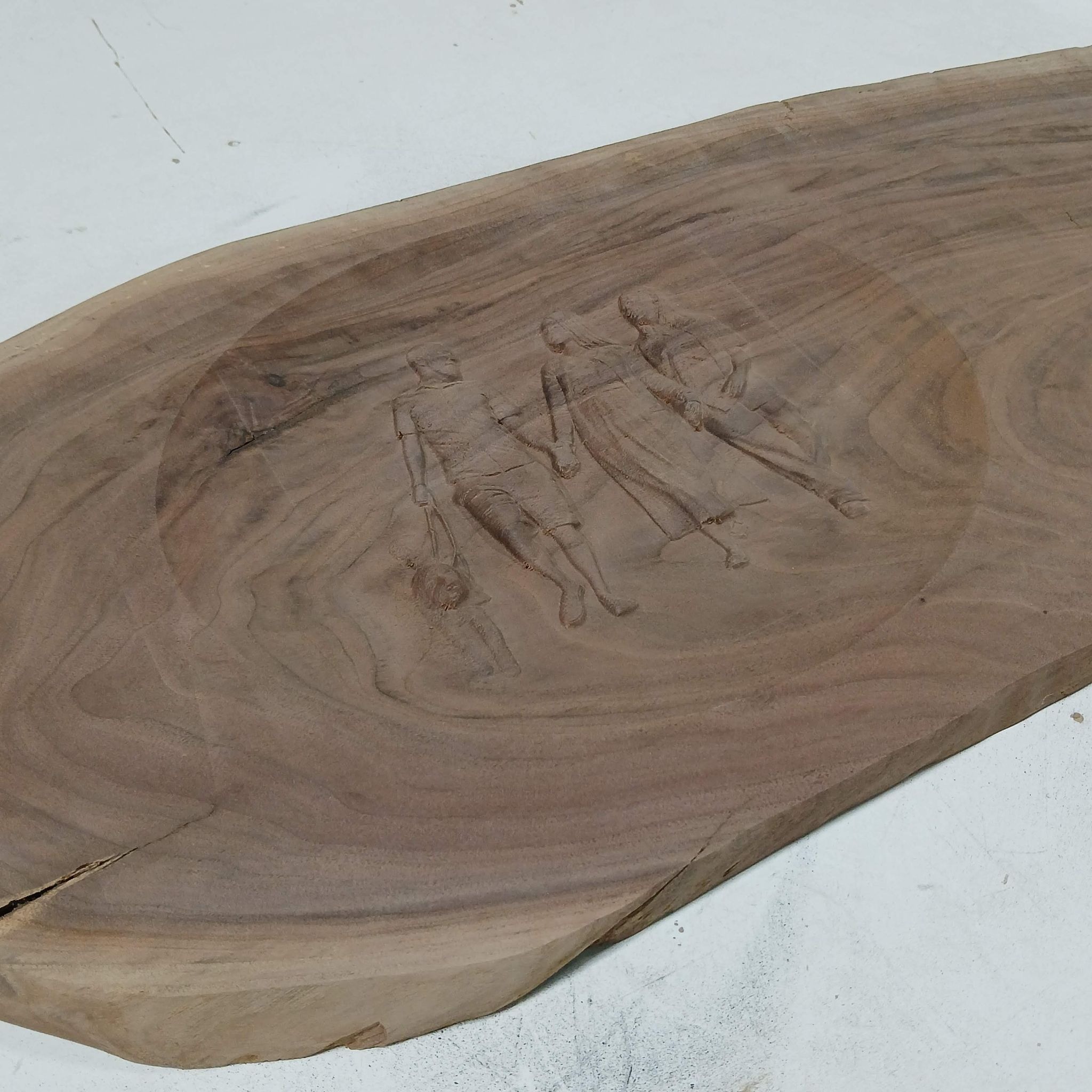

So I have been playing with EasyCreate for a few months now and I am getting better but still need lots practice. I am trying to get better with creating a model from a photograph. I have tried twice but not real happy with the outcome.
I am using Vcarve Pro the latest version, and a 0nefinity CNC (the original BB controller on a woodworker 32x32)

I used walnut with this project and it seems to “hide” the model.
4. Is there an option to tell easycreate what size model I want from a photo? The models I created ended up almost twice as large as I needed. (did I lose more detail when I reduced the size of the model?
Some of the things that I have learned, unless I am completely on the wrong track.
It seem that easycreate will automatically add a base to the model, and when I try the “replace below” option it removes some of the model. A base on the model isn’t bad unless you want to combine this model with a “dish”, because then it leaves lines in the dish.
I was able to remove most of these by using the option on easycreate to scale the heights along the x and y axis and adjusting only the very edge of the model. But I am not sure if this is reducing some of the detail.
Here is the photo I used and the finished carve. I did this for a friend and they thought the carve came out really good. (I can see where it could have been a lot better)
Here is the picture I used.
I used windows photo editor to remove the background.
