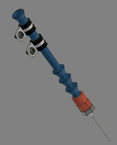

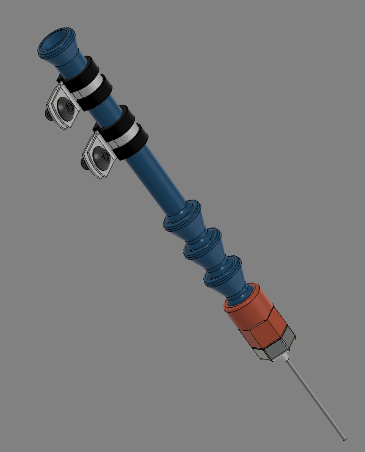

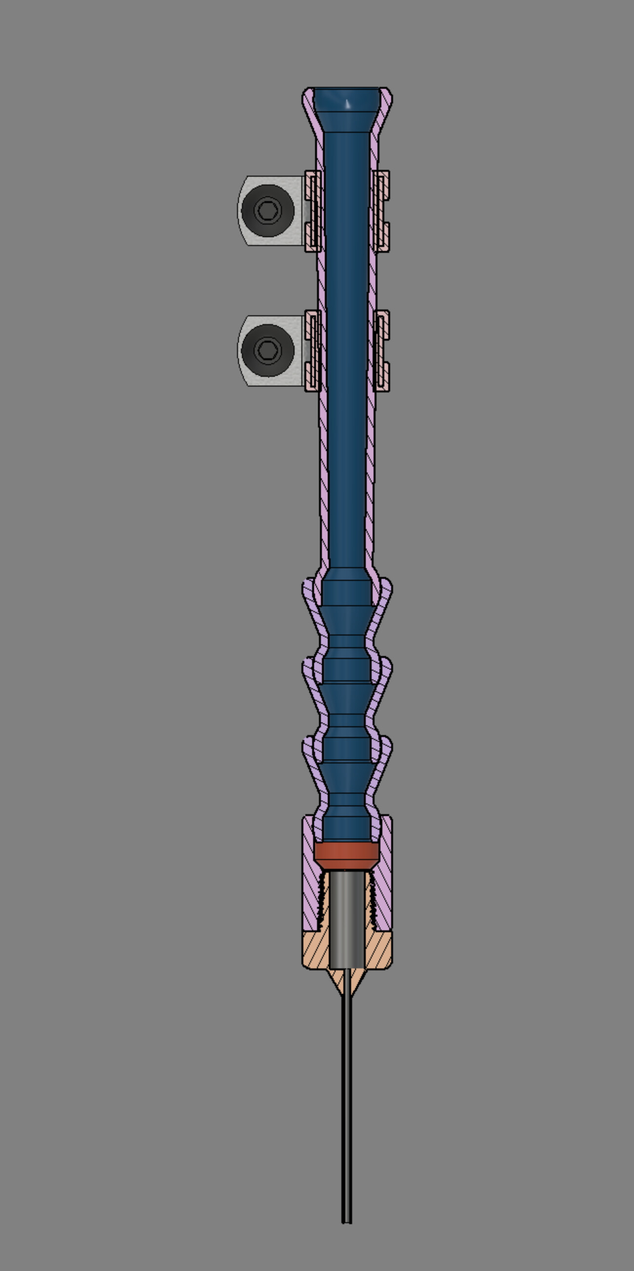

Air blast nozzle off the McMaster shelf
One thing I really appreciate about CAD is the ability to put things together virtually and confirm it all fits. Finding a clamp with the right ID for the Loc-Line hose was a bit of trial and error.
Parts list with McMaster part numbers:
  • 5446K74 Precise Airflow nozzle w/ 1/8" NPT
  • 3177T11 Snug-fit Loop Clamp
  • 92095A207 M5 x 8mm screws
  • 10095K64 Loc-Line 1/8" NPT to 1/4" hose
  • 10095K141 Loc-Line 1/4" straight piece
