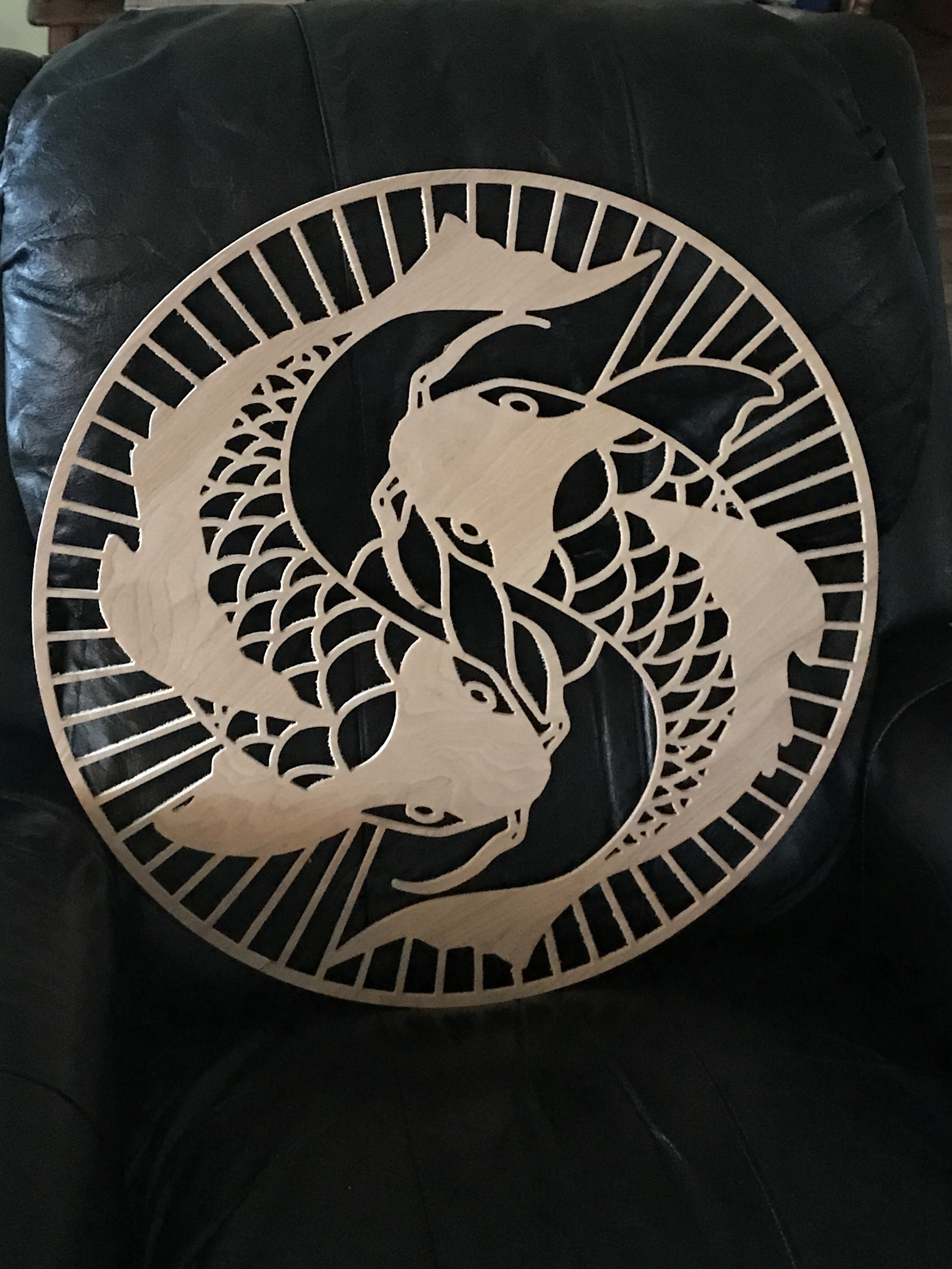

Just a quick shoutout to the Onefinity team for all their hard work on the design, QC and unparalleled customer service.
I am new to CNC but I did my research for few weeks before deciding on the Onefinity and I am not disappointed.
Below is my first cut, aside from going a little deep on the Z which I need to figure out I am very happy with the results. Happy new year to everyone.
Looks awesome! Happy New Year!
That’s awesome! How did you manage the little pieces that came loose inside the pattern? Did you pull them out as the carve went on?
Yes, removed them as the job was running. The double sided tape secured the overall piece but it was useless on the cutouts
I agree and I had tabs for the overall piece but considering the number of small pieces it was going to take a lot longer than I am willing to spend on it :grin:
Short of a vacuum table I can’t think of anything else to hold them without a lot of prep tape/glue or post cleanup tabs.
Similar piece today with good results
If everything is dialed on really well you can leave a super thin layer and sand through it after
