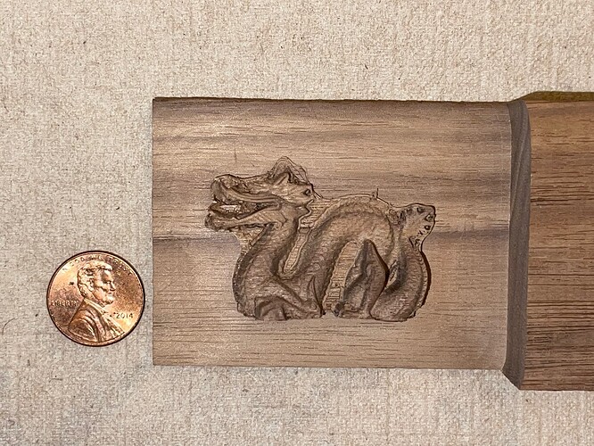

I like 1/8” tapered ball nose. Also, tool marks are a function of stepover. The smaller the step over the smaller the tool marks. You can get good surface finish with a 1/4” ball nose with a 10% step over.
What we trade is sanding time for machine time. For instance, I did this with a .25mm tapered ball nose. I forget how long it took, but I seem to recall a hour at this size.
