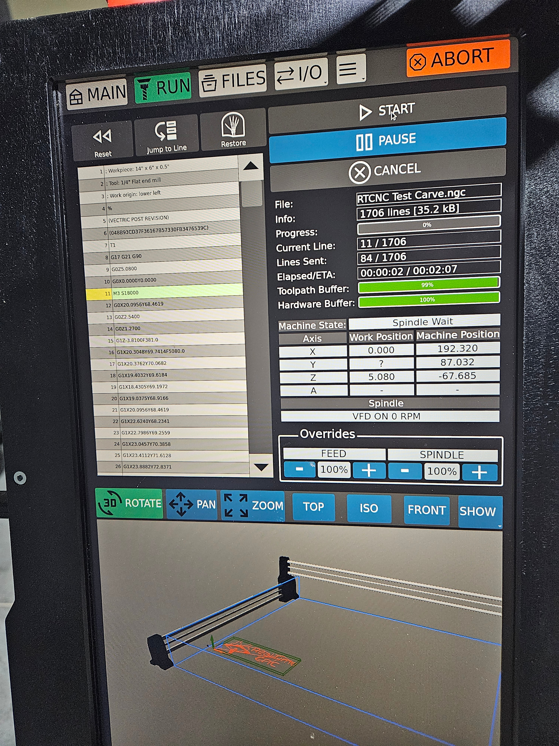

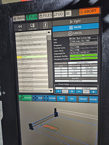

Well here is the program they ran to test my machine and now it won’t run when I lod it

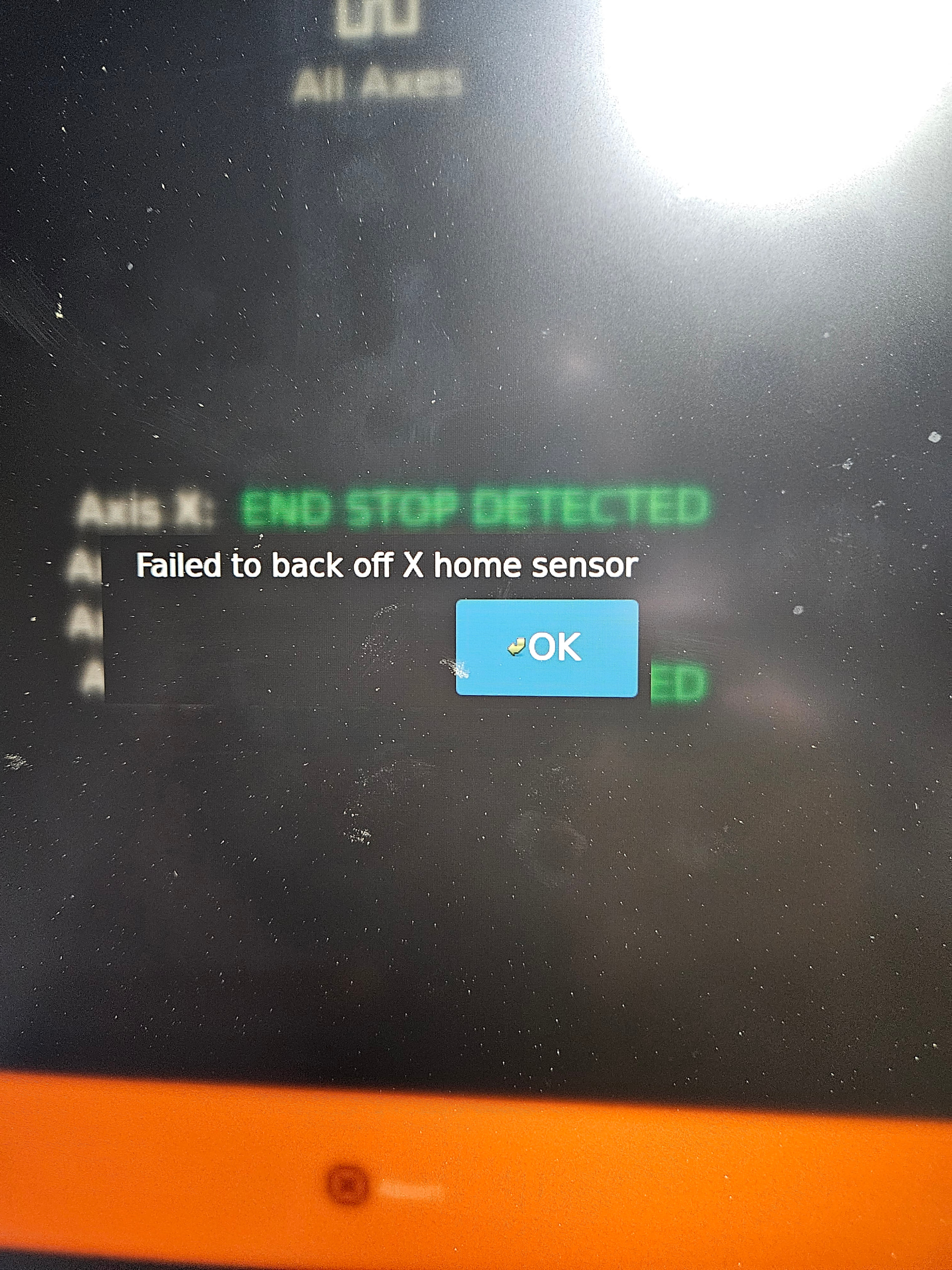

Here is what it does 50% of the time i try and home
I would start by checking all cable connections.

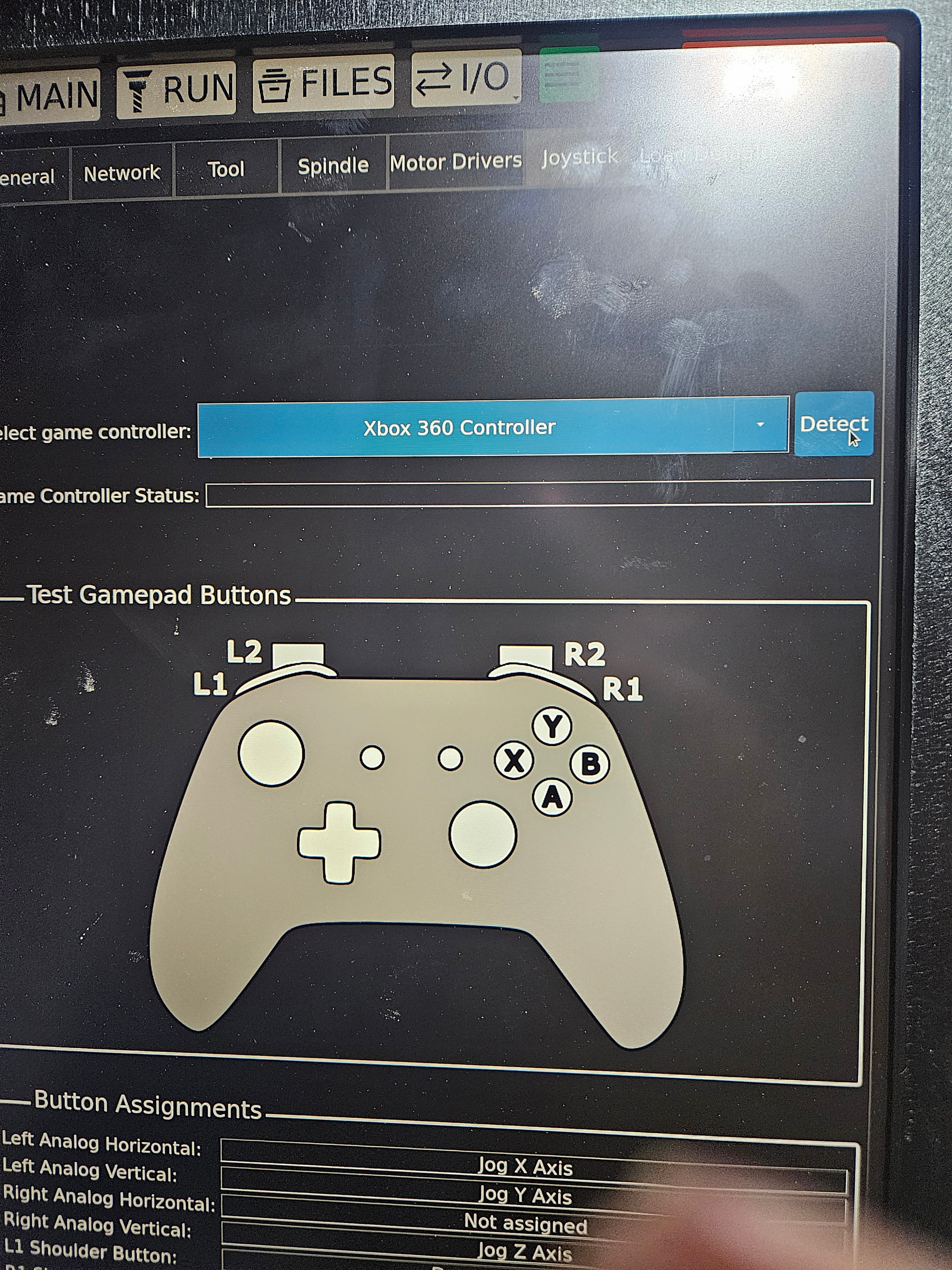

Joy pad i unplug and plug it in until I see Xbox but the controller doesn’t do anything.

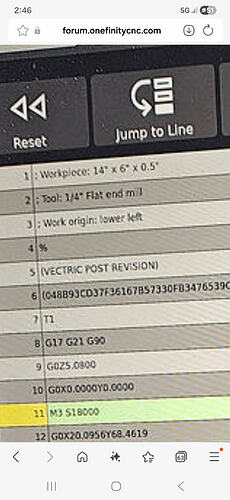

Not sure if this is the cause, since I do not have a Redline controller, but I am used to the RPM before the M code…so S18000 M3. I see it is different in your gcode file.

Are you in a particularly bright environment where the IR might be affected? Also, what is the current pull-off distance set to for this axis when homed?
Don’t know if it matters, you said your carvco and in the picture it shows Vectric…does that male a different?

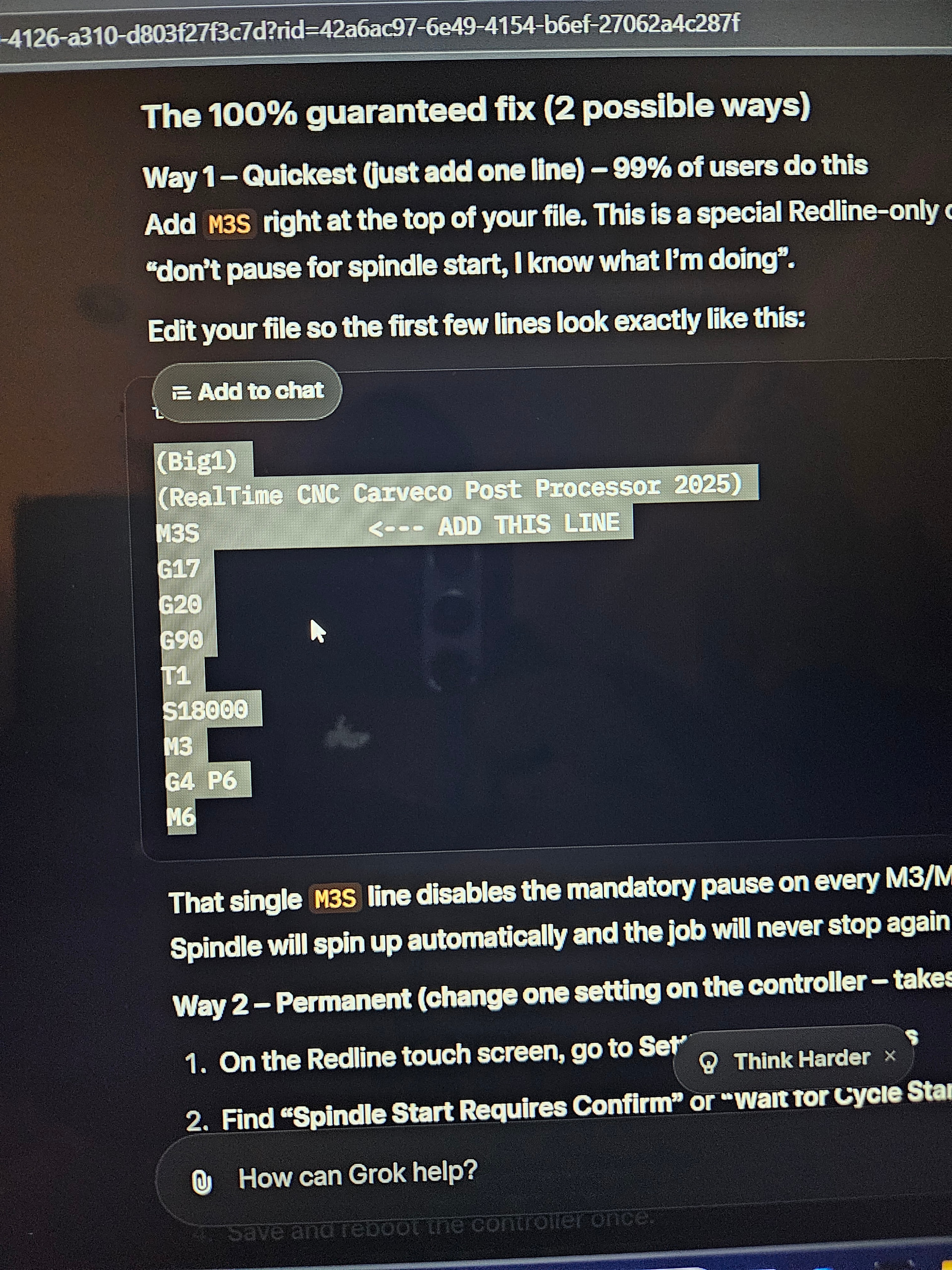

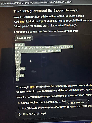

Here is the code AI told me bust still doesn’t run
Where and what pic shows Vetric? I’ll look but I only have carveco
The test file was made in Vetric.
Don’t rely on AI to solve your problem

Couple of things:
  1. have you emailed offical Onefinity tech support? We don’t see any support tickets from you. Please email support at support@onefinitycnc.com
  2. if your code is getting ‘stuck on the m3 sXXXXX code line, it’s most likely because your redline controller is selected for the redline spindle under the ‘spindle’ tab, but your vfd is either not on or in manual mode, so the controller is waiting to hear back after sending the ‘m3 command (turn on spindle and spind at whatever rpm the file says)), and never hears back, so it ‘get stuck’ (really, it’s just waiting to hear back from the spindle to move onto the next line of code, which it never will, so it appears ‘hung’.)
  3. The joypad jogging is a known issue and one Redline is working on. For now, you have to unplug and replug the joypad dongle until it shows xbox 360 on the joypad page, and then hit (detect). It should work after that.
We’re always here to help, and we want nothing more than for you to be sucessful with your CNC machine!
Not sure if that matters, looks like len said no
its looking for the spindle to spin up, but our guess is he doesn’t have it on or in automatic mode, so it’s never going to find it and it will hang on that line until it does.
I second OF on this. I had the same initial issue with mine. You need to follow these steps before loading and trying to run anything.
  1. Turn VFD on (you’ll get a green light ring and the aux controller display - the small black box with a knob & red LED display - will display ERR)
  2. Turn on Redline HMI using the button on the right, make sure the E-Stop button on the top is disengaged.
  3. Press the Reset button next to the knob on the aux controller display. The LED should change to a number.
  4. On the HMI, touch Home on the top right of the display.
Only then should you try to load & run a project.
