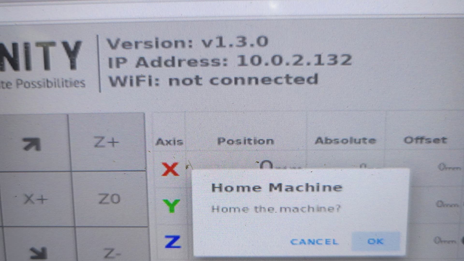

I could absolutely be wrong — it would not be the first time. But I feel the most likely reason he is not receiving a valid IP address from the router over DHCP is because there is not a working link between the controller and the router and that we should start by attempting to verify and diagnose the connection, as opposed to burying him in technical jargon.
For reference, here is a photo of my controller interface when I plug the Ethernet cable into an empty switch.
All I have to do to get a valid IP is to provide a working connection to the DHCP server.

Hey everybody, there is some news. It appears that the reason I got the 169. series ip address is for exactly the reason Matticustard said.
So, here’s what happened.
I plugged the powerline connector into several different plugs in my garage, and I eventually found one that connected the Onefinity controller at 10.0.0.154.
There is only ONE plug in the garage that does this.
Now for the weird part… If I have WiFi disabled when I plug into this one ā€œgoodā€ plug, the controller defaults back to 169.254.193.91, but if I enable WiFi, even though the controller is not connecting via WiFi, it chooses a good 10. series address, and it works.
I’ll take it, I don’t have to understand it, as long as it works.
