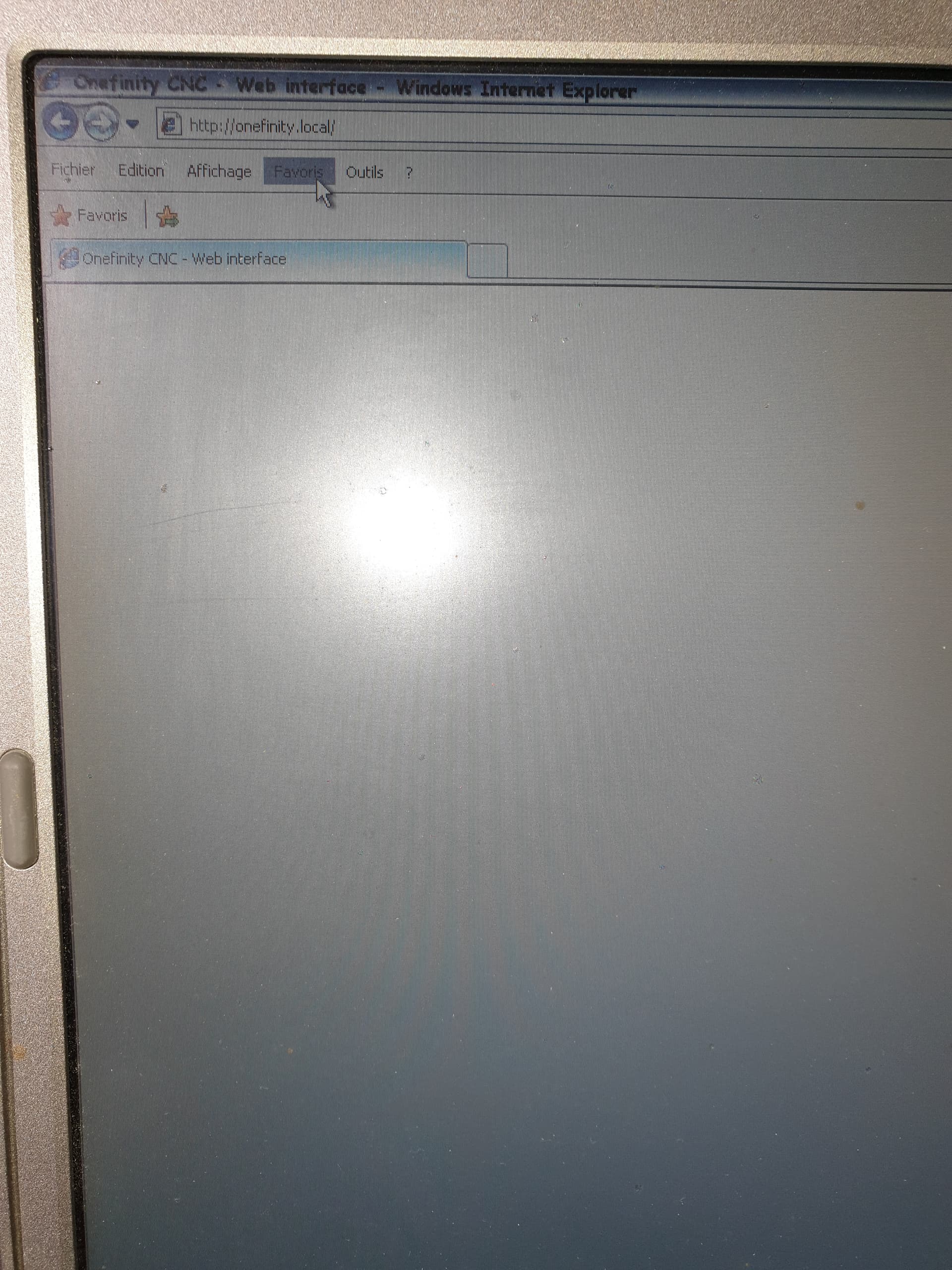

I am a beginner i try a cnc for the first time.
I haven’t found answer in the forum.
I try to connect my woodworker with windows xp.
The wifi is off.
When i put http://OneFinity.local in internet explorer, i have this page.
Could you help me?
Thank.
Salut Fred11,
plutôt ancien ton navigateur :slight_smile:
The fact that the page title was successfully transmitted suggests that the web browser is for some reason not able to render the page
Your operating system is over 20 years old, its support ended 2014. You could try to install the firefox web browser. HTML has evolved a lot in the last twenty years.

What you need for the “Onefinity.local” addressing to work is that an implementation of zeroconf is running on your computer. On your older computer from which you showed the photo above, this was obviously the case, since the page title was transmitted successfully.

This looks like the HTML on the Onefinity Controller page is too recent for the totally ancient web browser. But as I already said above, the link-local connection works with this computer, as it already successfully submitted the HTML page title before. But you should not try this with such an old web browser.
