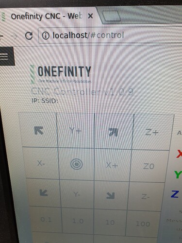

Hi Atroz
I haven’t ip adresse
Hi Tuvix72
I already tried with firefox the result is the same with chrome : nothing
That’s what I meant with the explanations above. Your Windows computer is able to make the connection, but something else does not work.
Do you have Onefinity Controller and Windows computer connected directly with a CAT5 or higher cable?
Hi Aiph5u.
Yes the controler , the cable cat 5e and my pc
Did you turn off WiFi on the Controller?
Yes Aiph5u it is disabled
Hey Fred11,
if you
  • first unplug the CAT5 Ethernet cable, then
  • on the monitor directly connected to the Onefinity Controller and the keyboard, you type <ctrl>-t and then <ctrl>-c (which opens a CLI), and then you type:
sudo -i
tail -f /var/log/messages
(this should show the syslog)
  • and now you plug the Ethernet cable back in, what new messages appear on the syslog?

Hey Fred11,
Your screenshot shows that there successfully is an Ethernet adapter recognized at the end of the cable.
What is shown when you enter “ipconfig” on the windows pc?
What is shown when you enter “ifconfig” on the Onefinity Controller?
type “exit”
I don’t know what could help you, but what comes into my mind are things like you could install nmap and run it with nmap -p 22 169.254.0.0/16 which would finally somewhen show up the open ssh port of Onefinity Controller (if the Controller is there), or that now you know why the Buildbotics Controller has a little display on its case that shows its IP address :slight_smile:

There you have the IP address: 169.254.76.123. Type that into the web browser on the windows pc (or ping 169.254.76.123 on cmd.exe).
Problem remains that you need the monitor on the Onefinity Controller to get to know this address (as long as Name Service Discovery for addressing with “onefinity.local” does not work on the windows pc)
