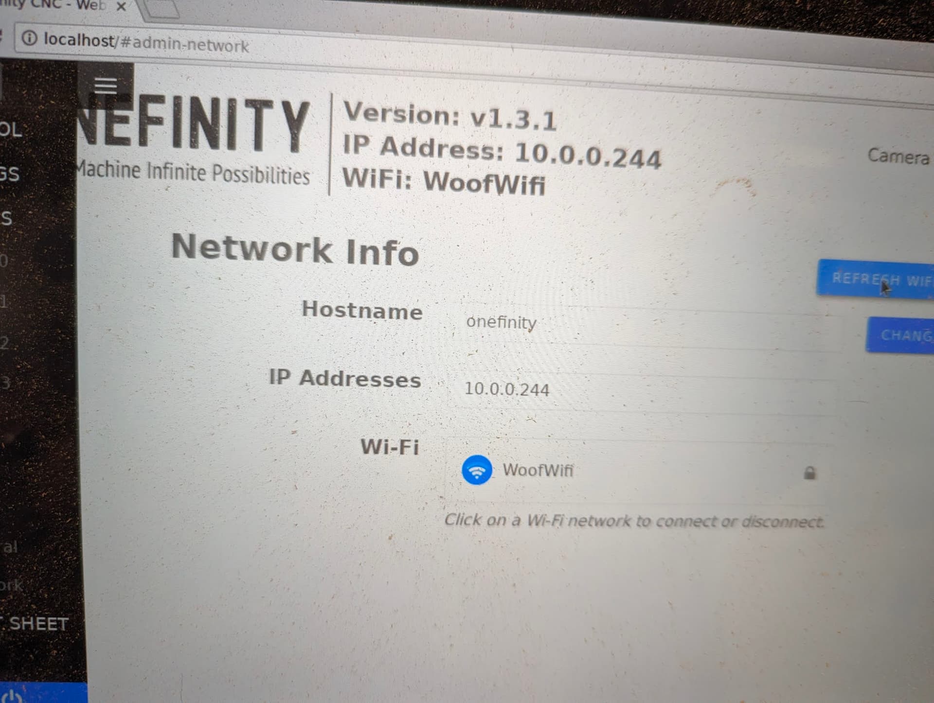

My understanding is that I should be able to remotely view and interact with the controller by going to either onefinity.local or its IP address as shown on the screen. In both cases, it doesn’t work, browser just spins. The touchscreen shows that it’s network connected, and gives an IP address. The computer is connected to the same network. Is there something else I need to do to enable?
How is your controller connected to the network (wireless or wired) and what is the IP address you see on the controller screen?
Wifi. Address is 10.0.0.244. When I point the browser at that address, I see the title “Onefinity” come up, so I know it’s hitting the device, but the page never resolves.

Thanks for the feedback. I moved the mesh router two feet from the controller. I am also sitting right beside it. A ping doesn’t resolve. We are on the same network,
