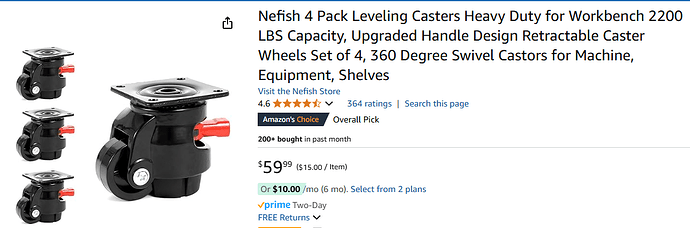

I used levelling casters from casterhq.com
This is the third set I’ve bought from them. They’re also on my planer and jointer. You essentially get casters and locking feet in one. The reason this worked well for my cnc table is that the torsion box top was way stiffer than the base, but having the levelling foot allowed me to raise the base corners independently. I was able to easily level both axes. If I need to move the machine it is easy to get the top level.
Good luck.

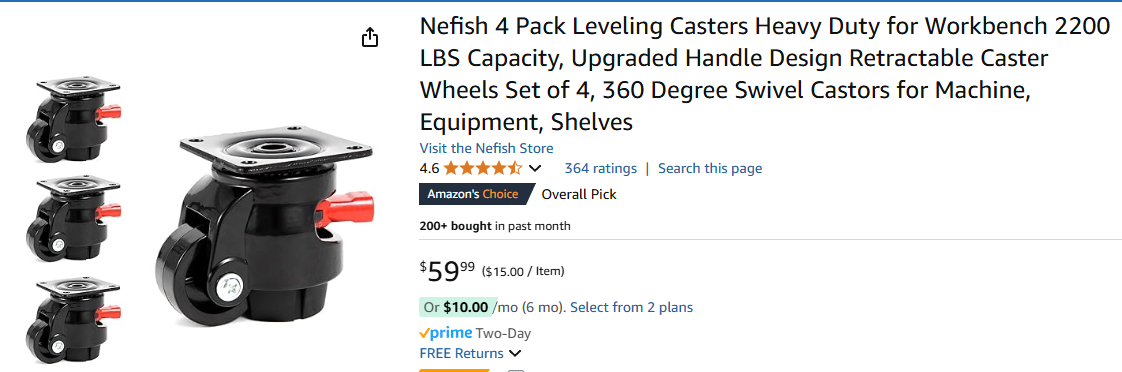

Can you provide the model number of the ones you have used? Do they have the ratchet option?
thanks.
you can find them on Temu I got them for about 50 canadian they are called Retractable Workbench Caster Wheels and Step-Down Locking for Workbenches
I made the 4x6 table for my journeyman, lifts it and spins like top — highly recommend, ability to move the table if you need and stability of solid feet when your working.
I use these on my Workbench and they have worked very well…ratchet the wheels down for mobility and up for stability.
