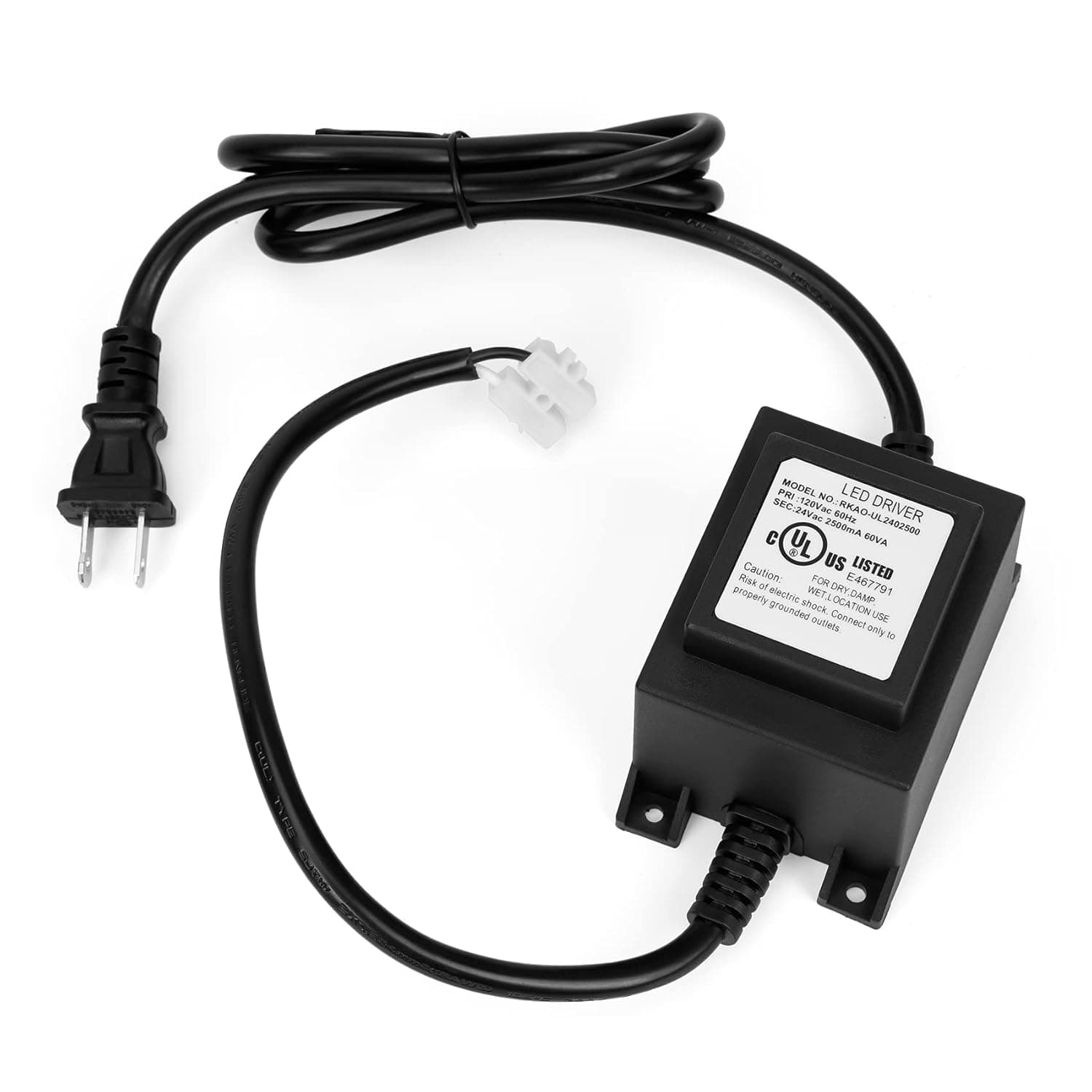

I decided not to take the chance with this relay. So I will install a small enclosed 24 vac transformer under the bench that plugs into the Elite power supply vacuum outlet. The 24 vac will then operate a small (24 vac coil) contactor HP rated for my dust collector. I used 24 VAC to avoid having two separate 120 vac sources in the same enclosure.

I have done my set-up with the above enclosed transformer to be plugged into the Elite power supply outlet normally used for a shop vacuum. The transformer 24 vac output controls a horsepower rated motor contactor in a small enclosure. The contactor then powers the dust collector from its own separate 120 vac circuit.
Although I am waiting for my Elite upgrade to come shortly. I have wired it all up and tested it out. Should work fine for me. The small transformer is mounted underneath the bench nearby the Elite power supply. A low voltage cable from the transformer then runs over to the contactor enclosure mounted on the wall with the separate 120 vac circuit powering the dust collector. I also added a manual override switch so I can operated the dust collector separately from the Masso controlling it if needed.

I have been operating this for awhile now. It works very well for me. I would not change anything. It’s completely automatic. Dust collector comes on right after the spindle comes up to speed and shuts down before a tool change and then starts up itself for the next tool path. You can also manually operate from the Masso itself.
It’s a single 120 vac source. I have a dedicated line from the breaker panel to a wall switch which then feeds a duplex outlet right beside it. The dust collector then plugs into the duplex outlet. The contactor is simply connected in parallel with the wall switch (two wires back to the wall switch). The contactor coil is a low voltage 24 vac which is wired back to the 24 vac transformer mounted under the CNC bench. The self contained transformer as depicted above plugs into the router socket of the Elite power supply.
I went with this method so as avoid multiple 120vac sources for the dust collector and to avoid running another 120 vac line from CNC bench to the Dust collector/wall.
