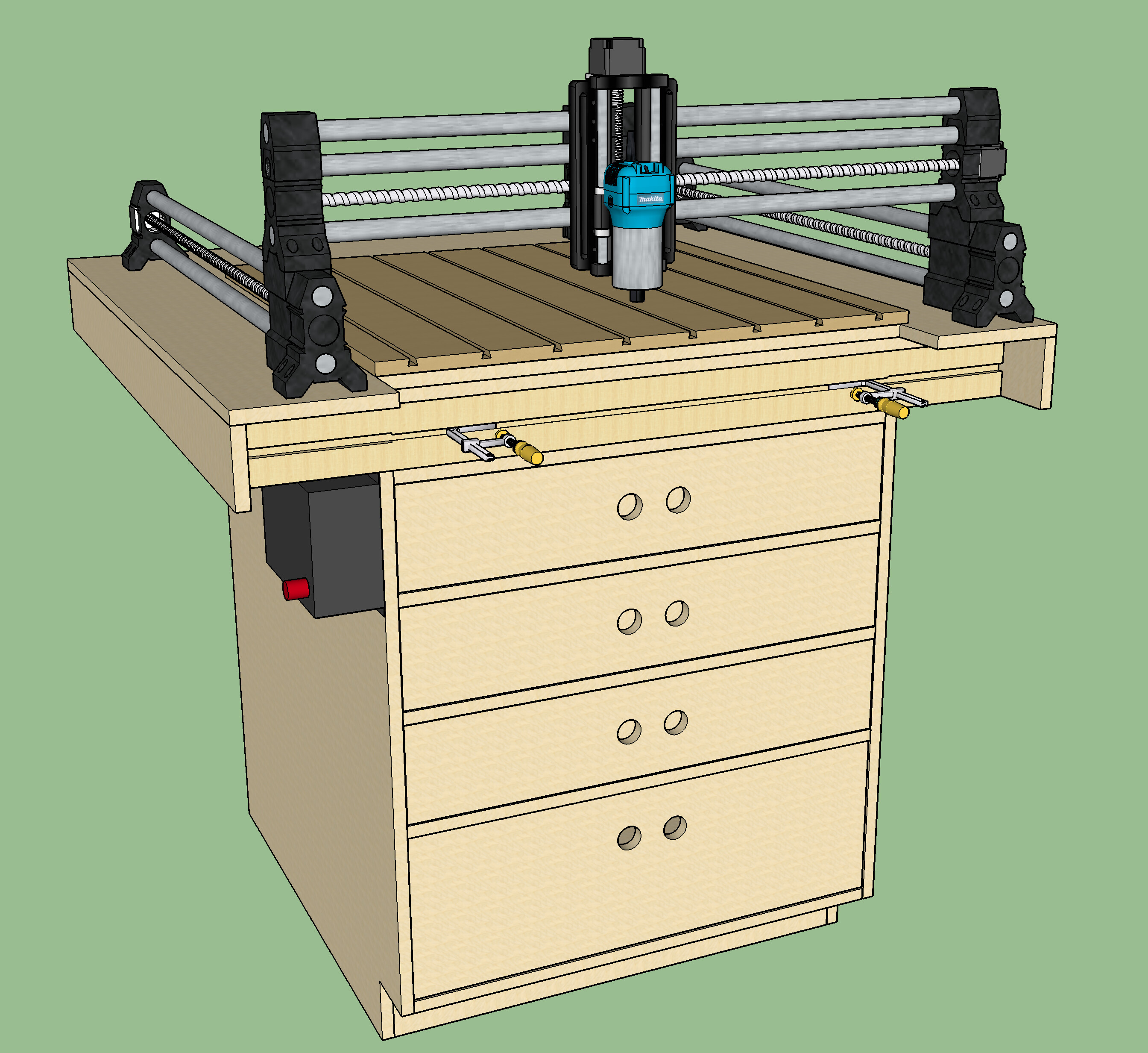

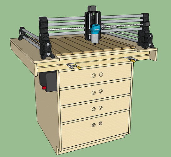

Getting ready to build my CNC Cabinet. Expecting my 1F Woodworker end of March. This is my umpteenth iteration of this design. The top is 48" x48". Cabinet has 30" x 20" deep drawers. Cabinet is 36" deep and should accommodate enough space for water coolant container in the back. Overall height is 42".
There is a cutout in the front to accommodate vertical clamping. I’m planning to use dovetail clamps on the front and the waste board design uses dovetail fixtures.
Looking for comments/concerns/suggestions before I start on this.
