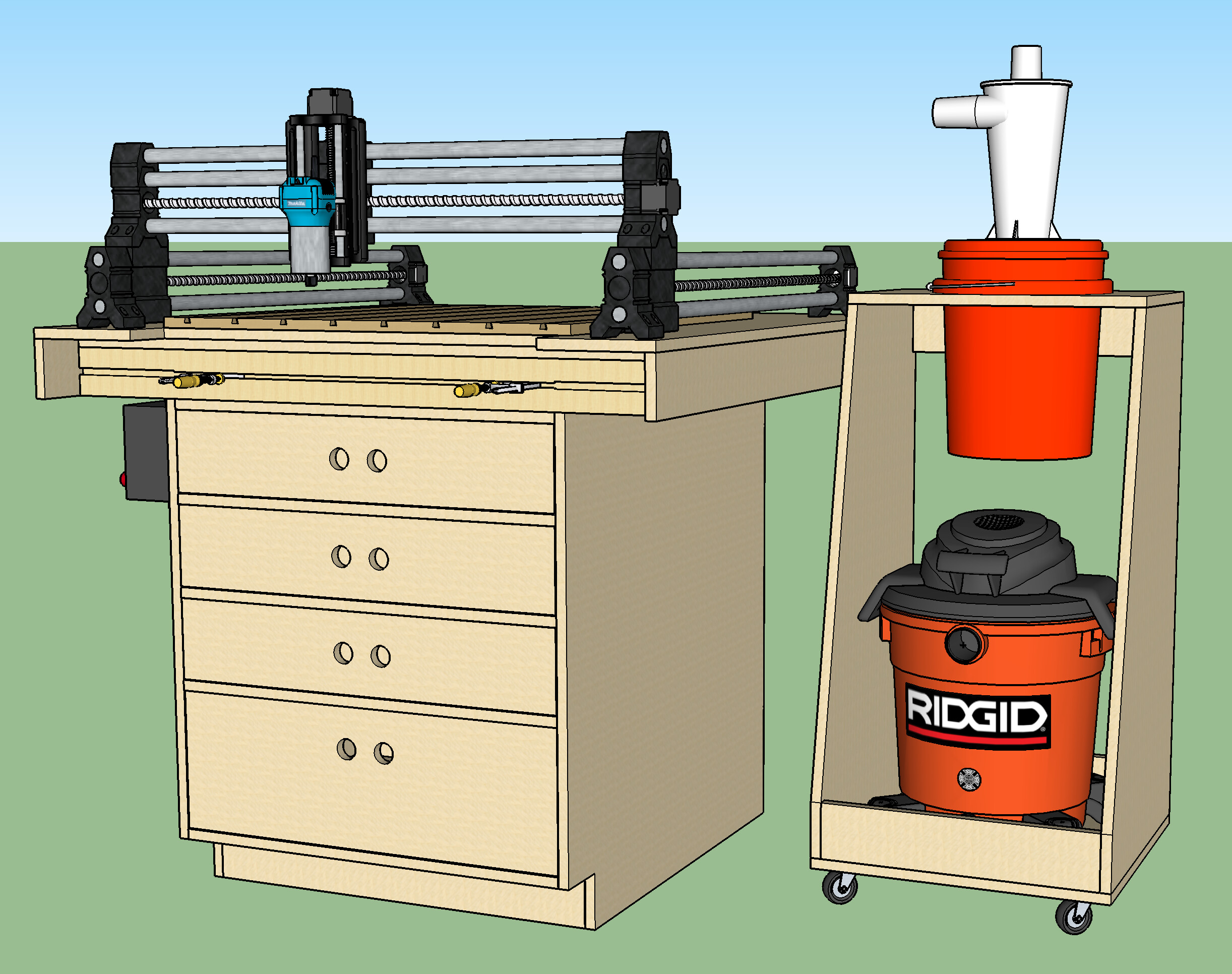

Getting ready to build my CNC Cabinet. Expecting my 1F Woodworker end of March. This is my umpteenth iteration of this design. The top is 48" x48". Cabinet has 30" x 20" deep drawers. Cabinet is 36" deep and should accommodate enough space for water coolant container in the back. Overall height is 42".
There is a cutout in the front to accommodate vertical clamping. I’m planning to use dovetail clamps on the front and the waste board design uses dovetail fixtures.
Looking for comments/concerns/suggestions before I start on this.
I like the compact design and the incorporation of vertical clamping. I do not have experience with this type of clamp, but I am thinking you would choose a hardwood for the front piece that holds the clamps? It seems like that will end up being a fixed piece, and not easily exchanged if the dovetail slots wear over time. Also, in your design, will the horizontal cabinet pieces - those which separate the drawers - be used to keep the vertical material you are cutting perpendicular to the work top? If so, perhaps recessing the drawer fronts a slight bit - 1/8" - would ensure your vertically clamped work piece will always be tight against these horizontal pieces.

Yeah, I’m a little nervous regarding the dovetail clamps so that front board will be hard maple and will be removable in case I need to. Good idea about recessing the drawers a little so that the horizontals can provide some alignment support.
I am thinking through how to use that back space. I am planning to use a dust collection cart that I just finished but it would be good to have a dedicated setup hidden away in the back. I’d need to cut a door in the side to empty the bucket. You’re right though, I might reduce the depth of the drawers a bit.

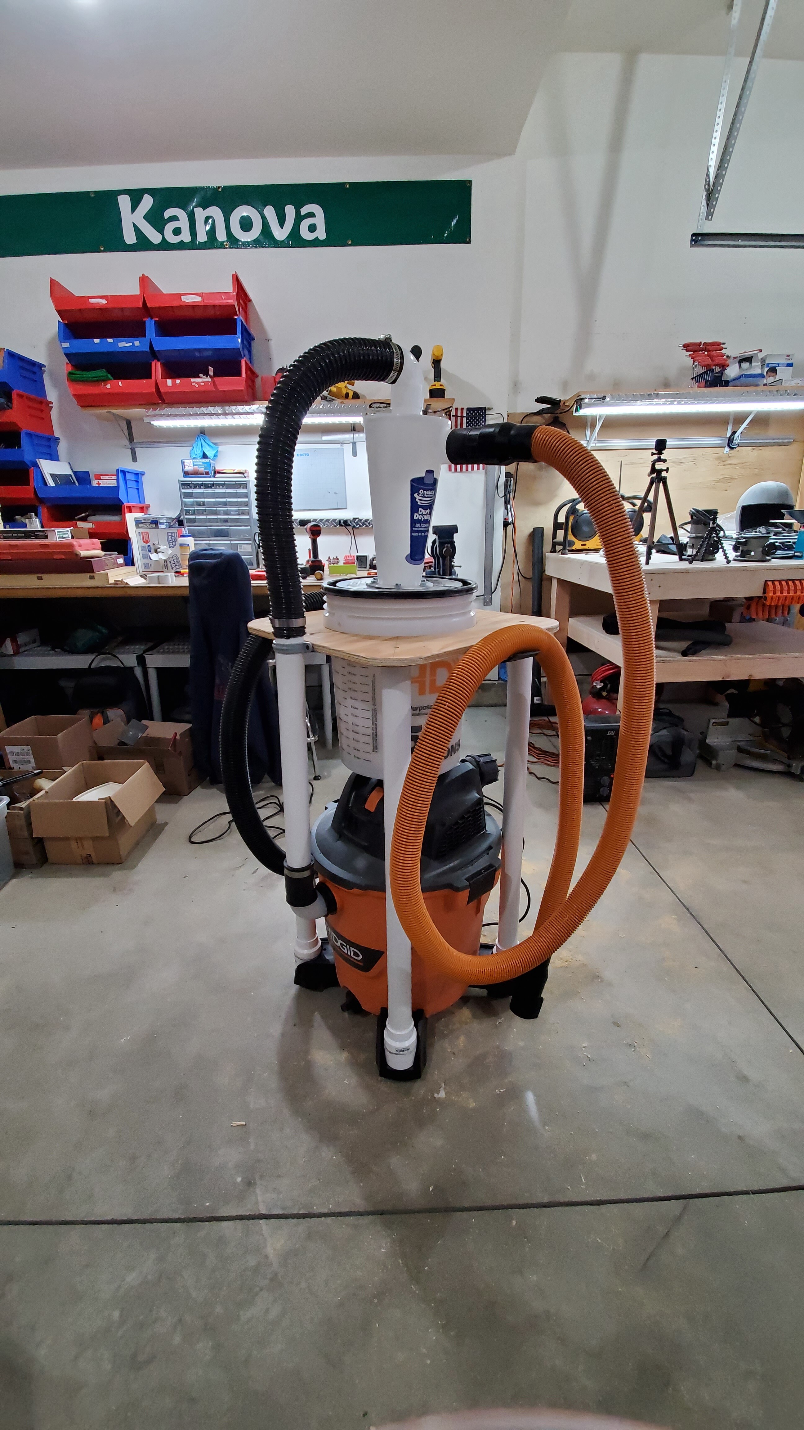

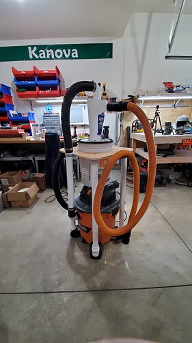

This is my initial plan for the dust collector:
Looking good!
Definitely go with the Dust Deputy setup. I built something similar and have filled the 5 gallon bucket a couple times while building my table and other projects. Nothing but a slight haze of super fine dust in the shop vac. I used a clear/opaque bucket to be able to see how full it was.

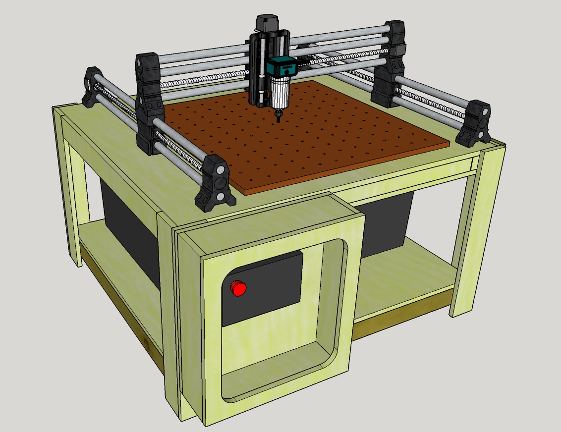

This table is about 42" deep and 44" wide. I mounted the controller in an enclosure on the front of the machine to keep dust out of the box, and to allow me to put a small light bulb to add some heat and keep the temperature warmer in the winter. I may drill a new hole and add a fan or something else for the summer months in my small, unconditioned garage. I don’t have everything set up yet, so no actual pictures to share! Hopefully I will get it all set up soon :slight_smile:
So yeah, I think a smaller table can be done, but you can’t get much smaller (footprint-wise) than this probably.
Allen,I like your design and the small footprint would work well in my shop. Enclosing the control box is a great idea.
