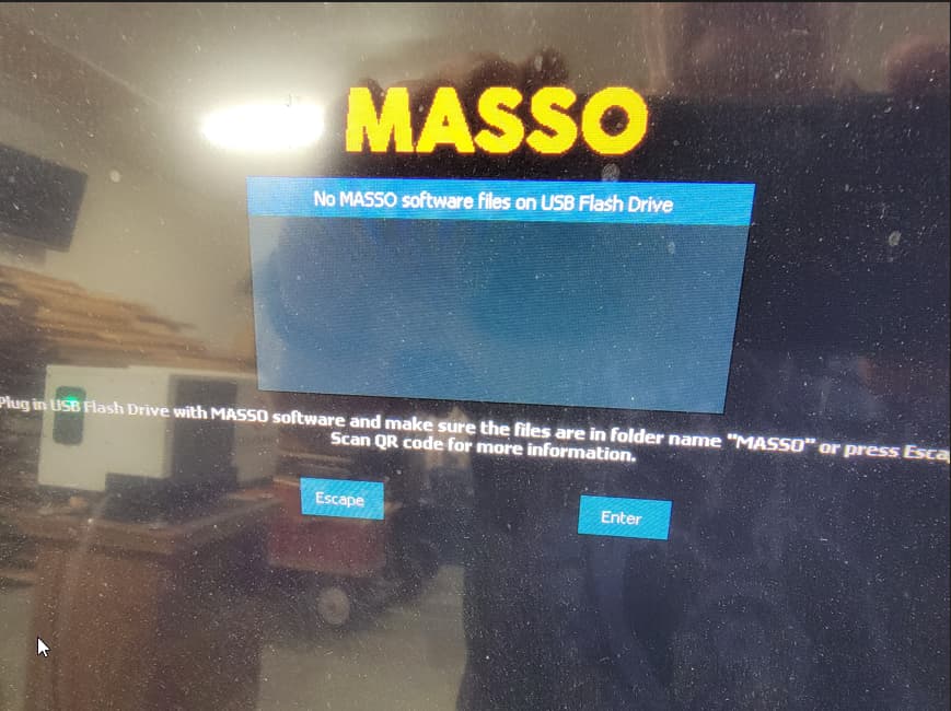

Files are loaded into a folder called “MASSO” on a USB drive. USB drive is inserted into Masso controller. When I tap the screen at boot up it comes up with no USB drive drive or no files found. I have seen both messages.
I hit escape and let controller boot up. After boot up I go to the F1 screen and go to load file. I then see the MASSO_5-Axis_Settings. htg show up. I haven’t touched or moved USB since I did the boot up.
Why are files not showing when I tap on screen during boot up? Has something been hardcoded into the MASSO controller for Onefinity machines to prevent this? Has anyone tried to load files by taping on screen at boot up of controller?

I can tell you nothing stops it from working as I have used the converter mentioned but for a Vectric tool database file into the masso file and uploaded on the startup screen.
The only issue I ran into was if you have a keyboard plugged in then the tapping on the startup screen doesnt work but simply unplugging it resolved that for me.
No keyboard plugged in.
Step one is getting files to load or even be seen on MASSO controller.
Screenshot below of of multiple files on computer and USB drive.
This is screenshot of what I see when tapping on screen when MASSO is booting up.
I haven’t removed the USB drive and this is what I see on the F1 screen.
After all this I decided to deleted the MASSO_5-Axis_Setting.htg file from the USB drive under MASSO folder and it still showed up when I got to F1 screen. The file was in the root director and under machine setting folder. I then deleted it from from root director and under machine setting folder and then it disappeared completely. I still never got a chance to see other files that were in all three locations. I done this with a USB that had only a MASSO folder with files in that folder and the outcome was the same.
I can’t even get to the tool library file which is what I am trying to do.
