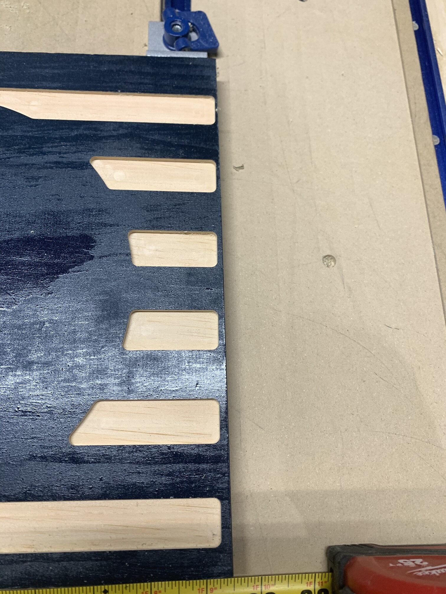

I’m attempting to carve out a USA/Navy flag; however, my alignment is off. As you can see in the pictures the stripes on my stock (11.5” x 21.5” x .75”) are coming out crooked. I designed the flag in Carbide Create and the lines are supposed to be .25” from the end of the piece on both sides. Before starting the project I used the touch prob to zero x,y, & z for a .25” down cut end mill. This is my second attempt and both projects came out crooked. I attempted the 2nd time because I thought my touch probe may have moved the first try. I watched closely on the second attempt when I zeroed x,y, & z on the probe. The probe didn’t move. Also, prior to saving the G code I changed the post processor to the recommend settings. I’m also running the newest version 1.0.6 with the recommended settings.
Why are my projects coming out crooked? Please help!
Kyle, I would first look at the machine to make sure your Y axis is running parallel to your T-slots. Then I’d recheck homing to make sure it’s fully homed on both Y axis sides, and make sure both Y axis assemblies are aligned in the front… making sure that one Y axis isn’t misaligned to the other one. This condition could cause what you’re seeing here.
Edit: In looking again at your project, it appears more like the wood piece wasn’t clamped square to the machine because it’s off in both X & Y directions.
another option would be to start with a full piece slightly oversized and let the CNC cut it out…that eliminates any issue with non square (relative to axis) hold downs, fences, etc.

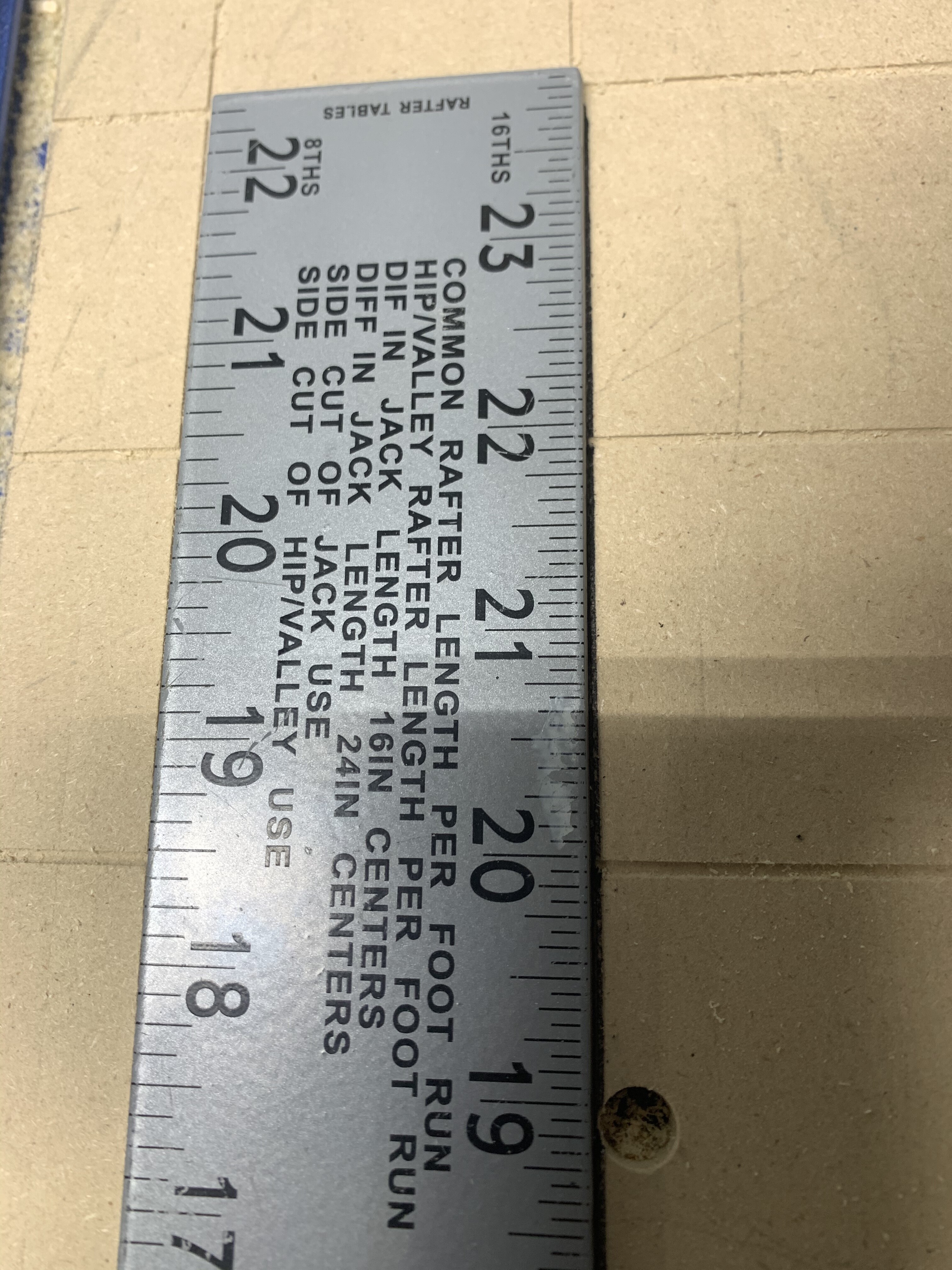

So I made a grid pattern exactly 2 inches square by 32” x 32”. I ran the CNC using a 1/16” end mill. Everything appeared to run fine.
I put a square on the table and the grid isn’t perfectly square. I measured the y axis rails and they are exactly the same distance apart from front to back and side to side. I attached two pics of the square on the table and attempted to highlight the grid with marker. As the square goes back toward the back of the machine the y grid line starts to get covered by the square. If I square up on the y grid line the x gets covered by the square to the left of the machine.

1st pic shows close up of square. 2nd pic shows square off on y grid.
Check to see if there is an error in the file’s code by running it again without a bit in the router. As it cuts on the Y axis the X axis position indication on the controller should show no change.

Have you checked your square as well? Use it to draw a square or a t by flipping it. Check with inside and outside edges. You can usd a punch to adjust it.
