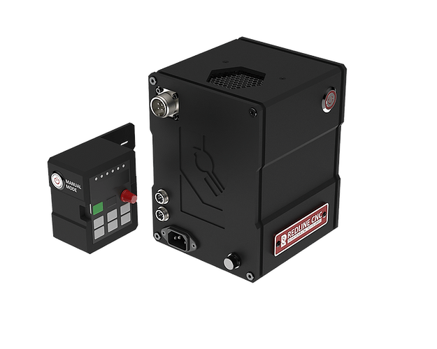

Then your 2.2 kW / 1.5 kW ratings do not mean the mechanical power delivered at the end of the shaft, like IEC 60034-1 demands. Obviously what you mean with your ratings of “1.5 kW” and “2.2 kW” is the so-called apparent electric power.
That means that the mechanical power delivered at the shaft is much lower than with real 1.5 kW or 2.2 kW spindles. What you give is the power that is drawn at the input. IEC 60034-1 requires another power rating: The mechanical power available at the shaft.
See here for example calculation. There you see that a spindle that really delivers 2.2 kW mechanical power at its shaft draws more than 3.8–4.5 kVA (and would require a 22 A fuse at 220 V)
In the example linked above, I show that a chinese spindle manufacturer does the same: Offering with power consumption, not power delivery. Like the Makita, where they give the hp that it consumes, not that it delivers, like explained here

Now with the latest info from Onefinity I should be fine running it on my 230V (if I plug the correct power cord in the c14 port). I have a 20A fuse on the group I use for the CNC, hence the 7.5A the “2.2 kW” version draws should be no issue.
Perhaps someone from Onefinity could confirm this for EU buyers?

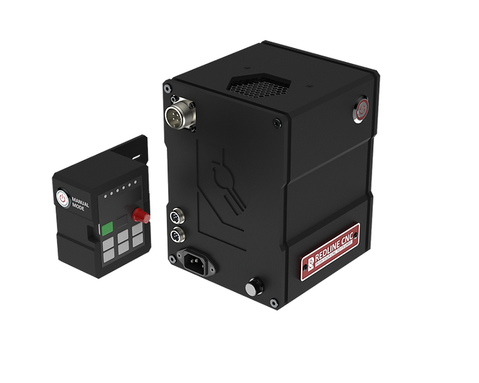

you may watch this video, at this moment the sockets of the VFD are shown:
The model 220 V “2.2 kW” should be this one

What is the size of the VFD box and what is the cable length to the spindle?
I’m trying to figure out if it will fit under my custom table.
Be nice to know more about the spindle and VFD, is it just a HY VFD in a metal box and same for spindle or something completely different.

What type of plug for the 2.2k
I think we will find appropriate cable with good plug :wink: take a look at the socket on behind very bottom of the VFD case. Are you have this plug in mind?
In my case I need this one: https://media.startech.com/cms/products/gallery_large/713e-3m-power-cord.main.jpg
