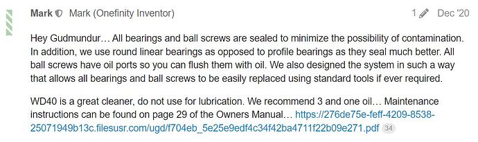

Here’s an excerpt from Mark a year ago on lube and maintenance.
Read it all but pay attention to the last paragraph.
