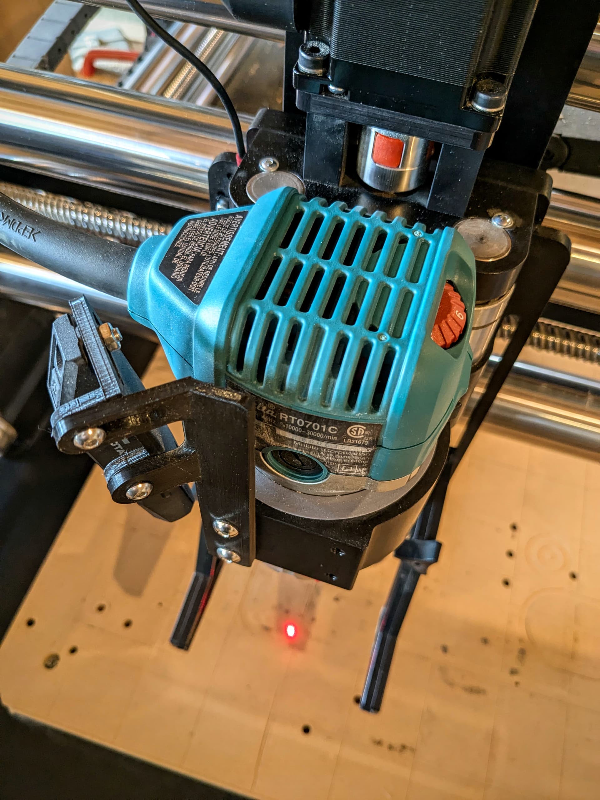

Mine is a bit unconventional, but works for me. I just used a laser made for rifles and knocked up an adjustable 3d printed mount. Note that this is offset from the collet and angled, so it is only accurate with the Z at its top limit, but that’s where the dry run moves it anyway. I aimed it in that position so I don’t have to deal with offsets in the controller. X,Y are actual values so I’m able to use the entire capacity in dry run mode.
This is the laser I’m using:
It works well and I’ve only needed to charge it once in the past year.
