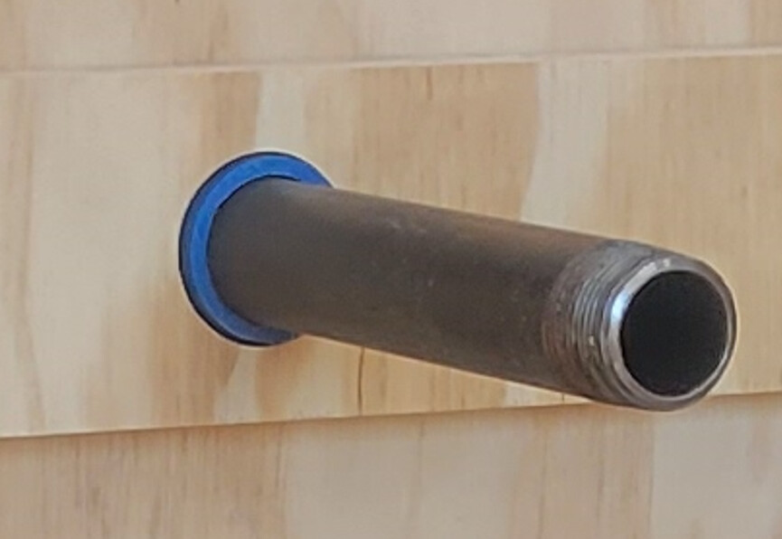

how much did you end up offsetting the pivot point from center? and what did you end up using as “bushings” for the iron pipe to rotate in? I note the Fisher just says " I found some plastic things at the home store"…I haven’t found those yet - wondered if you might have identified something more specific?
Thanks for the very thorough details of your built. It is very helpful!
I used some PVC pipe couplings when I built mine (but for a Jman). I did find the same fittings Drew used in my local ACE hardware store with some pool fittings. The PVC has been working fine, no issue.
the offset i used was 3.5" from the edge, 2" down from the top was to offset my torsion box thickness so it was flush. your milage will vary.
the ‘bushing’ i used is what Jim also referenced. i believe it was this one linked below and works very well.

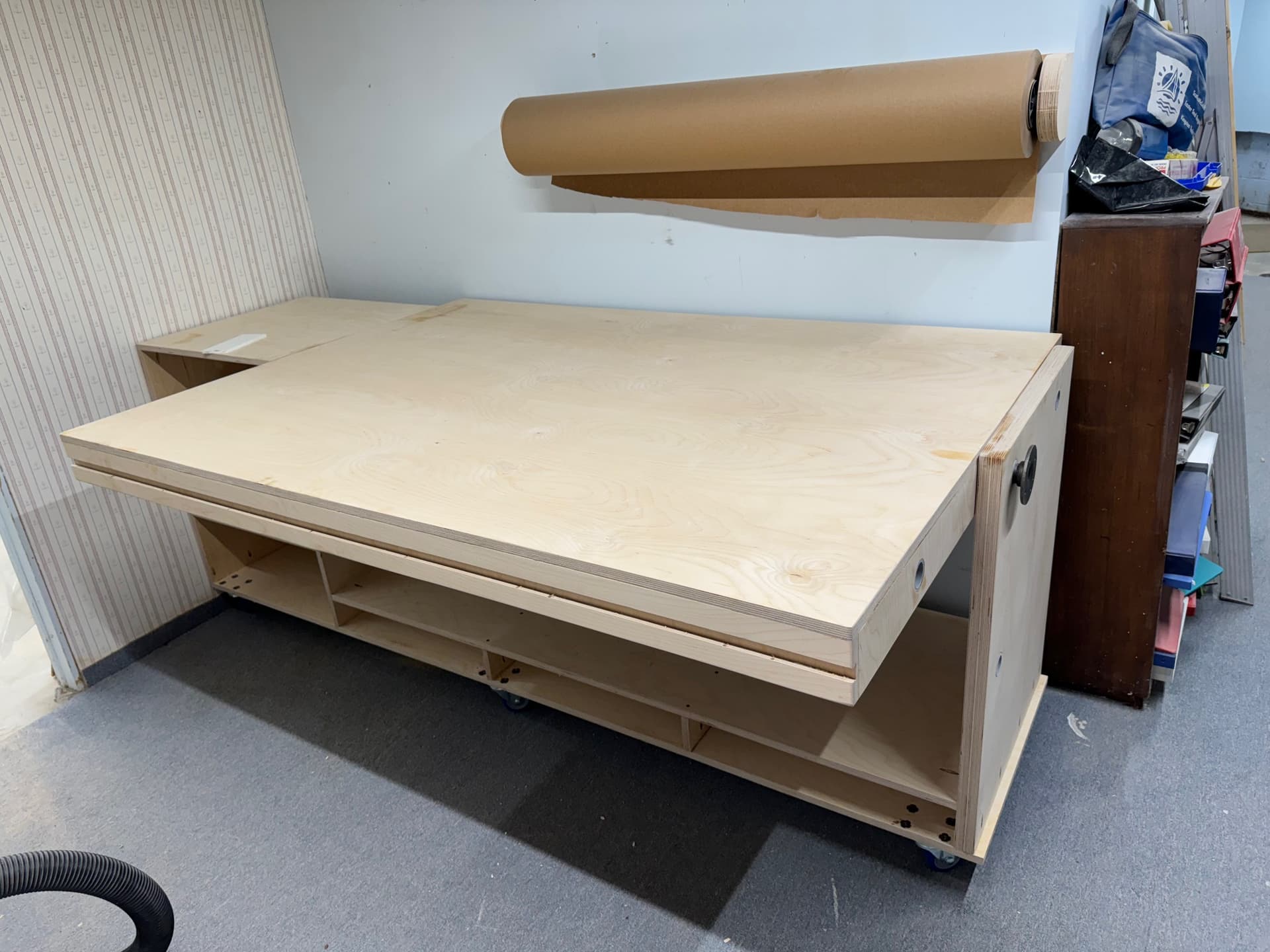

I used Fisher’s table as a starting point for my Elite Journeyman. A few adjustments had to be made.
  1. Fisher’s design is for a Woodworker machine. I changed the table size to 70 1/2 by 48. However, this is wider than it needed to be (but only by a few inches). I also increased the thickness of the torsion spacers to 3 3/4 inch.
  2. Given the size of the table, using a continuous 1 inch pipe as the pivot seemed like a good idea.
  3. Given the height of the Z gantry and the stiffy, I moved the axis (i.e. the pipe) to 5 inches from the back (instead of centered).
  4. Since the table was wider, the height of the cabinet and other support had be increased.
When it was completed and the journeyman installed, I was amazed how heavy this was. Getting it to rotate required considerable effort. I tried gas springs but could not find a good place to put them. An option that I did not explore is clamping the X gantry in the middle of the table.
Good Luck
That’s what surprised me too - it’s very heavy. But I left my pivot centered. It’s easy to tilt to put it away but takes muscle to pull it “open”. I had a spare 12V DC winch from HF, attached it to the lower frame, ran the cable up to a D-ring I screwed into the torsion box and use the winch remote to pull it down.
BTW, I also added a locking pin to keep it in the flipped up position. I just ran a steel rod through the frame end opposite the cabinets (drawers in my case) and into a corresponding hole in the side of the torsion box. With the rod in place it won’t continue rotating if I take the winch cable off.

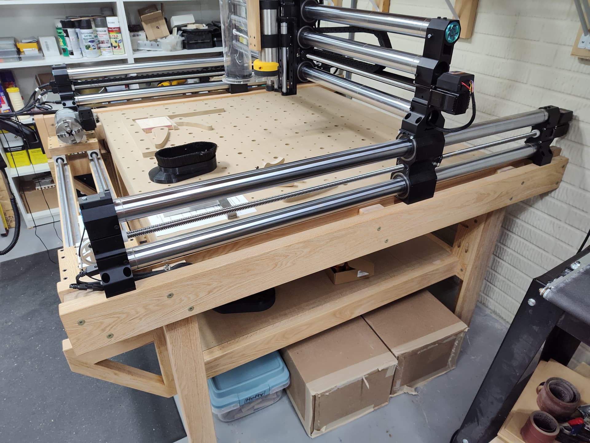

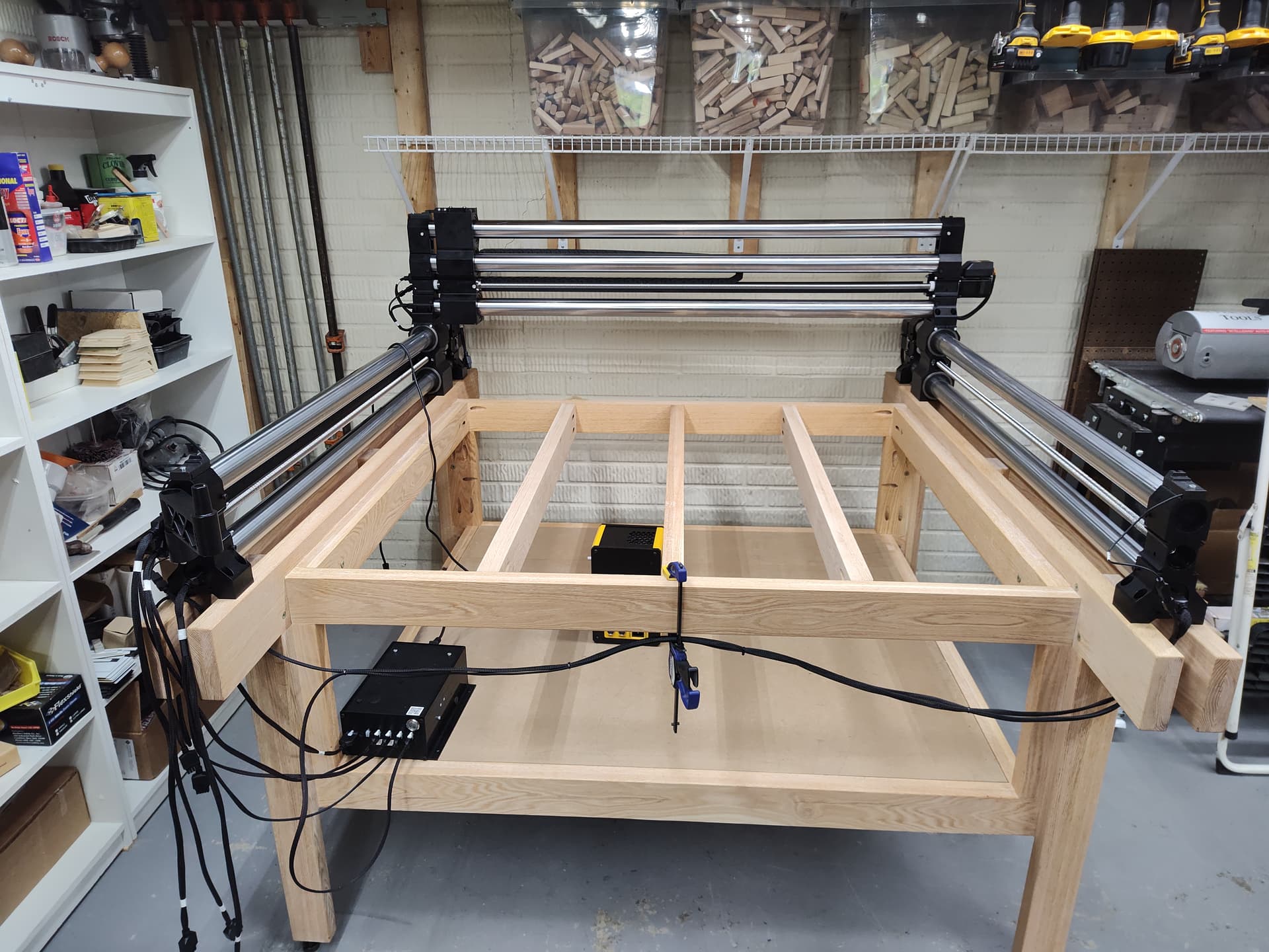

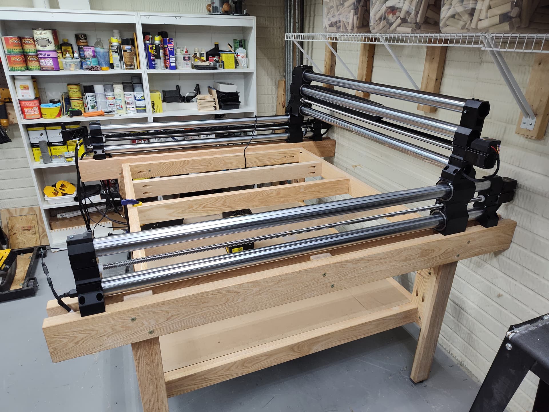

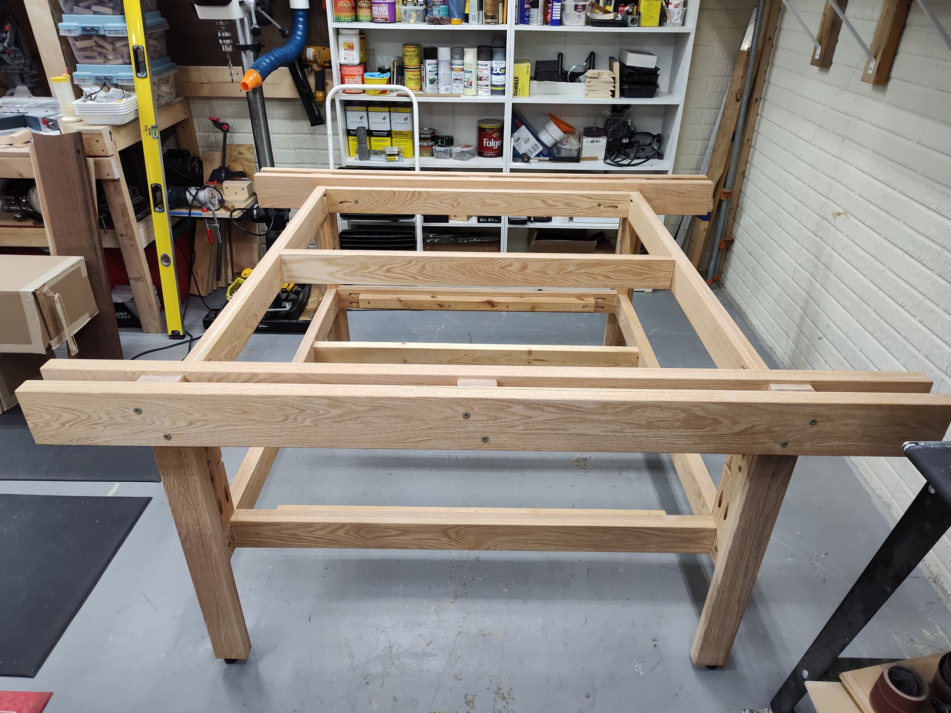

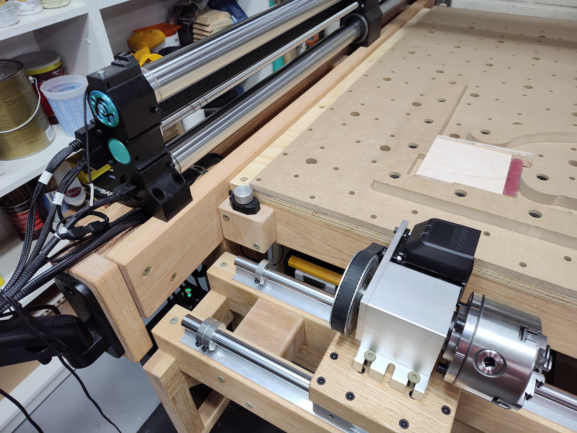

A few pics from the start of my build process…
It’s all made from 4/4 oak laminated to 8/4 for stability, which is likely a bit overkill, but I had several hundred board feet in the shop left over from another project. So, I figured what the heck, at least it’ll be heavy and stiff.
Some more pics from a few days later with the Y rails mounted, and then the X rail.

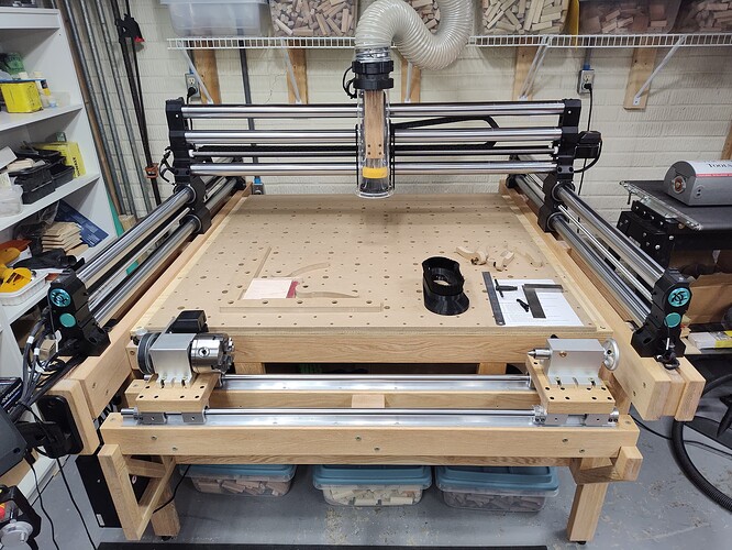

And now basically finished.
A few basic carve projects done and the 4th axis in place (though not wired yet).

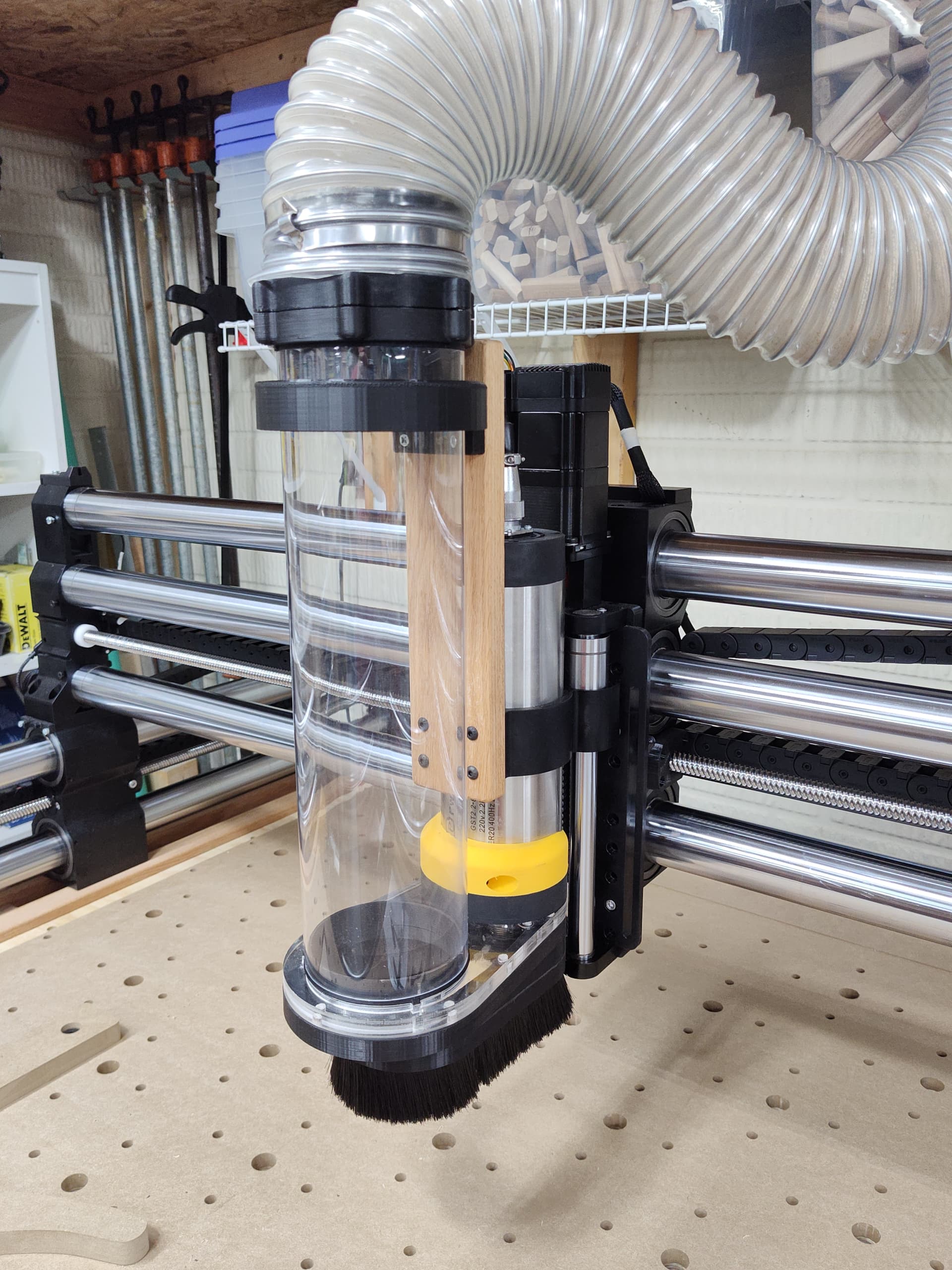

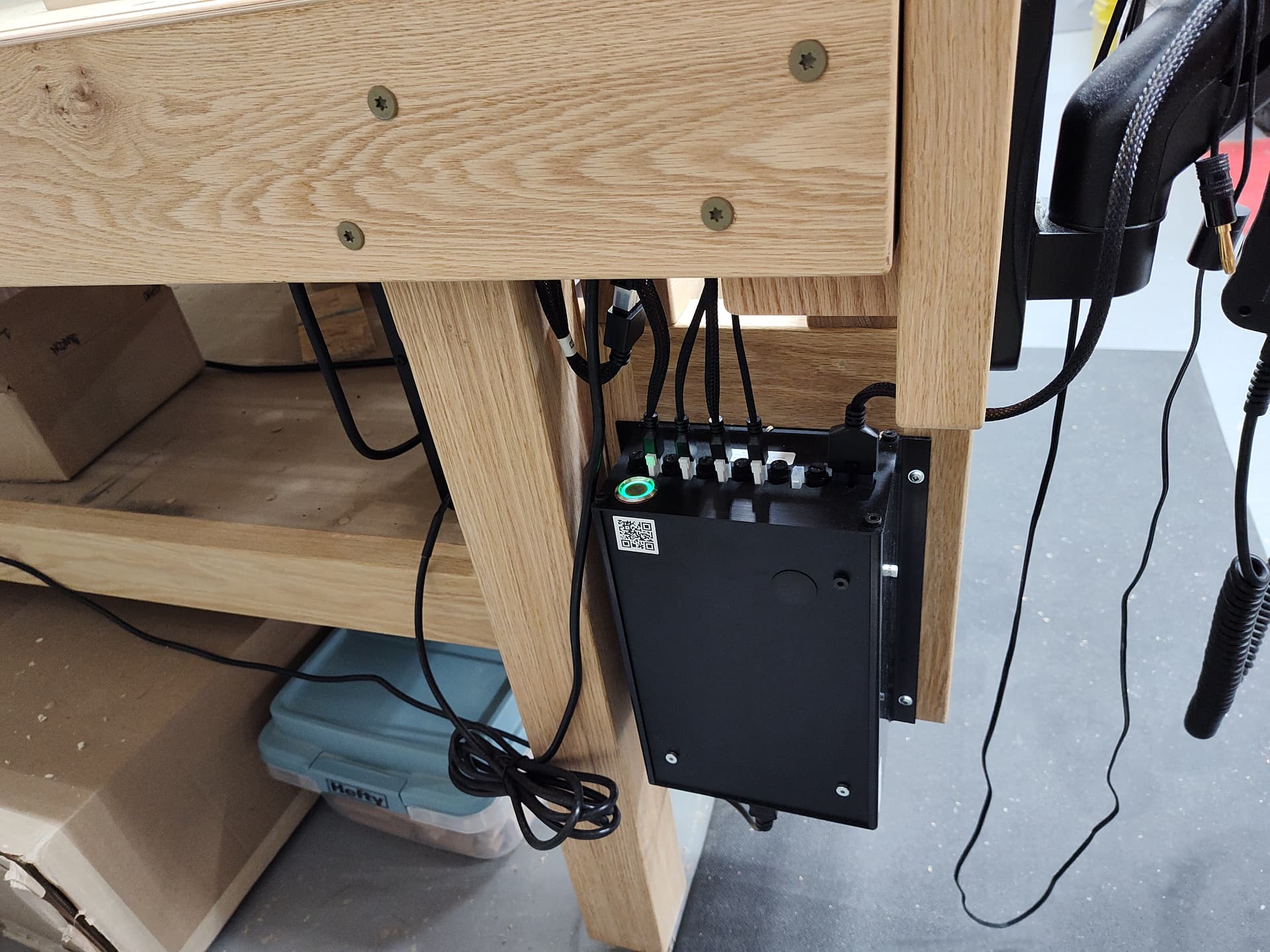

Overall, I love this machine, but I think the Masso controller mounting arm is pretty lame. I found an articulated monitor arm on amazon for about $35 and it’s MUCH better. The controller is completely out of the way for homing, etc., even with the dust boot installed.
One consequence of the longer arm was needing to mount the power supply high up on the left side of the table, so that most of the cables would reach. I did have to make an extension for the B cable. With the cutout for the 4th axis, there was just no way it would reach.

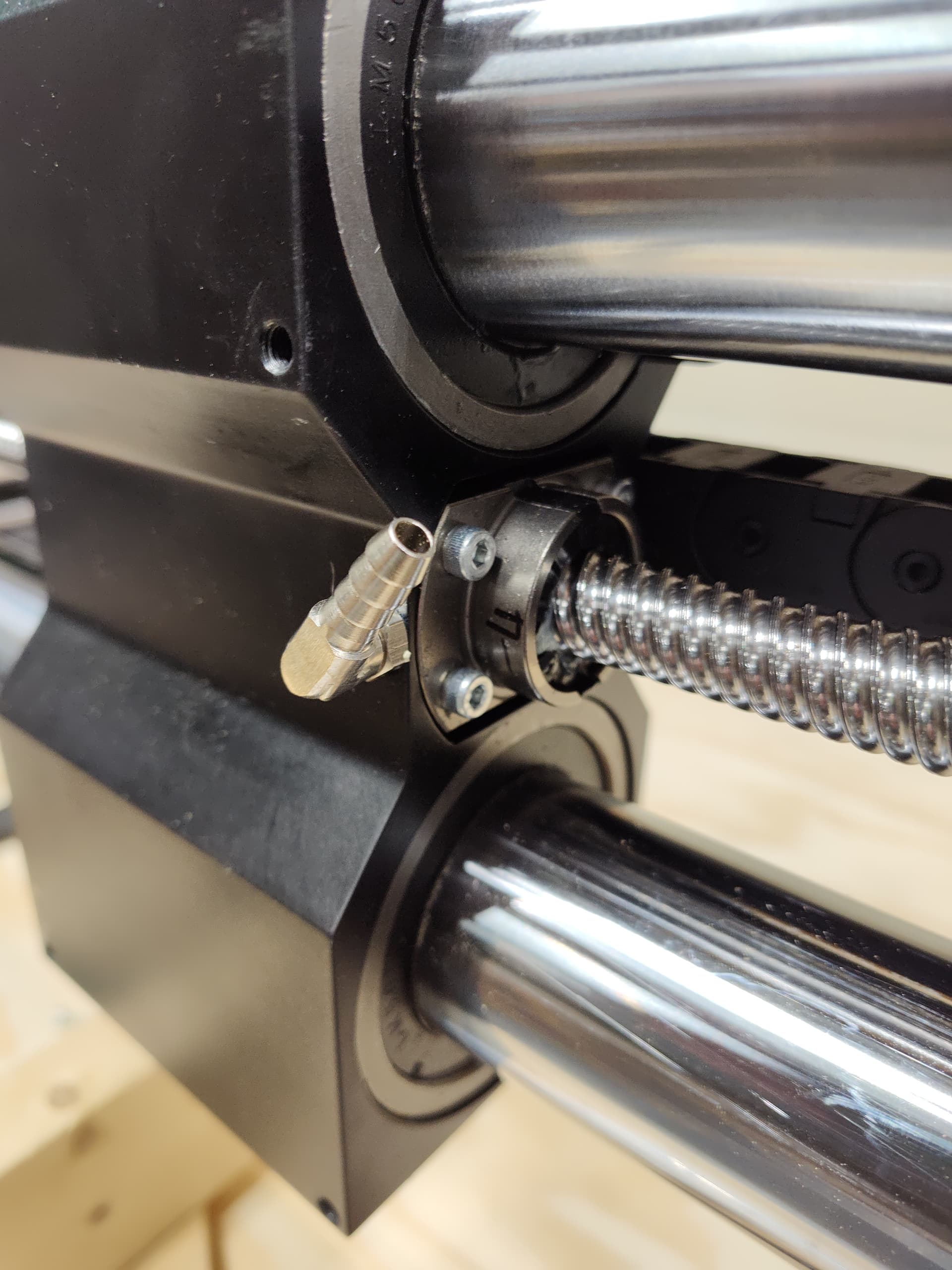

I added a right angle fitting to the X axis oil port so that I can add oil via the port without removing the Z axis.

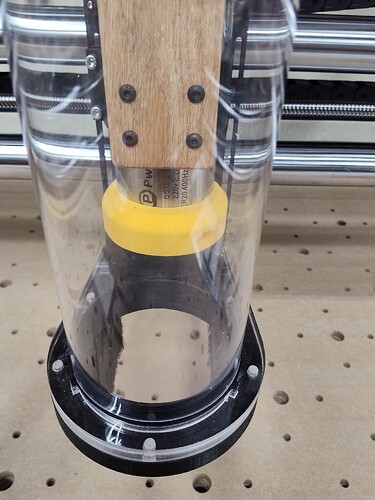

When using a stock dust boot, the hose kept catching on the Z stepper, maybe because the braking stepper is taller, but not sure. So, I added a polycarbonate tube to raise the flexible portion above the Z stepper. As a bonus, this enables me to see the carving area. I was curious if it would get scratched / less clear from the chips, but so far it’s held up well.

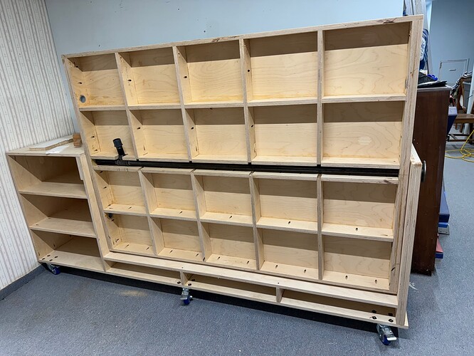

I’ve ended up with a 68" X 48" flip type top. Think I went overkill with the cabinet end. It is basically 24" wide and 24" deep - will make for some spacious drawers, but makes the whole thing 8’ long and I agree with others…it’s a brute!
