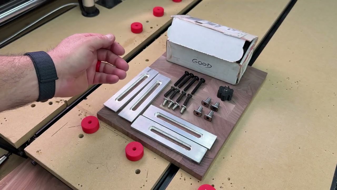

All of this is good advice but hey left out one important fact IDC woodcraft will replace bit you break for free no questions asked. At least that is what they say I would look into that. but do not buy a set buy what you need as you need them, and yes multiples because as stated here many time you will break some. the multiples are just so you don’t have to wait for the replacement to arrive LOL. and as an unashamed self promotion you can avoid many bit breaking crashes by using these clamps. Instead of the towering metal monsters some folks still use.
Hilljack Clamps
