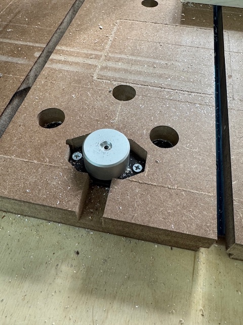

I definitely need to hold off on the ATC. I just tried using the tool setter for the first time last week and this is the result. :joy: :sob:
The spindle should not be turning when it touches the tool setter
It wasn’t at first.
  1. Homed the machine to confirm machine x/y coordinates were 0/0.
  2. Jogged the machine to tool setter and wrote down absolute coordinates.
  3. Went to F1 screen to setup the tool.
  4. Homed the machine again (2nd time). Correct bit was already in the spindle from the last job.
  5. Used probe block to set XYZ.
  6. Homed again. Machine went home, then to setter to measure bit.
  7. Loaded toolpath.
  8. Hit Rewind/Cycle Start. Was prompted to load tool. (no change required)
  9. Hit Cycle start. Spindle went down to measure tool (setter depressed), came up, spindle started, came straight down on tool setter and proceeded to carve.
I reached out to 1F support and all they told me was that I should never change the tool unless prompted. I told them that I never changed it (even after prompted) since it was the same bit I needed from the last completed job. Anyway, I could not get an answer as to what could have gone wrong (ie. did I miss a step in the setup process). Anyway, I’m just setting the Z height manually for now. This is still just a weekend hobby for now, so not a big deal.
If anyone sees anything I missed in the steps above, any insight would be appreciated.
In step three do you mean:
Went to F1 screen to setup the tool, OR
Went to F1 screen to setup the toolsetter?
Setup instructions here:
Tool Setter Elite Masso Settings FAQ?
